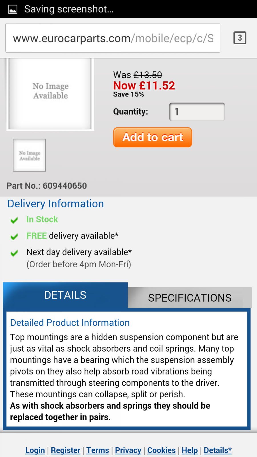

Am I correct in thinking these are what I need?
