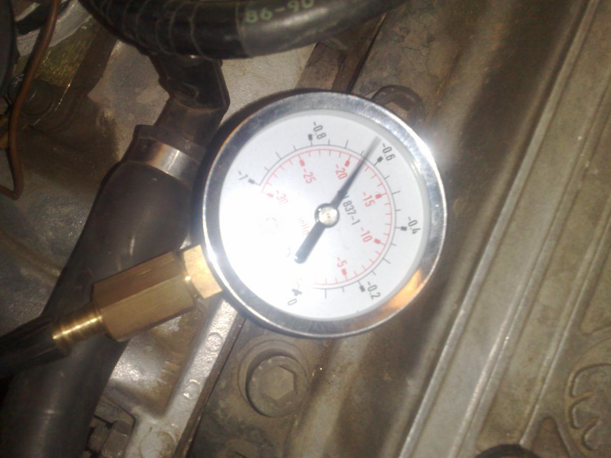

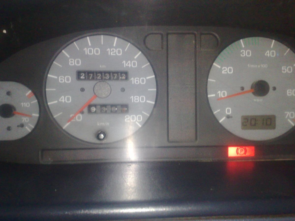

thanks a lot I bought a vacuum pressure gauge and tested the engine and carb. I attached photos of the gauge reading and the rpm and temp during the tuning. I adjusted the ignition timing and A/F ratio it seems good and according to what I read this condition is normal . I need your opinion about that. the spark gives indication of rich mixture so I cleaned them and installed them again waiting for your replay

I watched your video and I suspect your engine has low compression. It is valves related. Measure the compression please.

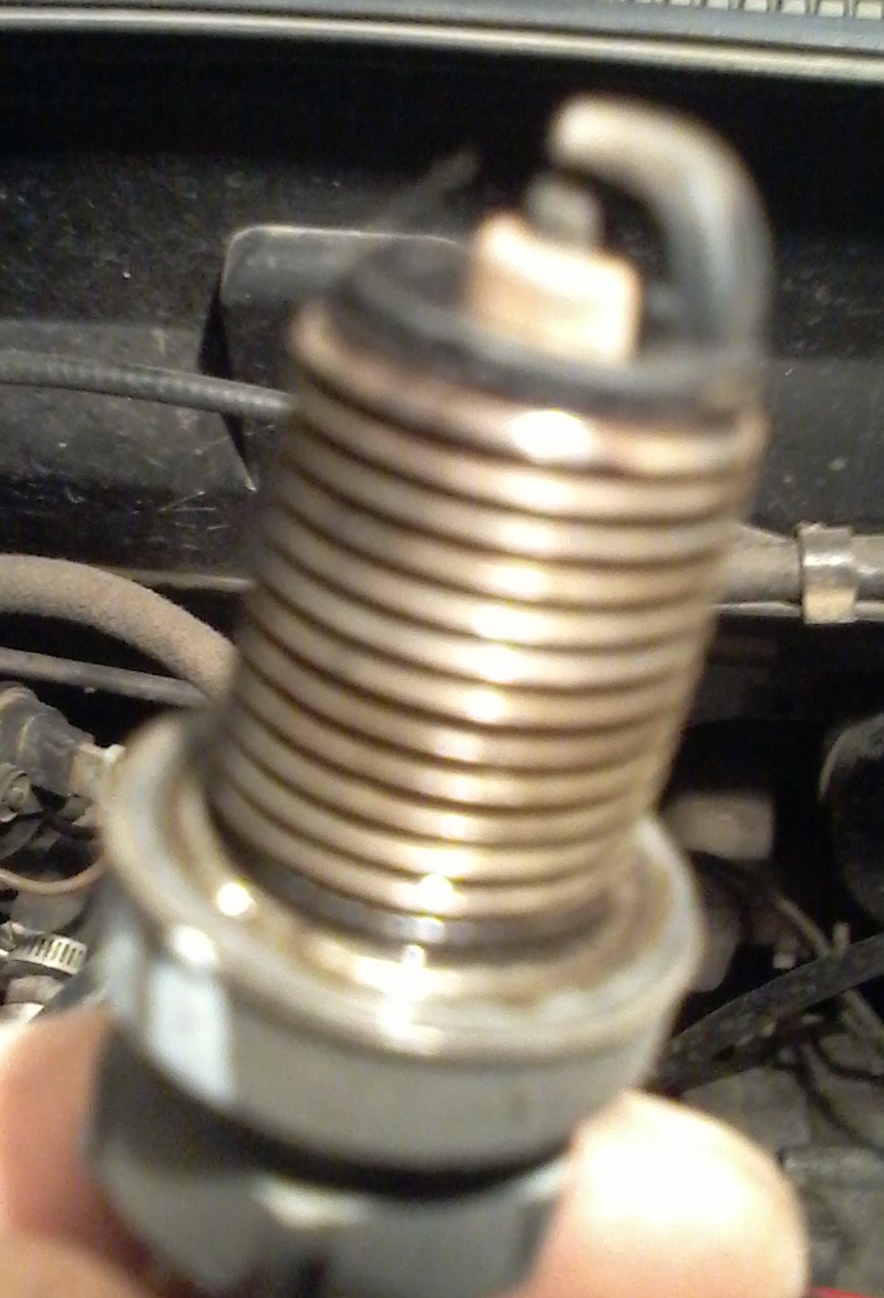

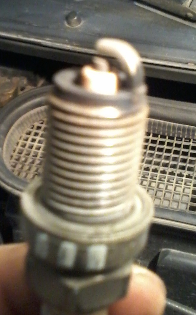

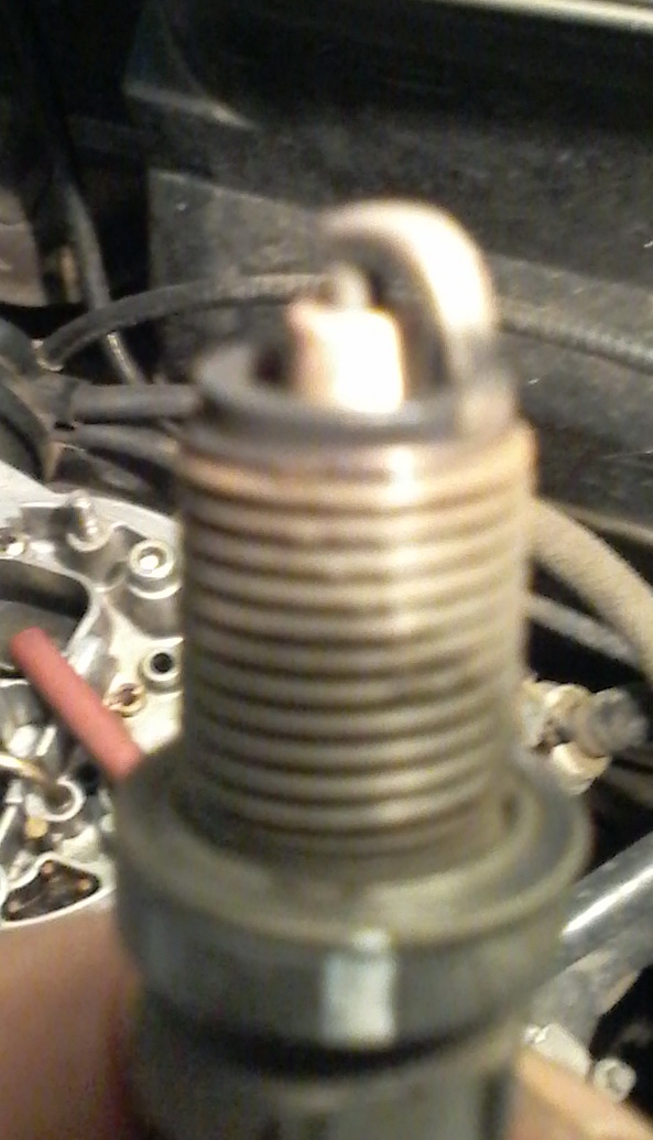

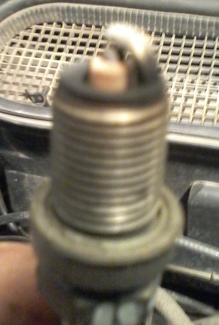

I attached a photos of the four plugs I hope they indicate something . I also readjusted the valve clearance to 0.2 for both inlet and exhaust I know it should be 0.25 for inlet and 0.2 for exhaust but I'm trying but the situation is the same do you have any idea,  also the jets are 100 for primary and 125 for secondary jets
Sadly all photos are out of focus. It helps putting a white background just behind the object you zoom into. But anyways, from what I am seeing they look very well, the ignition timing is perfect. One thing though, MPi engines are using 3-electrode spark plugs, but I presume you are not using the ignition transformer from MPi but the electronic ignition and distributor from 135 engine. So that's OK.
