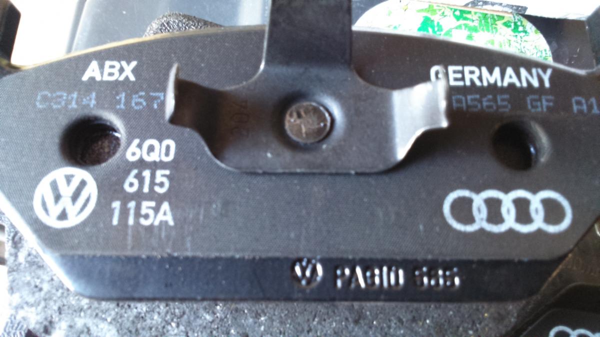

If your referring to Pagid brake pads from Eurocarparts, they're a bit more genuine than 'near as damn it', the OE ones are made by Pagid. In the attached pic you'll see the Pagid stamp on my OE ones bought yesterday from TPS :)
