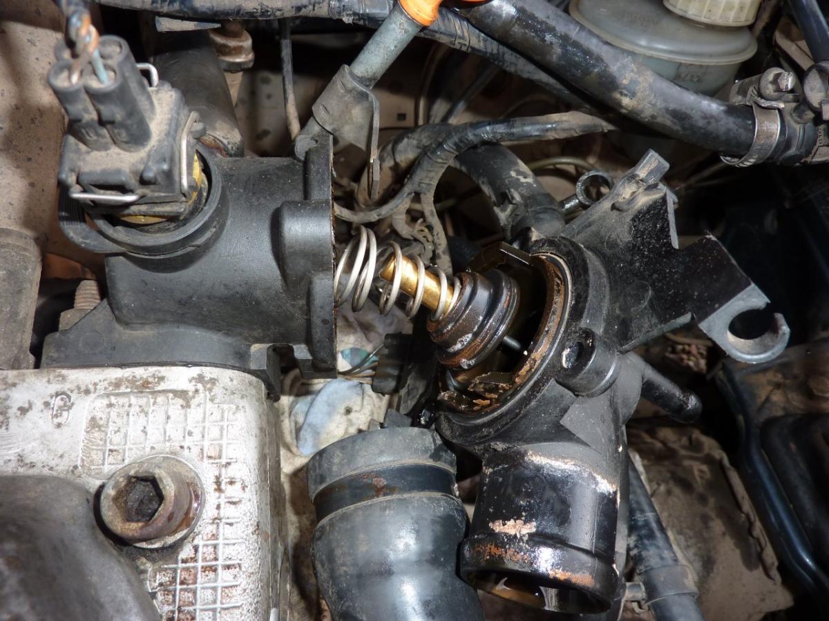

Got the old one out, its the housing that's broken so the plunger can't stay in.
Will post photos but not sure how to atm.
I guess I now have to refit the housing without the stat so I can pick up the kids and get a new one from town. That will be ok won't it?

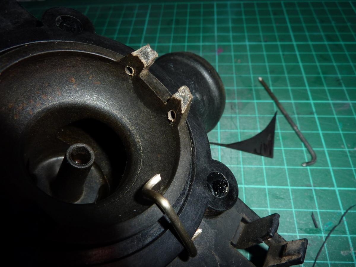

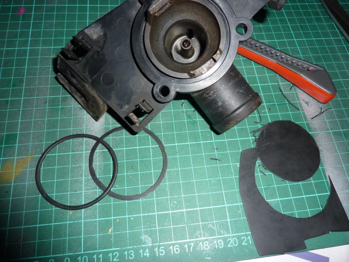

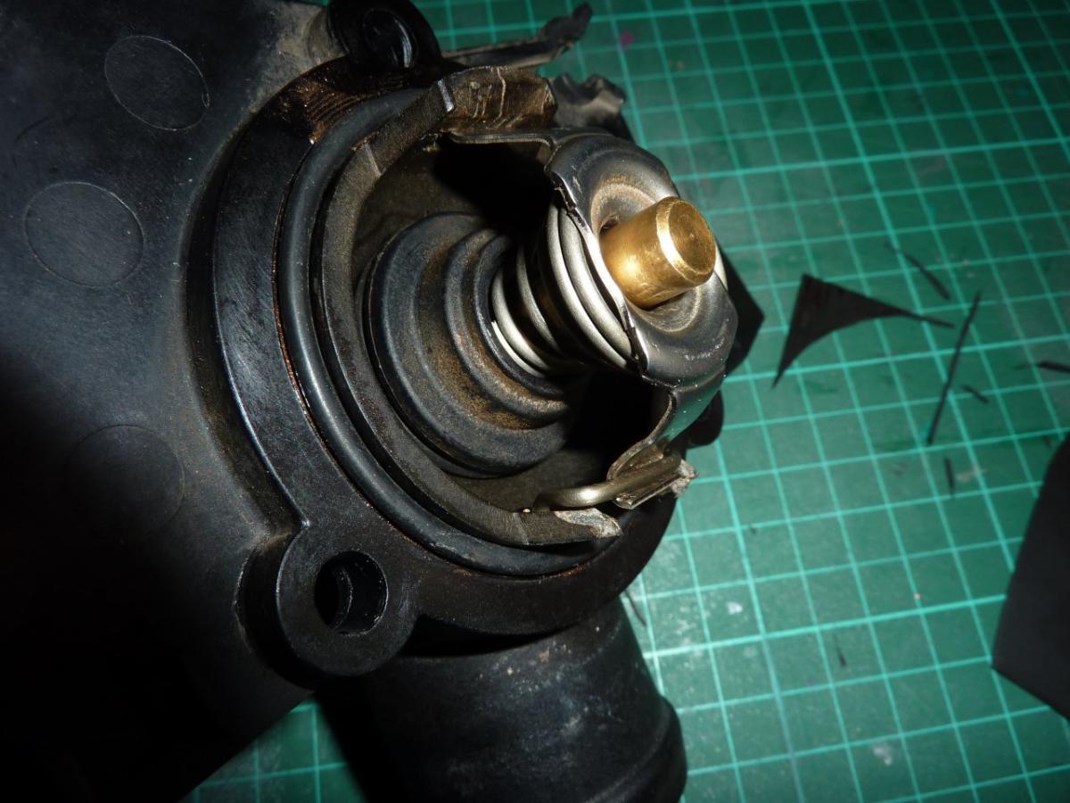

Ok here's some photos.
First - the broken thermostat as I removed the cover.
You can see fracturing on the other side too.
The plunger came out when I put it in boiling water so I decided to try and fix it, probably temporarily.
I drilled a couple of holes into the housing and bent up some 2mm stainless wire to substitute the broken plastic bit.
The O ring was squashed quite flat, so I cut an O ring packer from neoprene to go under the O ring.
Put it together and fitted it back onto the car.
Seems to work - the gauge got to about 85 degrees then the thermostat opened and the radiator hose started to get hot.
Thanks for all your help. I'm sure I'll be back soon!
