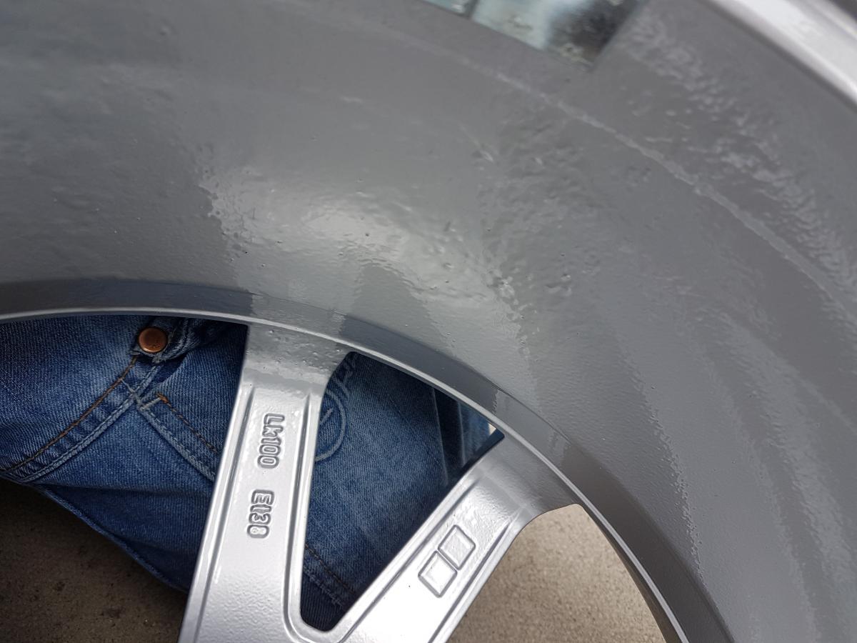

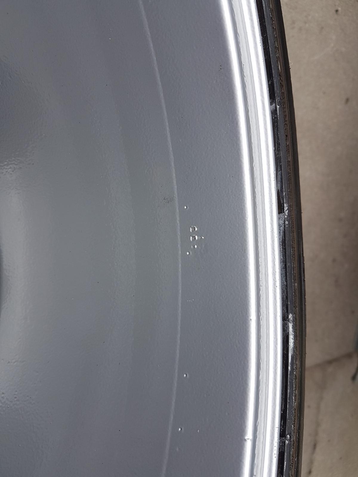

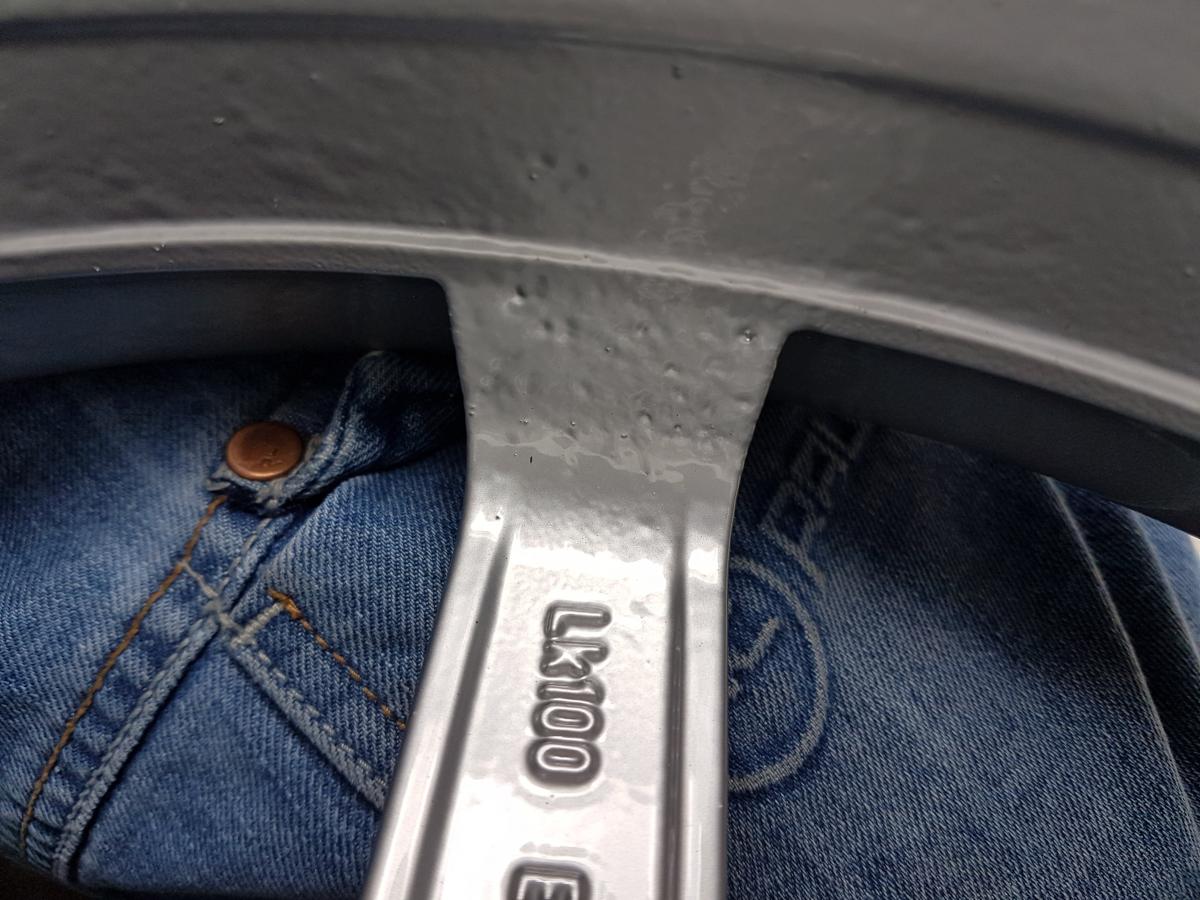

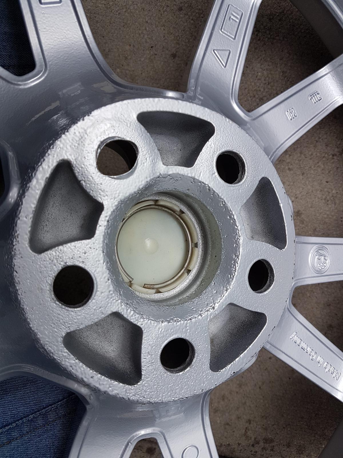

The powder coating was not amazing either, there were pits in the powder and large ripples inside the barrel son all wheels, along with a ridge on the rear of one of the wheels where too much powder was applied and had separated.

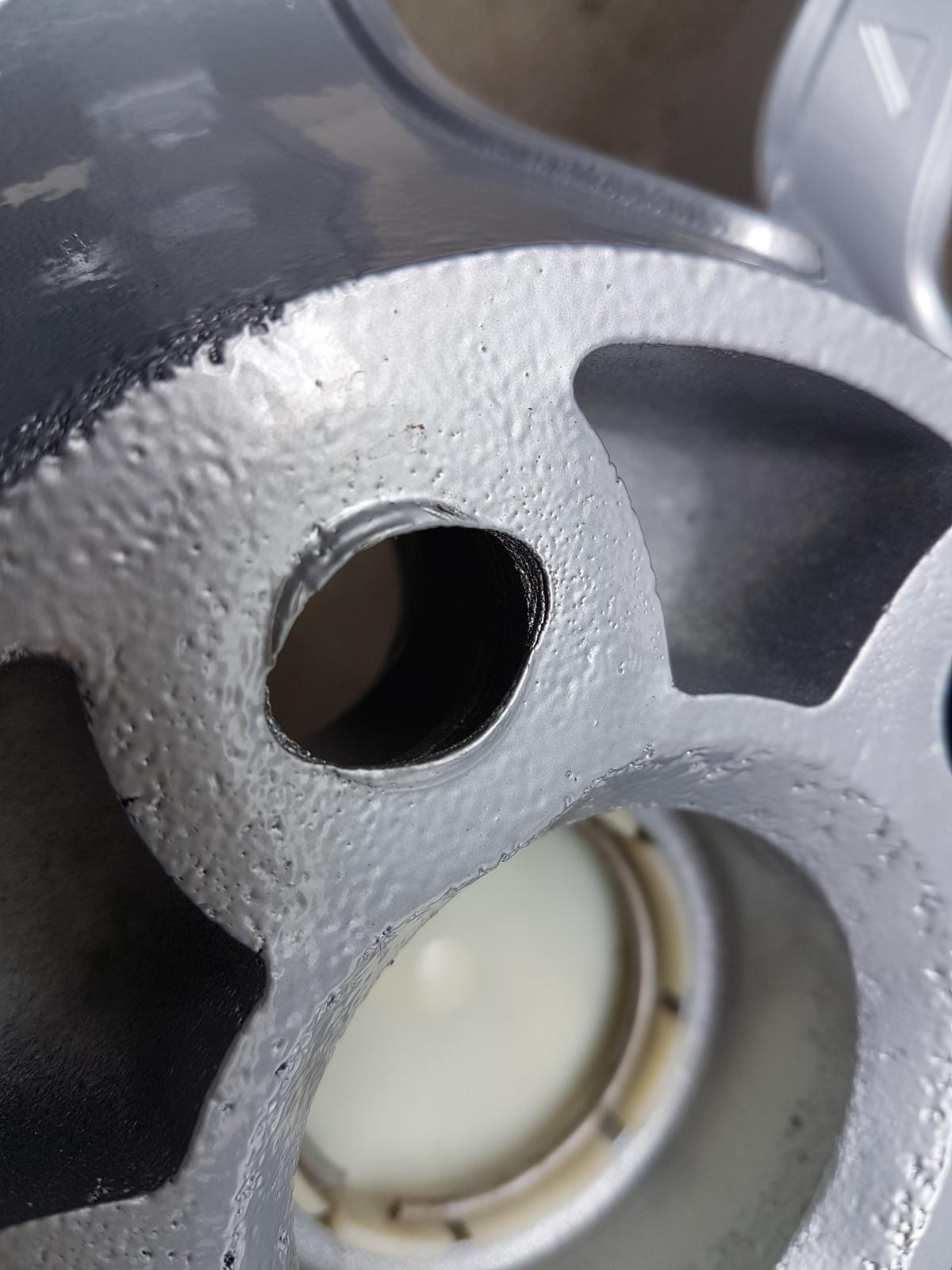

I also noticed that one of the wheel bolt holes had been totally f****d up and that the bolt was now not seating at the correct height and would just keep going down, as if the radius the bolt sits in was damaged.  Upon turning the wheel round, it was clear that this is what had happened, and that the bolt hole had somehow been pushed through the hole and out the back.
I said to the guy what had happened and was told that it had not happened here, as they hand the wheel up by the valve hole...I said it was fine before I left them with you as the wheel would now not seat on the hub due to the hole protruding out of the back of the wheel, once again he said that it would not be done here and then went on about what they do etc.... I told him I was not happy about this but all he said was basically it wasnt done here tough (did say tough but stated that nothing to do with him).

The quality is still not amazing with pitting holes in some spokes and patches inside the wheel which were not covered properly.

Wow, what a complete mess. I'd be ashamed if I had done those wheels.

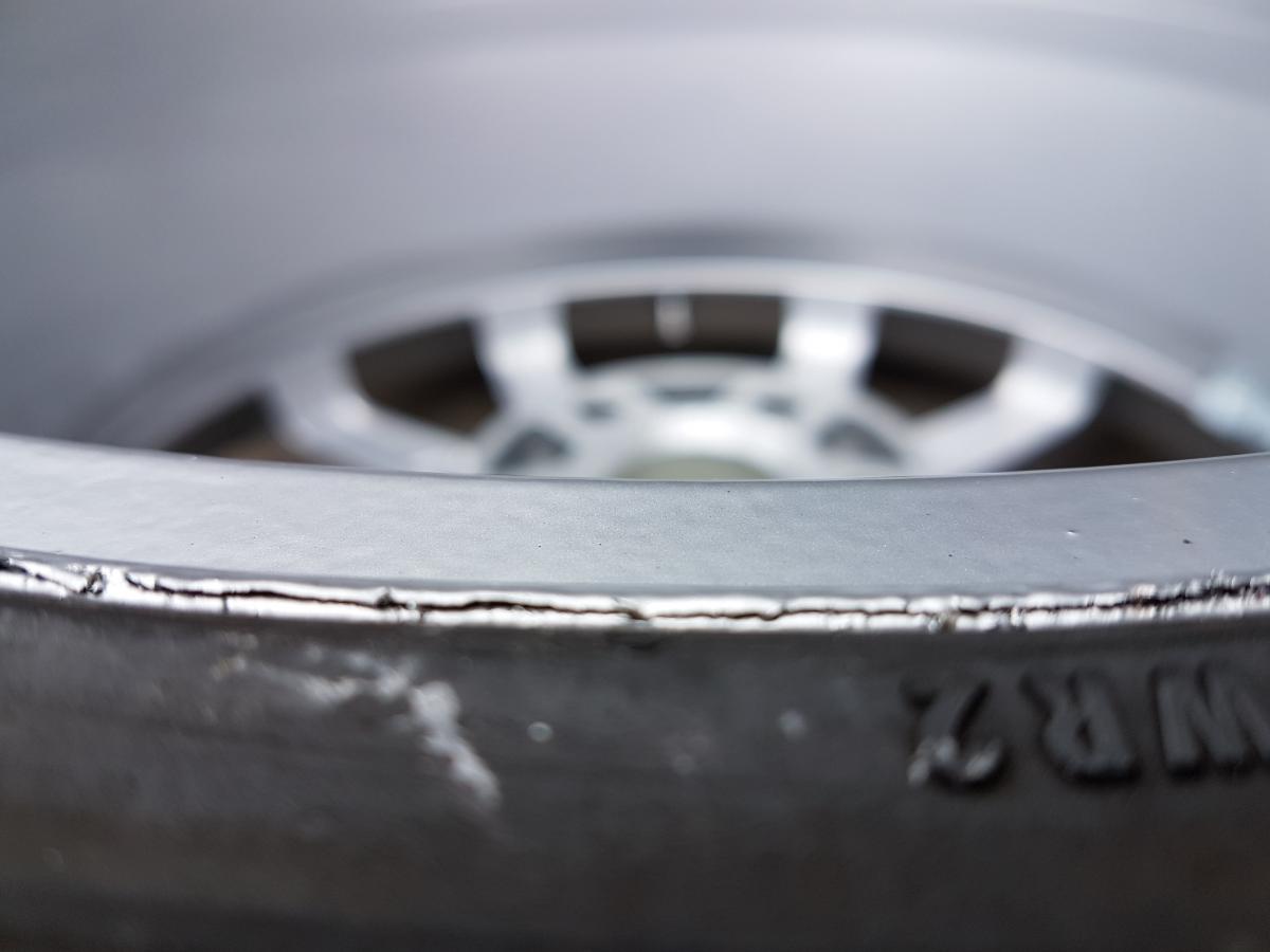

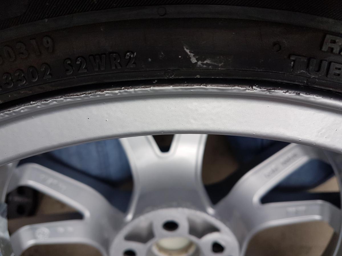

As for the Tyre, rim edge photo it looks like the tyres have been fitted when the coating was still wet.

nope, wheels were totally cool before tyres were fitted (if you mean the pic with the crack in the powder)

Managed to possibly fix the knackered bolt hole with some metal filler, filled the hole completely then pushed the bolt through until it was at the correct depth and held it there.  Left it to dry for an hour or so now and took a blowtorch to the bolt and whizzed it out with an impact driver.  Hole is pretty much perfect now, little bit of sanding to do but otherwise perfect.
