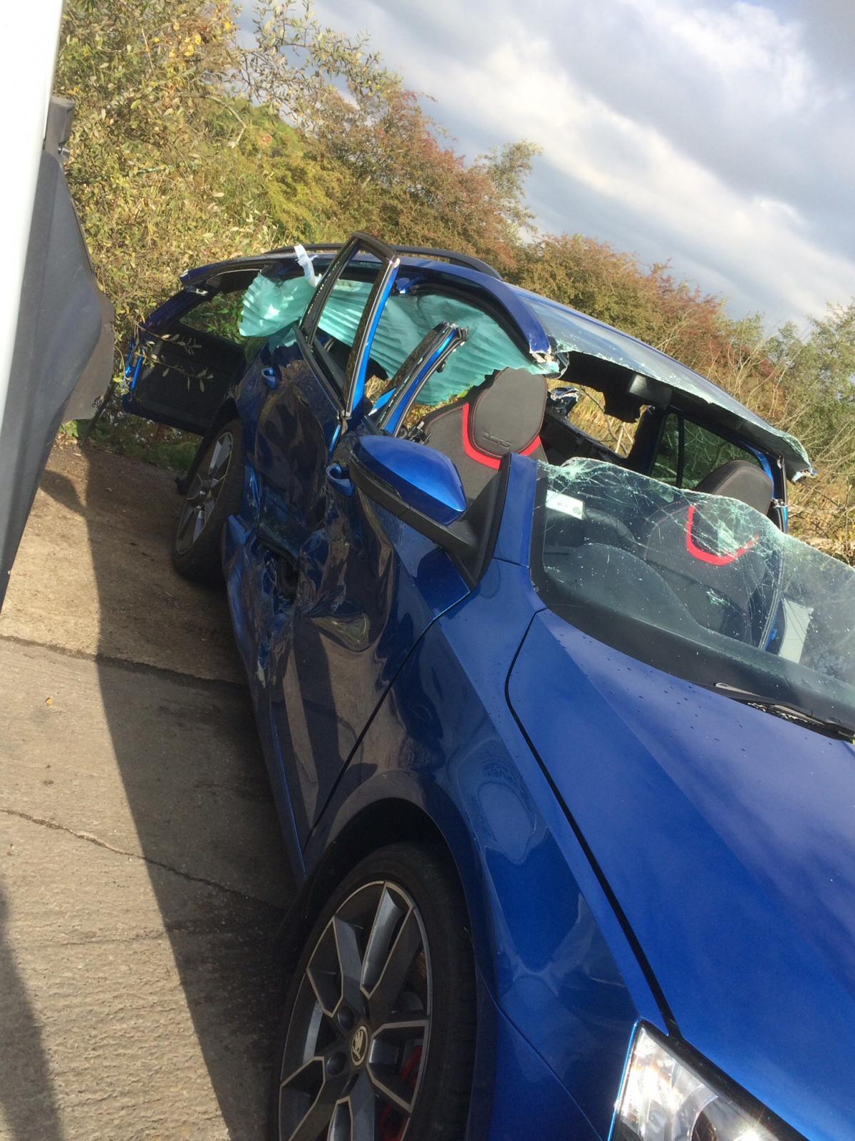

Curtain airbags deployed when I was hit at speed in the side the car was fitted with standard airbags no added ones.
Appears as if curtain airbags are also in rear not just frontpost-63978-0-12149100-1421760772_thumb.jpg
Yes, the rear side airbags protect only the area below the window line.
