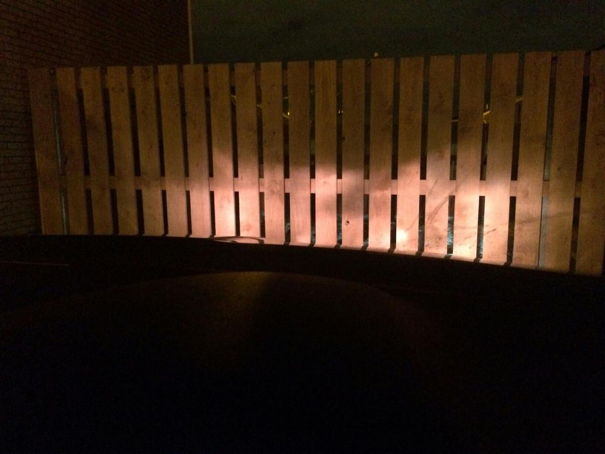

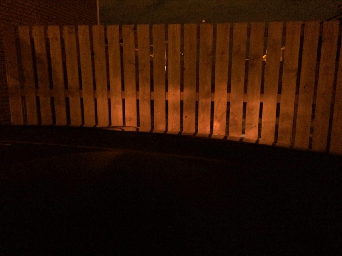

Hi,
I was wondering if there is a VCDS adaptation that adjusts how bright the side lights are? The sidelights dim when switching from DRL. Attached are photos showing the difference between the 2. I was wanting to get the sidelights the same brightness as the DRLs. I fitted HIDs and it looks like 2 torchbulbs are powering the sidelights.
Stuart

Thanks for the replies.
I don't want the sidelights on all the time. I have the standard halogen headlights, and are set to auto. When the dipped beams come on, the DRL dim and become the side lights. As you know the DRL/sidelight and main beam use one bulb. I've changed this bulb to an MTEC bulb, which is white when as a DRL, but changes to the yellowish torchbulb colour when it changes to the sidelight.
Stuart
