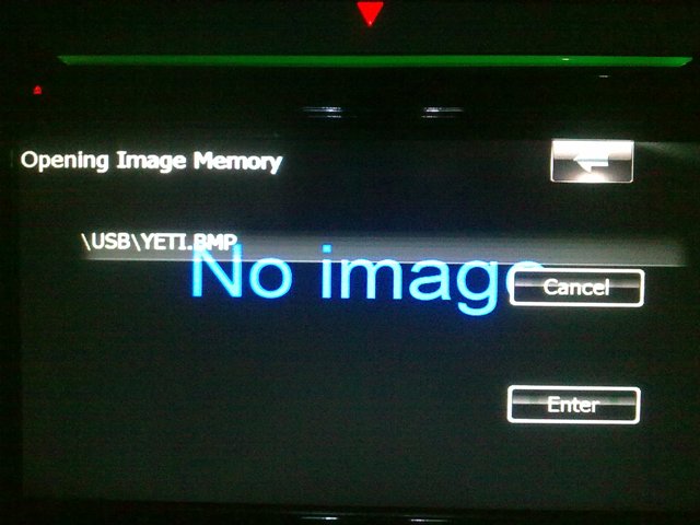

4 – after powering up, the “Opening Image Change” screen is displayed.

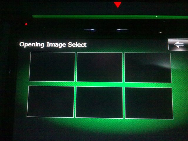

5 – Plug in your USB memory stick containing the required bitmap image and select ‘OEM Image’.
6 – as the unit can't display bitmaps in this format, the images you can select from are shown as blank boxes – select one and its file name will be displayed (“yeti.bmp” in my case). If it’s the wrong one, assuming there are more than one on the memory stick, press ‘Cancel’ and pick another. Don’t worry that “No Image” is displayed.
post-1280-0-12395900-1424107077_thumb.jpg            post-1280-0-61817200-1424107090_thumb.jpg
7 – once you’ve select the required image, press ‘Enter’ and wait until it finishes writing the image.

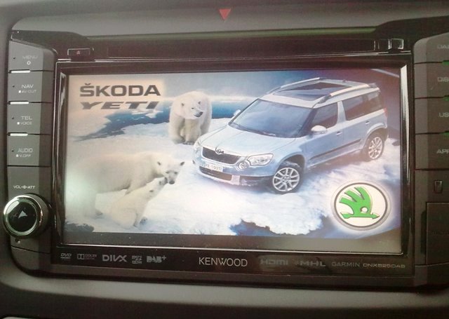

8 – press the MENU button until the unit powers off, wait a few seconds and press MENU again to turn it back on. Your new image should now be displayed instead of the original Kenwood one. This is my image - something a little different to the standard Skoda "Welcome aboard" one.

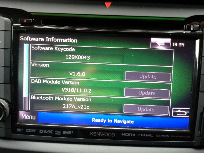

Thanks to the fact that I found information provided by you about the way of changing the starter graphic, I managed to change the picture in my Kenwood to the one I wanted to have for a long time. Unfortunately, something went wrong. I do not blame your advice absolutely :-). I had to do something wrong accidentally. Everything works, but the unit does not remember basic settings such as changing the language e.t.c. No radio stations. Each time during start up, I have to set everything again. The really strange thing is that the unit seems to have set itself in a demo version. When I  try to eject a disc from the drive, a message appears on the display informing that I can not remove the disc  because it works as the demo version. Maybe this is the main reason of  this mess... I even tried to disconnect the power for a few minutes, without any result. Any idea what I could have done wrong or accidentally changed?
Sorry to hear that your HU is stuck in demo mode  :sadsmile:
A couple of suggestions : have you tried pressing the reset button next to the volume knob?  Worth a try - both with the unit off and with it on.
Also what software is yours running?  Bear in mind that my HU is over 3 years old so newer ones may have changed.  I have updated the firmware in mine a couple of times - the photo below shows the current settings.
Hope this helps,
Andrew
Hi. Thanks for the answer. I did it according to your advice and it did not work. But it's my fault because I did it twice. Probably of and on again :biggrin:. And it was still the same problem. I just did it once. "Menu" button together with "Reset". And everything works. Thanks again. Especially for instructions on changing the start logo. Regards.
