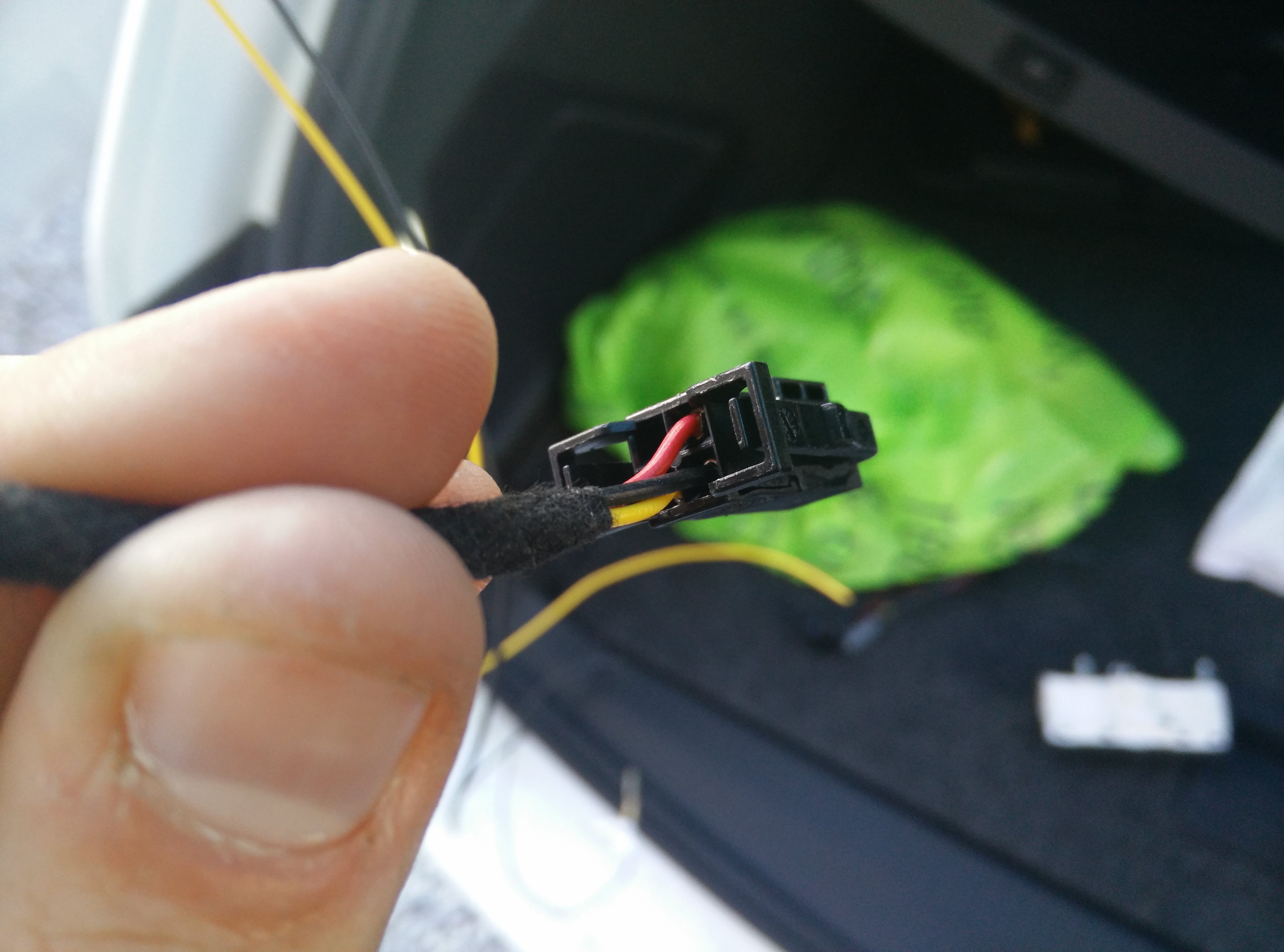

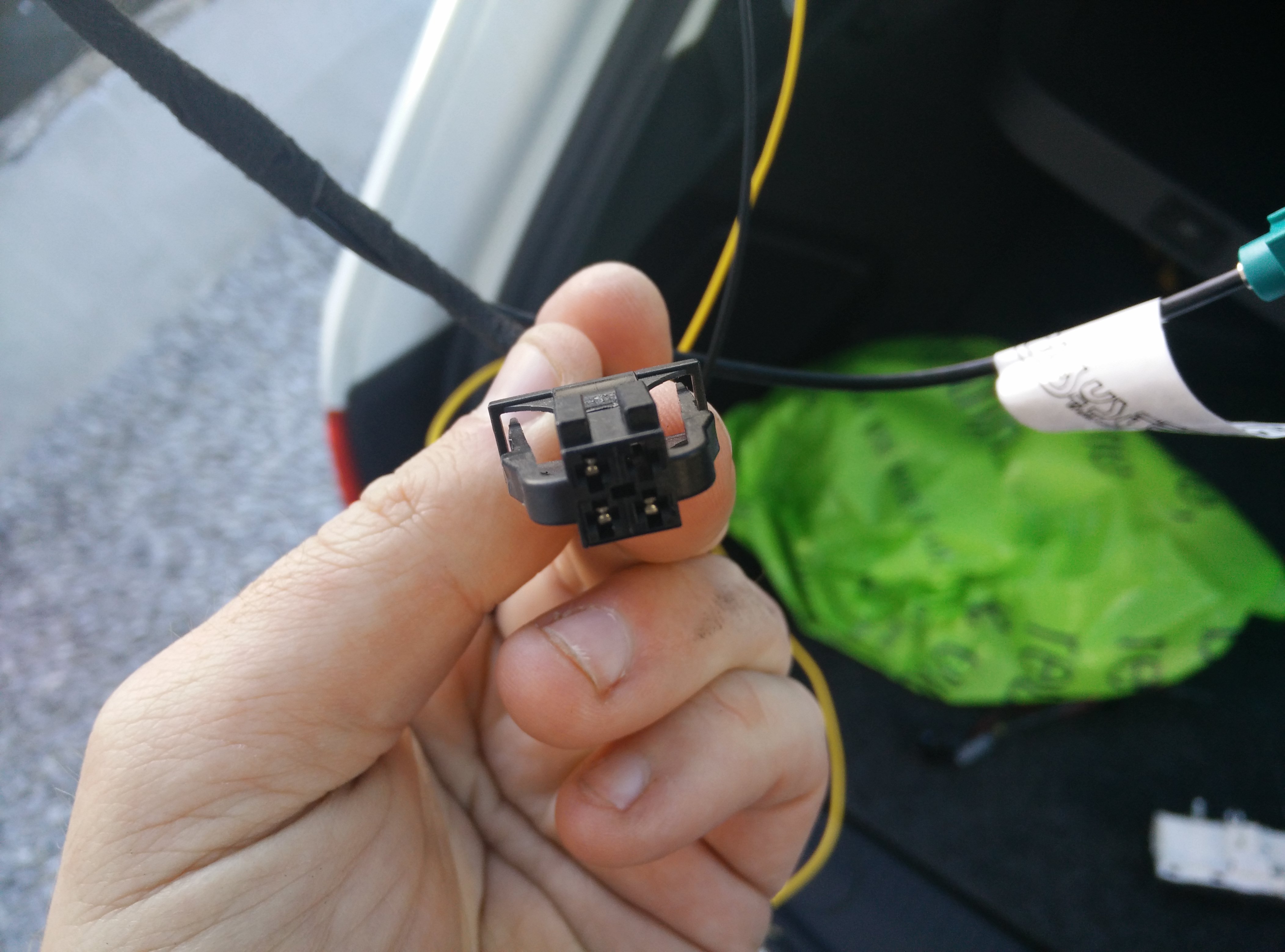

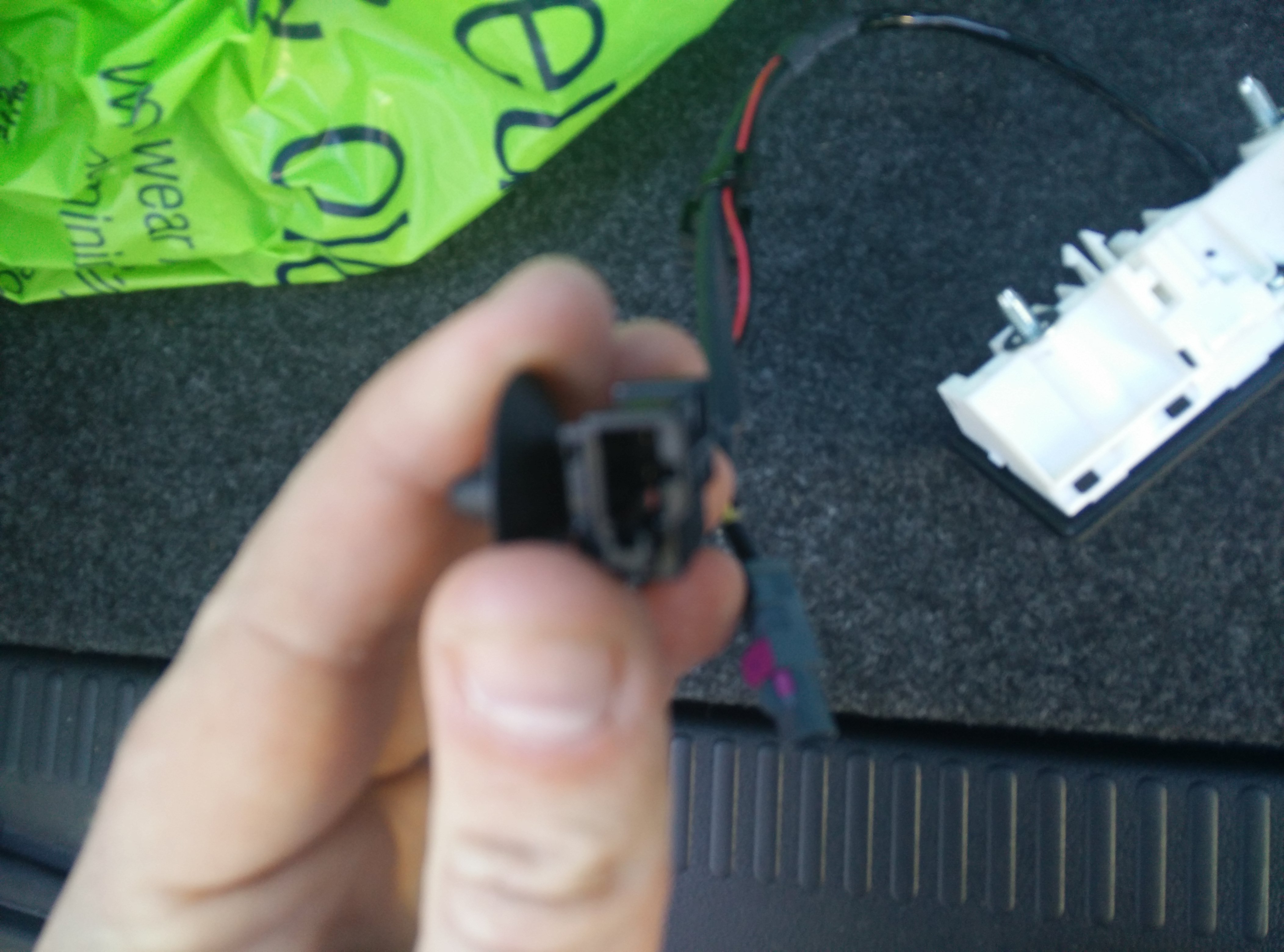

With regards to the wires it was right and wrong. The camera has two plugs on it; a video feed and a power feed. The loom also has two plugs; again video and power. The video connectors matched up and on the other end were pins to go in the connector on the unit in the glovebox so no issues there. The power was not so as the camera only requires positive and negative but the loom connector has positive, negative and reverse so the two would not mate together. I simply cut the connector off and ran the negative to the bolt securing the rear wiper to the boot and the positive to the purple/black wire that supplies 12v to the rear wiper.
You should be able to see the two different connectors in the attached pictures. The second is the connector on the camera and the other two show the loom with the additional yellow wire.
