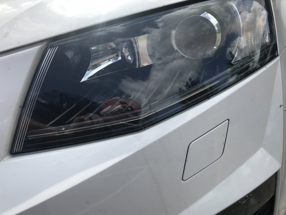

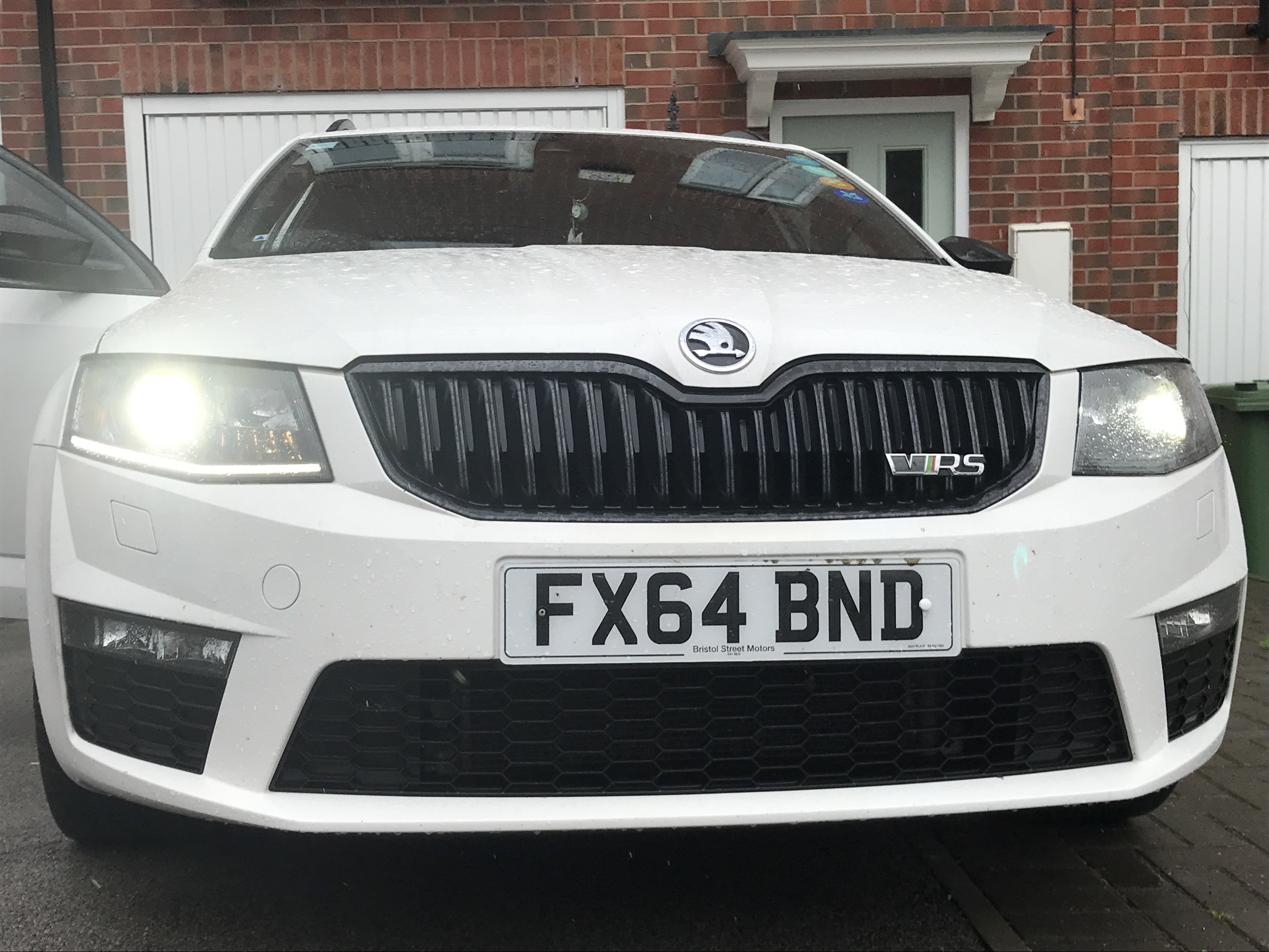

I'm having the same issue with my approved used 64 VRS estate on the nearside DRL now not working after a few days of intermittent use. I booked into my Skoda dealer where I purchased the car from and paid for a Skoda extended warranty, who have looked at it and said the module and headlight cluster need replacing at a cost (mega bucks I assume)?
They also picked up the warranty issue  with Skoda head office they have now told me its not covered under warranty but they may be able to help out as a gesture of goodwill !!! not sure what this means but obviously want some moola from me...Im not happy at all.... I had a DRL donut LED replaced free of charge on my approved used BMW a few years ago they had no quibble with replacing it....funny how major dealers resolve these issues...
what stance do I now take regarding getting this fixed as it looks odd with only one light running... I will deactivate DRL in the meantime but obviously long term would like this resolved by Skoda..
