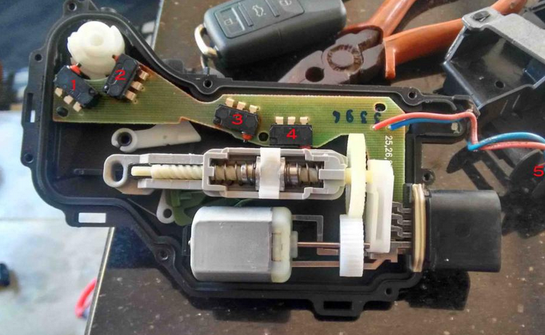

First thing I'd be inspecting would be the door bellows wires and connections at the multiplugs between body and door on both sides. It's pretty difficult to say what might be wrong with it. The solder joints on them can break down due to the shocks of opening and closing the door over the years. The electronics in the driver's unit can fail. The wiring in the door bellows can break. The little DC motor inside the lock can give problems. There are five microswitches that all have to work....
All sounds like good advice thanks! I've not done any work on the door so not sure what has caused this issue. Thanks for the link to that thread!

My doors kept locking and unlocking, randomly, for a while and then the passenger door wouldn't open except on rare occasions. A replacement mechanism from Ebay cost £13.75* and works perfectly, no more random behaviour over the year since it was fitted.
