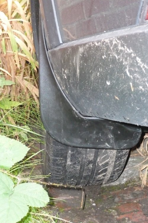

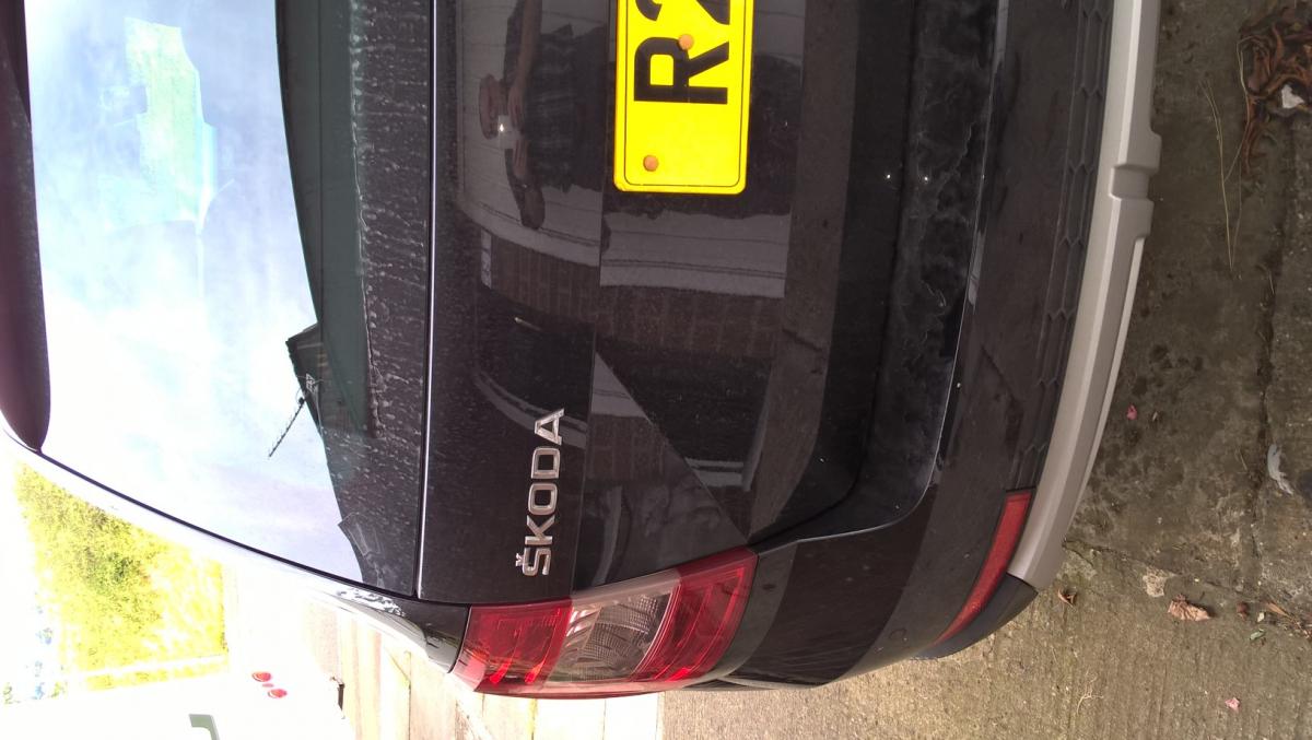

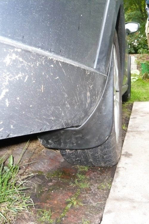

A Norwegian winter is on its way and the only thing I feel is missing on my O3 Scout is mud flaps. Does anybody know if there are any after market alternatives?
I fitted genuine Skoda mudflaps to my 03 Scout, they do "fit" but they need to be fitted further out than on a non scout car so extra holes are needed in the flaps.
However the car STILL get crud up the sides of the bumper and the tailgate also gets covered in crud, so the mud flaps are not very effective!

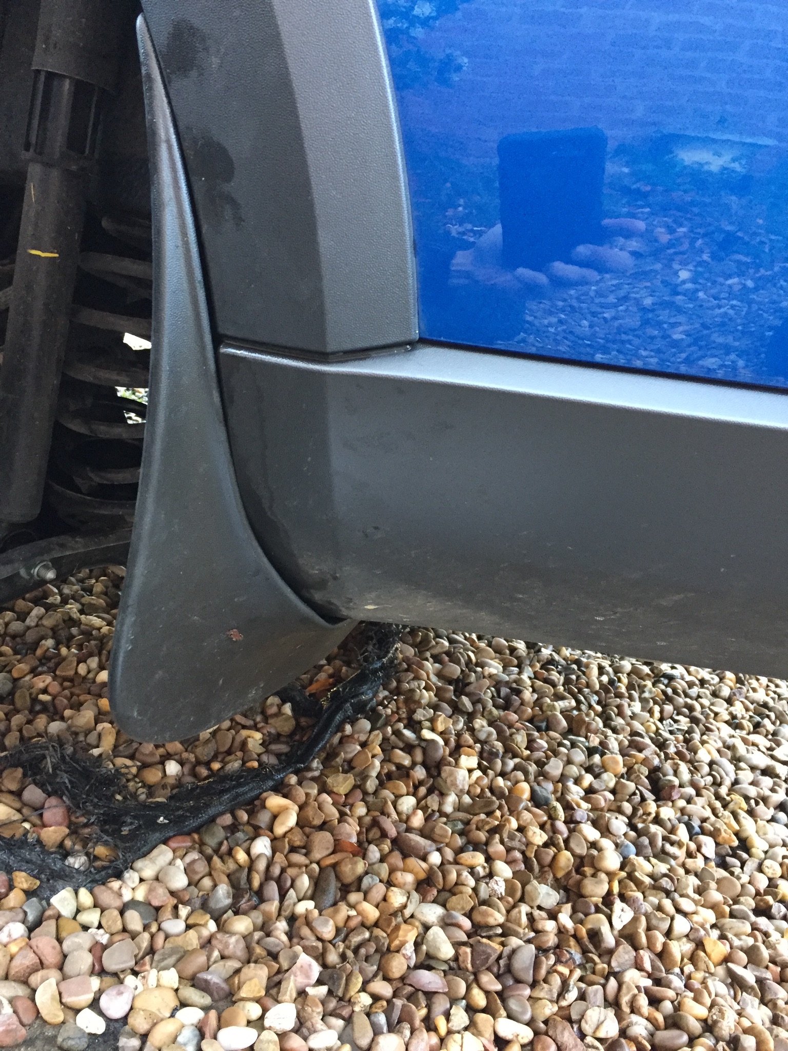

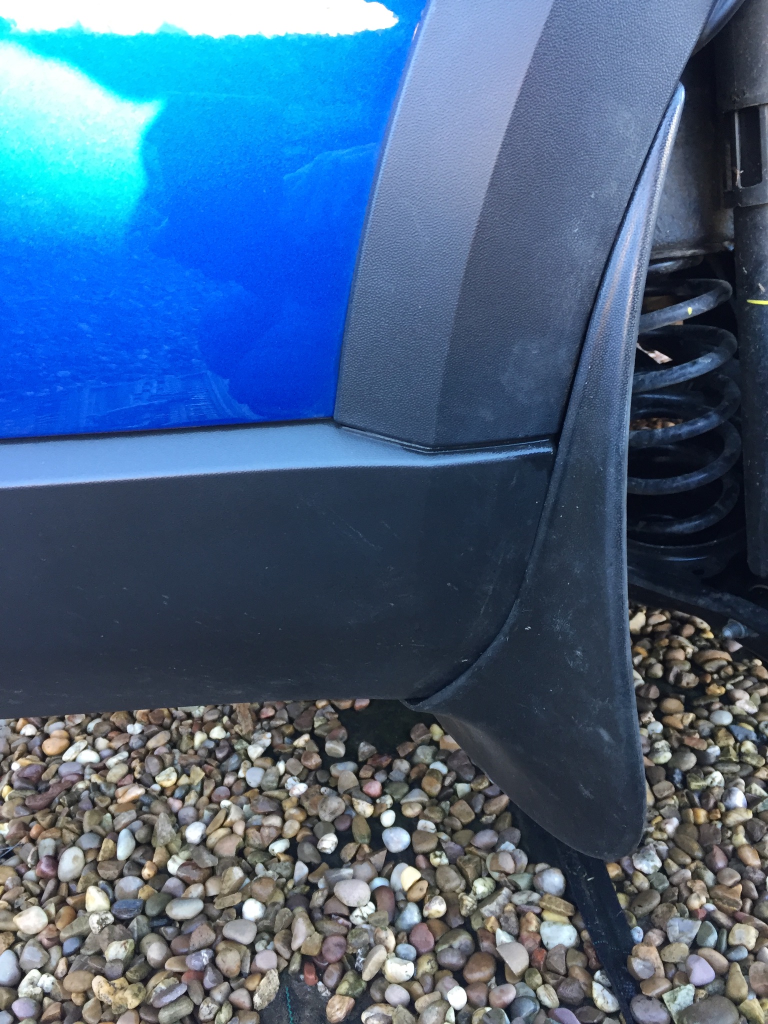

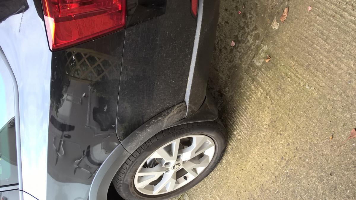

Octavia M3 FL Scout here and I was able to fit the normal Octavia mudflaps. They do need some small modifications and some holes drilling in the mudflap due to the Scout body trim. It’s not a perfect fit as a result, but you don’t really notice once they are on.
Thanks for the response which is encouraging. My race blue scout is fitted with park assist so it has a sensors all round, including in the rear wheel arch close to where the mudflap would fit. Can you measure the distance from the join of the rear wheel arch moulding and the lower cladding, to the top of your mudflap. This would check whether the mudflap will be too close to the sensor. I really want to fit rear mudflaps to cut down on the stones and mud thrown from the rear wheels onto the front of my caravan when towing.
I live in Worcester which is not too far from you. In 2 years of Scout ownership I've only ever seen another race blue scout so this appears to be a rare combination!
