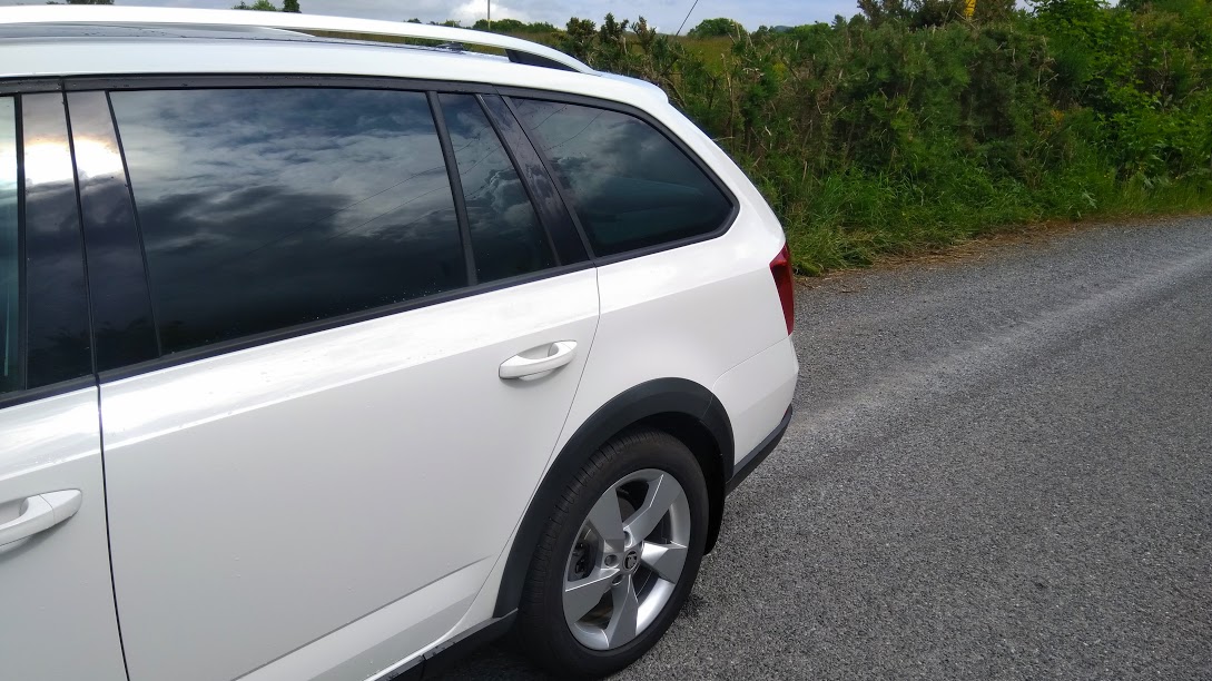

I have a white Scout and definitively need them!

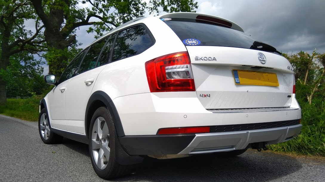

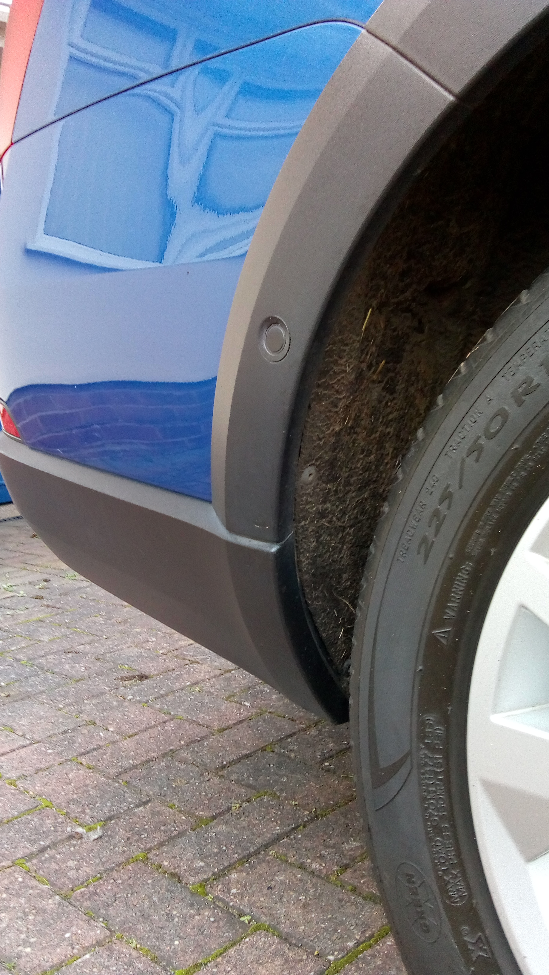

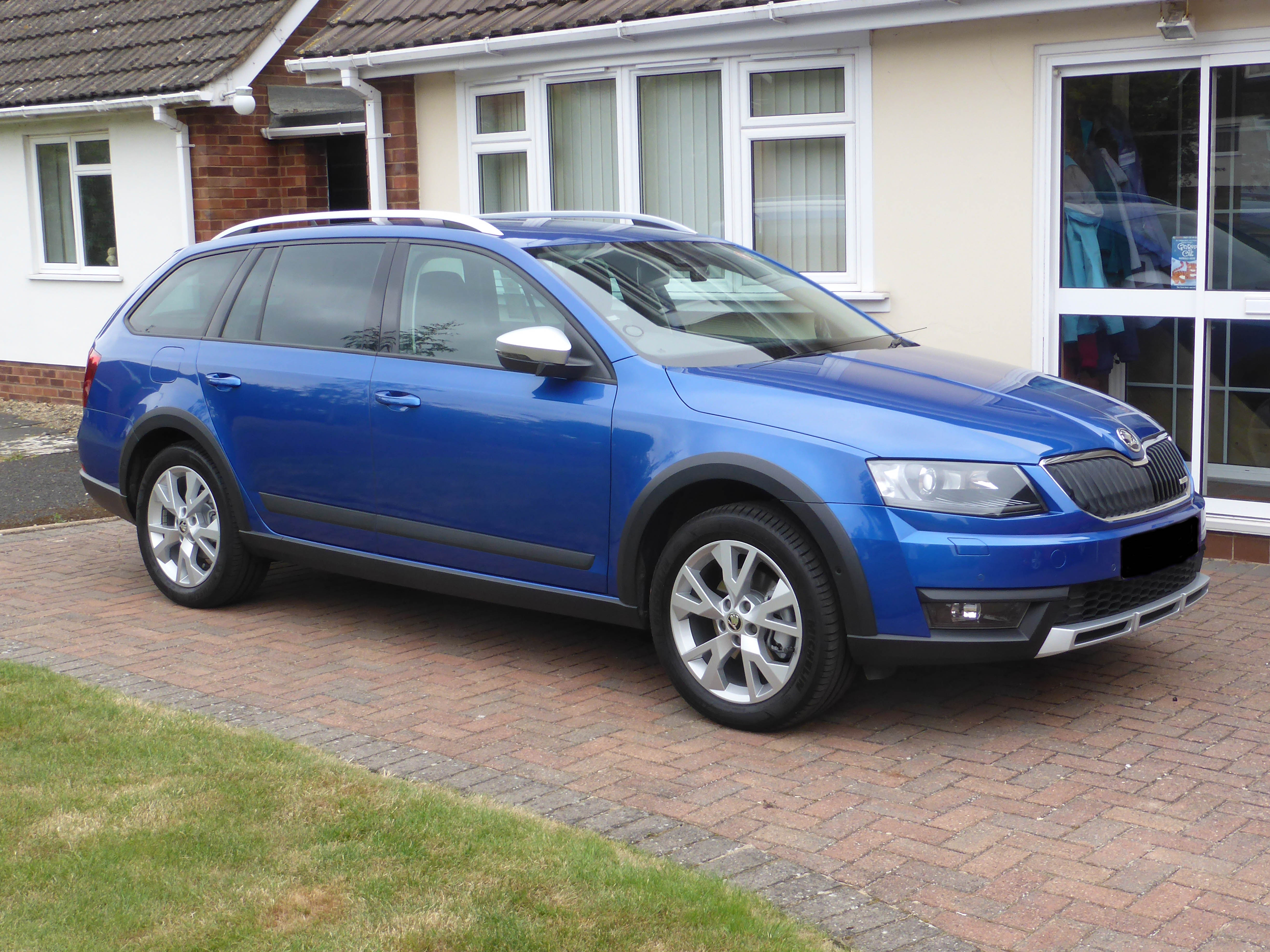

Photo of my Scout follows (clean for once!), and photo of rear wheelarch showing position of sensor which may get in the way of mudflaps.
Same...

Thanks for the response which is encouraging. My race blue scout is fitted with park assist so it has a sensors all round, including in the rear wheel arch close to where the mudflap would fit. Can you measure the distance from the join of the rear wheel arch moulding and the lower cladding, to the top of your mudflap. This would check whether the mudflap will be too close to the sensor. I really want to fit rear mudflaps to cut down on the stones and mud thrown from the rear wheels onto the front of my caravan when towing.

Can you take a picture of your wheel arch showing where you mean please?

"Can you take a picture of your wheel arch showing where you mean please?"
I've already posted a couple of pictures on Weds at 17:24.

From the screw inside the wheel arch lining to the top of the mudflap is approx 70mm. From the trim intersection to the top of the mudflap is ~125mm.
At the very top, the mudflap just clips into the wheel arch. I don’t think it would interfere with your sensor.

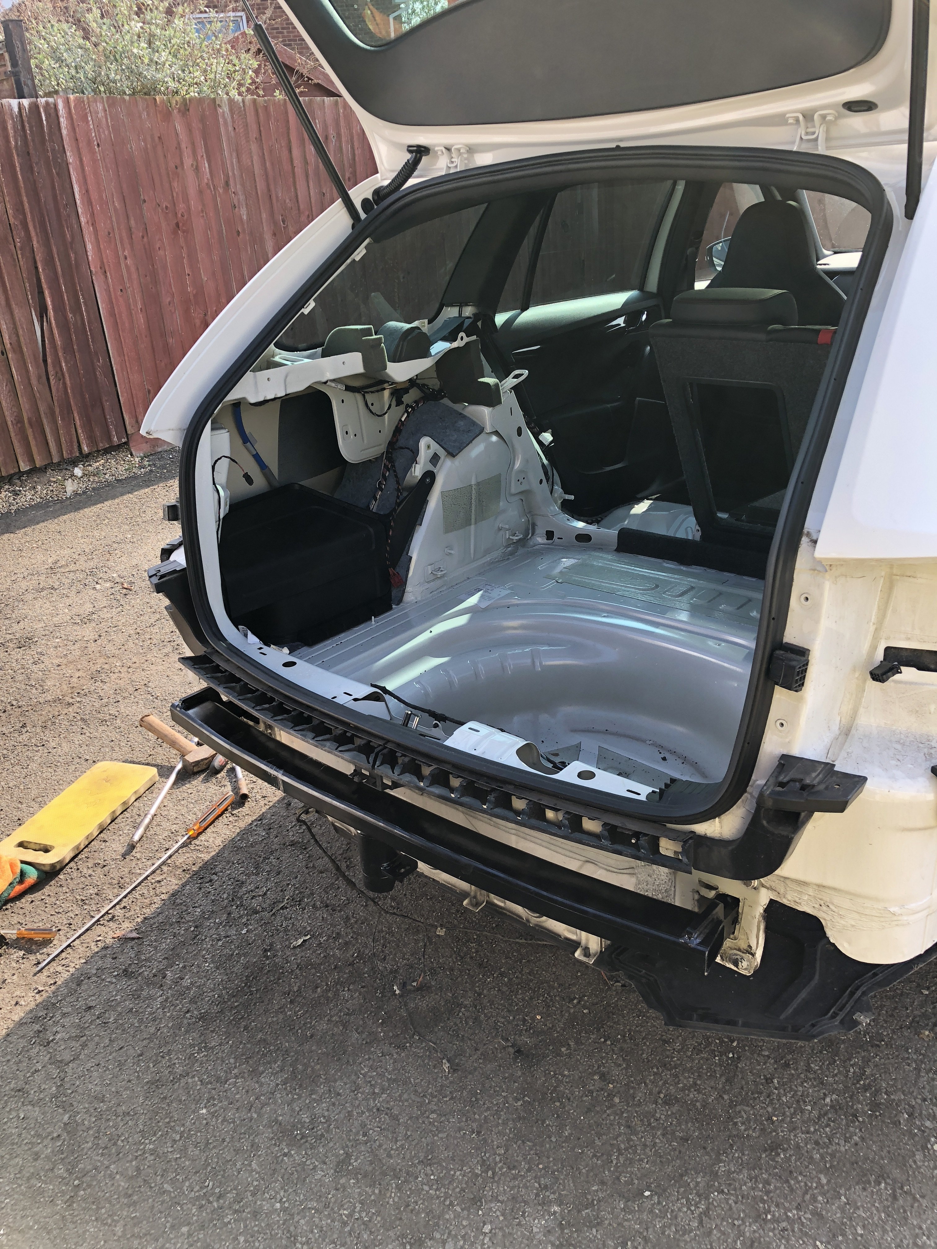

I have a part of the rear suspension in my garage as apparently the towbar gets in the way! Could be an anti-roll bar but I'm not absolutely sure.
It's likely to be the the crash bar from behind the rear bumper - the towbar has its own which replaces it, like this one (thanks to @Phillips)
I sincerely hope it isn't part of the rear suspension that they've given you...

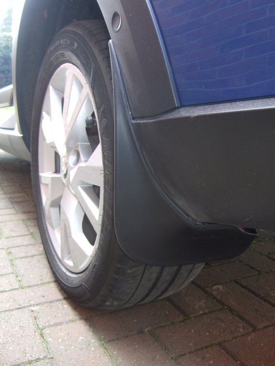

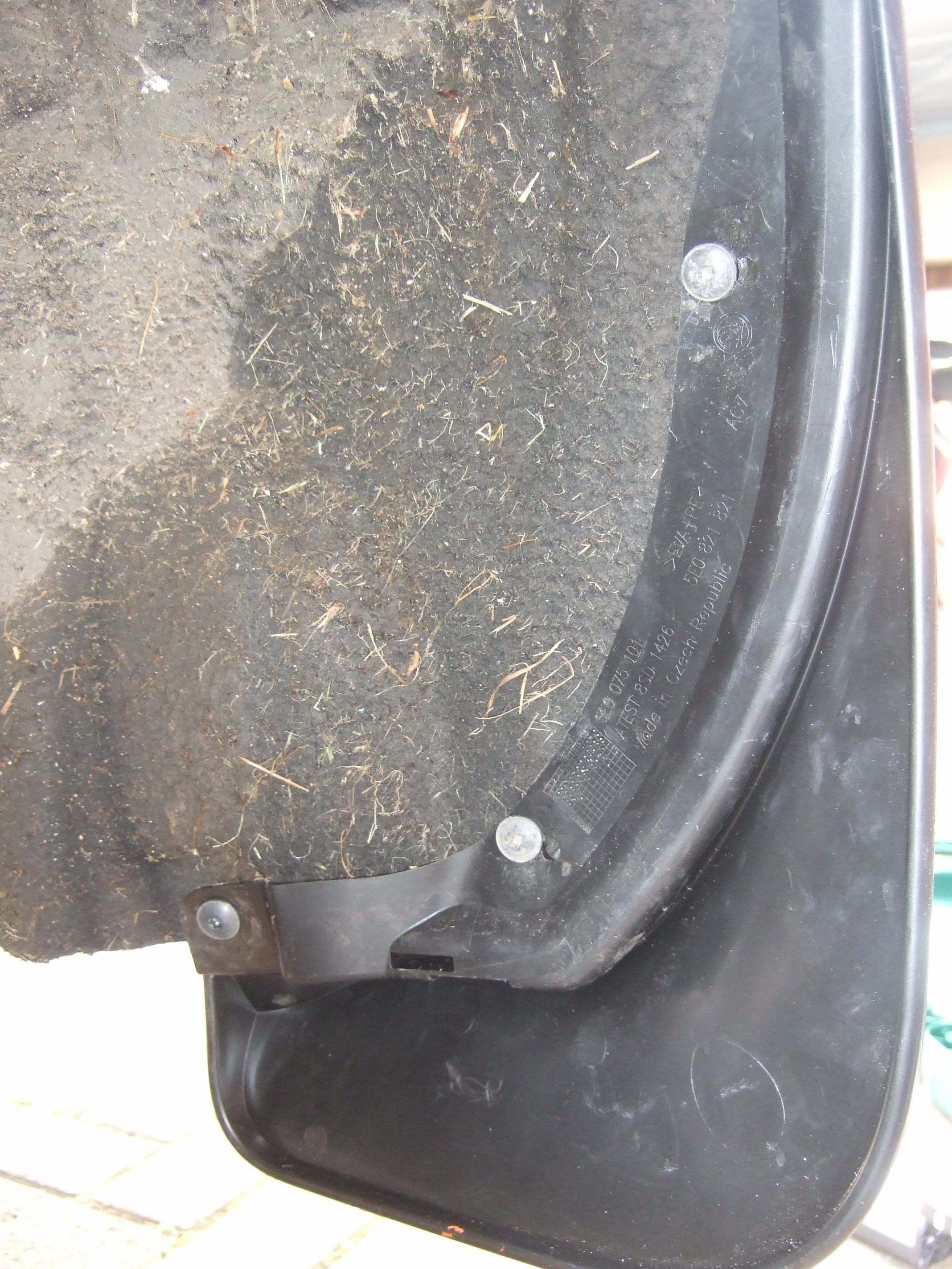

I've now fitted the standard Octavia Mk III front and rear Skoda mudflaps to my Scout - see attached pictures. They fit quite well but need minor mods as has been mentioned. New holes have to be drilled in the mudflaps for the mounting screws. The Skoda rear mudflaps are supplied with small metal clips for extra support for the inner part of the mudflap, and these clips attach to the bottom of the wheel arch liner. The front mudflaps are supplied with extra plastic studs which locate similarly in the wheel arch liner once a hole has been drilled. I have also cut off the lug at the top of the mudflap (shown) which would clip into the edge of the wheelarch on a standard Octavia to give a better fit. This still leaves a slight gap between the mudflaps and the cladding, so for a finishing touch I've used exterior-grade black sealant to fill the gap.

The photos above show the Skoda Octavia Mk III 5E mudflaps fitted to my Skoda Octavia Scout Mk III, and they will fit with holes relocated.
So far I've found that they reduce the mud thrown onto the lower black cladding behind the wheelarches, as you would expect, so I think they are worth doing. I found my genuine Skoda mudflaps on Ebay for around half the dealer price. I'm now thinking about fitting mudflaps to our Fabia III hatchback although this does far less miles.

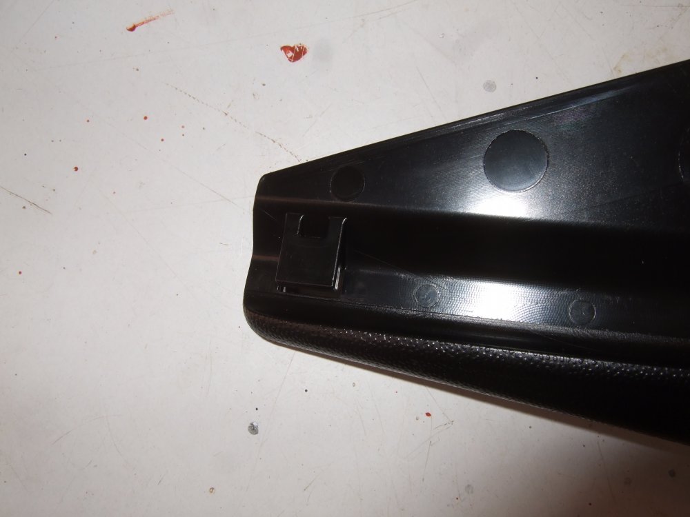

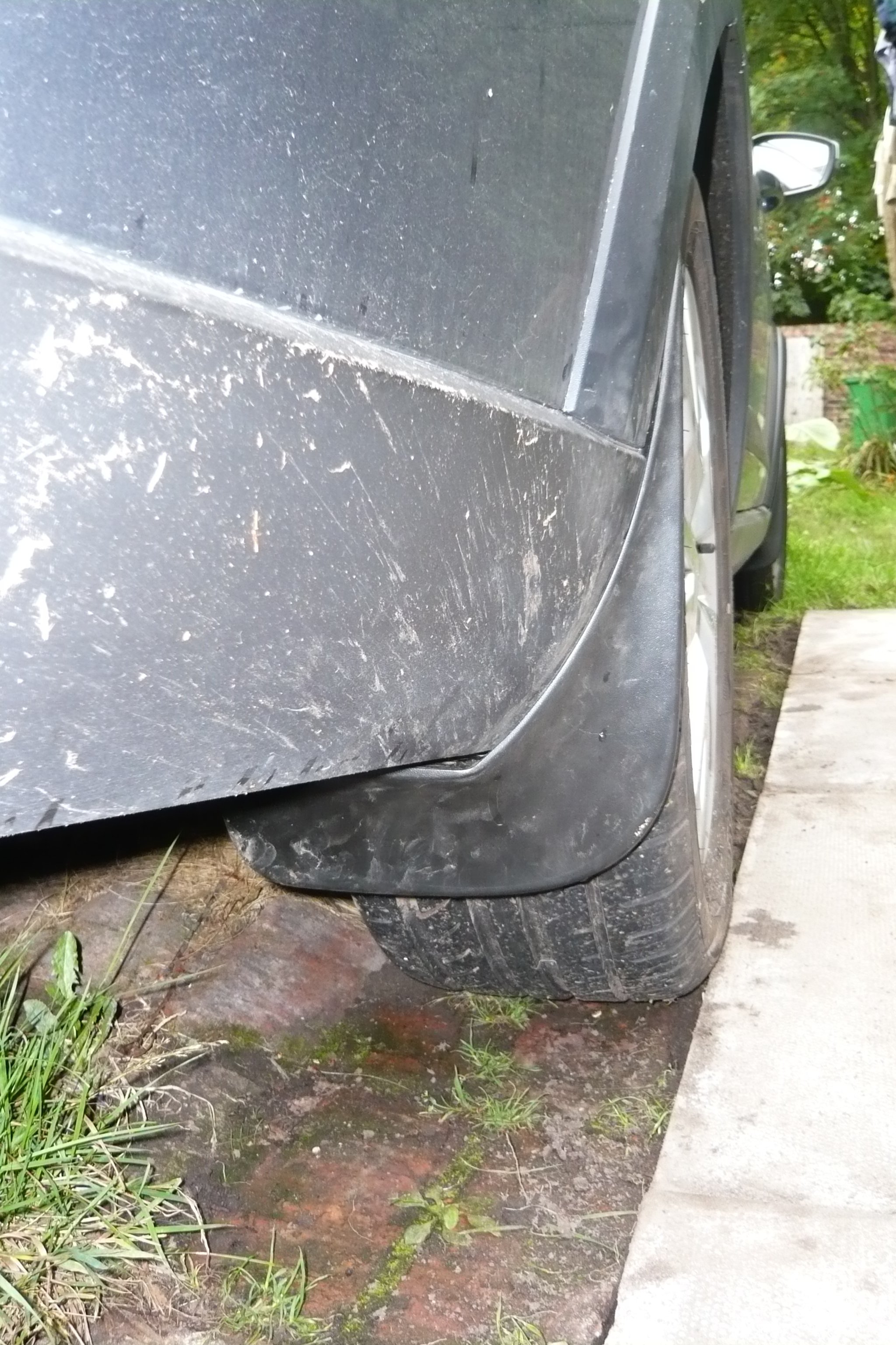

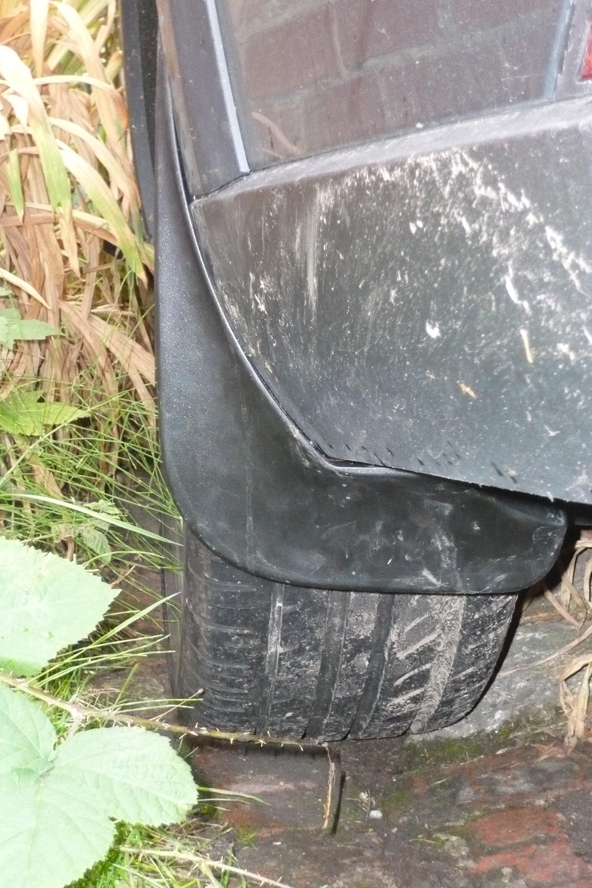

Thanks to the valuable info on this thread, I've managed to fit fore and aft OEM pre-facelift mudflaps to my Scout.

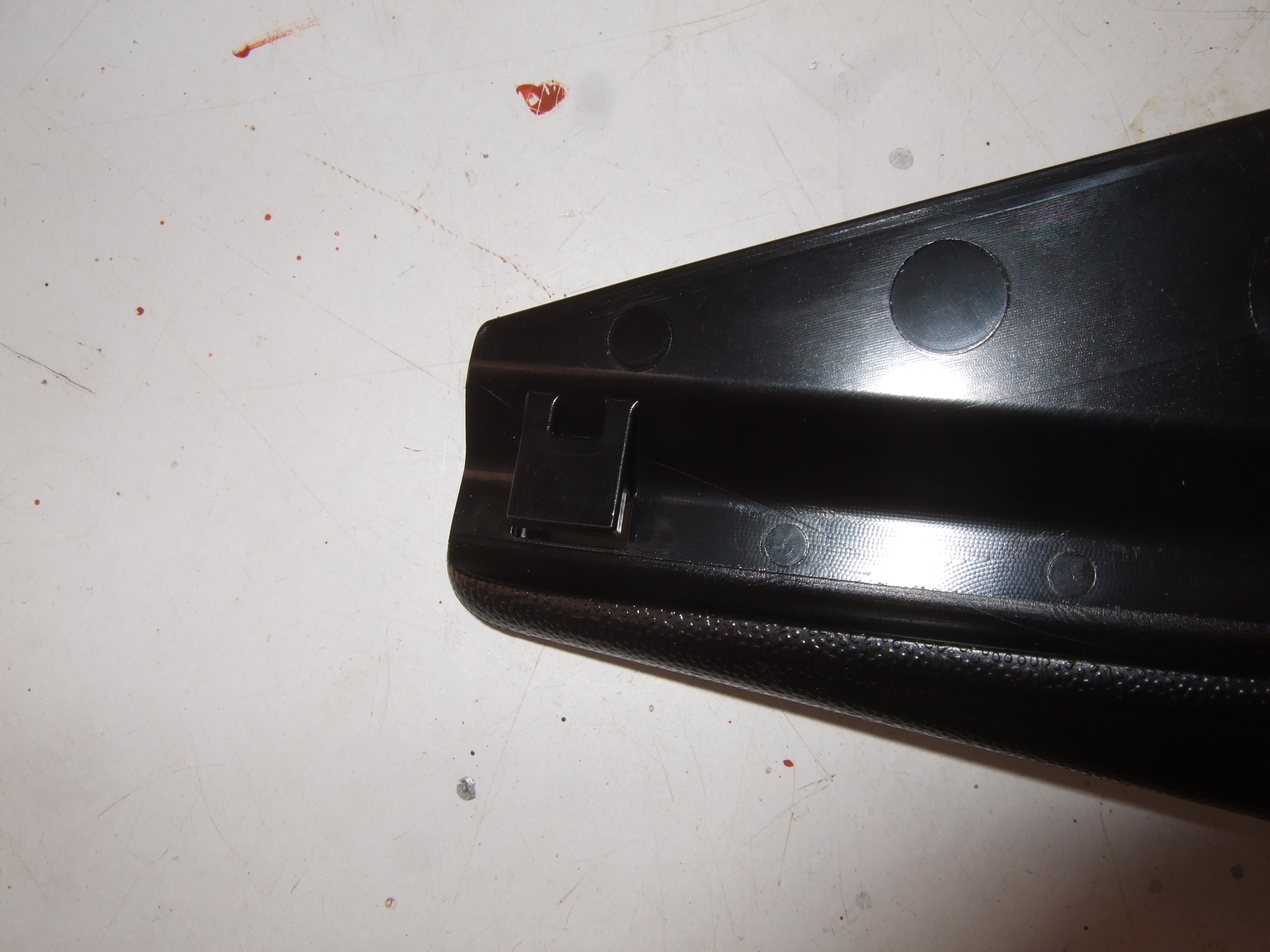

Additionally, I found that on the rear flaps, the top clip need not be cut off, but could have its bite deepened (junior-hacksaw blade and penknife) so that it still fulfills its role notwithstanding the Scout's body-kit. I removed a plastic clip-like arrangement from the middle of the upper side of the horizontal part (penknife) which allowed a closer fit of the thing to the plastic underbody.
For both front and rear, a bit of in-situ moulding after careful heating with an electric hot-air paint-stripper, followed by quenching with cold water, seemed to improve the fit to the contours of the car. Or it might be my imagination - but it seemed a clever idea at the time.
Anyhow, I'm pleased with the results - so thanks again
No pictures? :sadsmile:
It's dark! I finished the job with a head-torch on.
Pictures tomorrow, if you're good.
L1000541.thumb.JPG.27cc49d41a6f35a9bb2f6176d380a910.JPGL1000542.thumb.JPG.28f937b6a198632d90aad57a3d3ccf27.JPG
Edited by Sangrail
These are the back ones.
