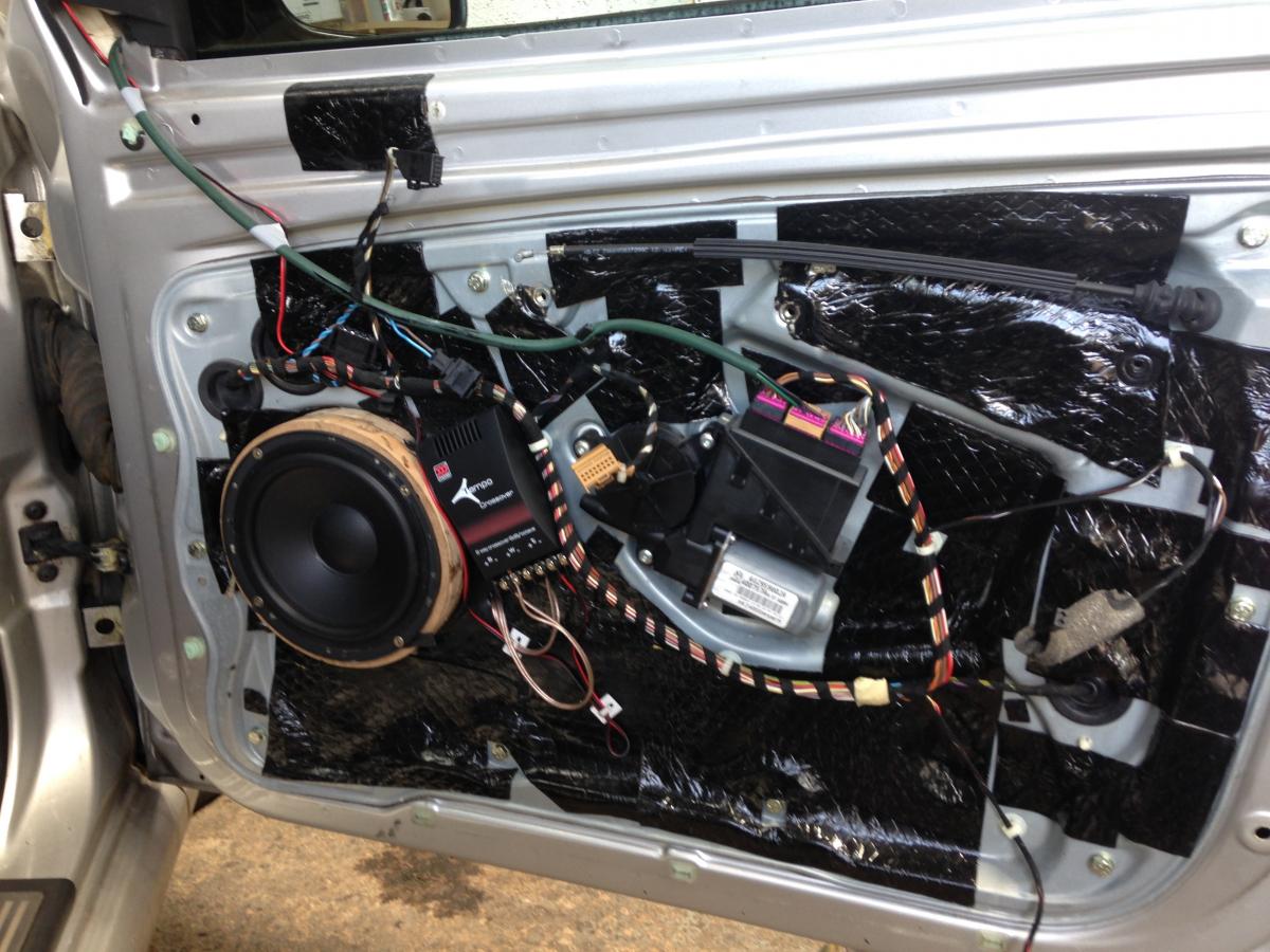

As as already been said by vindaloo the Fabia's door construction is actually pretty good. It's does a good job at creating a sealed enclosure.
If your not amping the speakers or investing in a decent pair then the only thing I would suggest, is to mount your speaker using MDF that and coat the inner door skin with some Sound Deadening tiles making sure you cover any holes.
That will help eliminate any loss of mid-bass by ensuring panel resonance is kept to a minimum.
Another tip would be to buy some door card clips because the chances are you will break some.
I have included a pic to show what I have done with my car as an example. The Sound deadening I applied was some cheap stuff I brought from Ebay, but the stuff that Silent Coat makes is better but a little bit more expensive.
