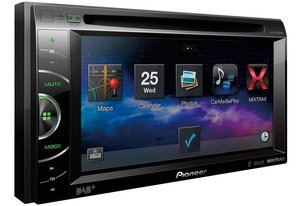

I was looking at a new head unit today. My friend currently has this for sale: http://www.halfords.com/technology/car-audio/dab-radios-car-stereos/pioneer-avh-x3600dab-double-din-car-stereo
Questions:
- Would this work with the rapid as I'm interested in DAB and the Apple CarPlay feature?
- Will my reverse parking sensors connect to this?
- Is it a direct fit? Do I need extra wiring?
Thanks in advance.
If you replace the Swing with an aftermarket non-VAG stereo you'll need the following:
Harness adapter (to convert the quad lock connector on the car's wiring harness to the ISO connector found on the vast majority of aftermarket stereos - about £20
  or
Steering controls adapter - if the new head unit supports steering wheel controls, you'll need an adapter to convert the signals. Usually you can get a single cable that will handle both the quad lock-to ISO conversion and the steering controls (costing about £40 in total), which will save a few quid and reduce the amount of additional cable you have to tuck away behind the dash
If you have factory-fitted reversing sensors, it gets messy. You will lose the visual radar view, but you may still get the beeps. I'm trying to clarify if you need to add in an additional cable to reinstate the beeps (which you need to do on Renaults and Peugeot/Citroen cars when you replace the radio with an aftermarket one, as it's the radio that generates the beeps).
I'm also unclear how this will affect the Bluetooth setup on the car, if you have it, as I believe this is a separate module rather than being part of the head unit.
Further tp my last post - this looks like the adapter cable for us:
http://www.connects2.co.uk/C2/C2RangeProducts.aspx?Manfid=53&Groupid=115&Parentgroupid=114&Modelid=356
This single solution will convert the quad lock into an ISO, adapt the steering wheel controls to work with the aftermarket headunit, and will retain the visual reversing sensors display (as well as the beeps). It will also do the climate control view if you have climate control.
It is designed to work with any double-din head unit with a reversing camera input (it uses that input to insert its own visual displays for the above), which I think includes the Pioneer Apple Car Play unit.
Suffice to say I am now considering this myself.
