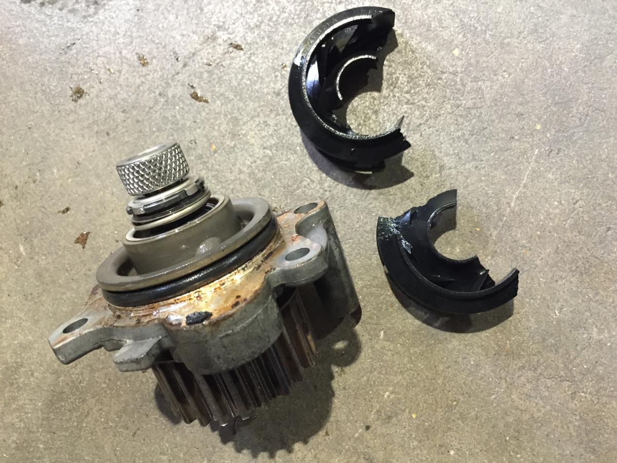

Water pump gone (1.8T) - ok to drive 10 mins to the garage ?
As above, temperature suddenly soared and warning light came on, but luckily nearly home.
When cool this morning, took the header tank pipe off to see if coolant is being pumped (as suggested on Briskoda) and it isn't.
So, as the garage is literally 10 minutes away, will I do any damage by limping in - as long as I stop and let it cool down again if / as soon as the warning light flashes ?
It will be the plastic impellor one as I have no evidence of it being changed by previous owners even though they had FSSH and 2 cambelt changes.

Well it looks like a clean break !
