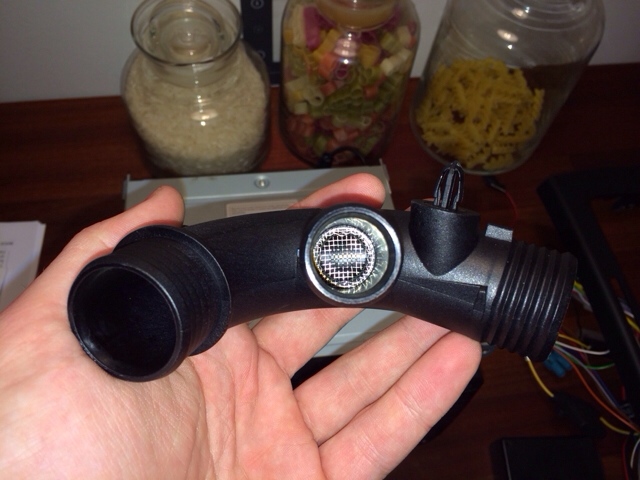

Agree. Dead thermostat. I fixed this on my 170 TDI DSG last year.
It is located on top of the gearbox.
Make sure you have the new model "splitter" with filter, so new dirt doesnt block your new thermostat.

What is the part number of this splitter you mention?
1K0 121 087 AH - Splitter with filter
1K0 121 113 A - Thermostat
