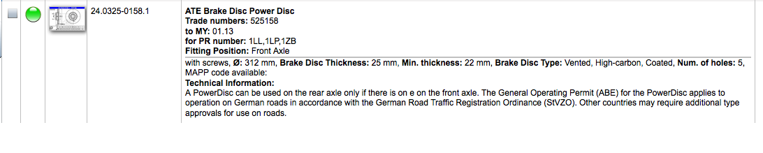

I used to have ATE Powerdisc on my pimped Fabia HR II, see spec here. It was well balanced car with exceptional grip. ATE is OEM VAG so there little difference. I suspect it is OEM rotor with milled grooves.
Fabia HR II was well balanced FRC (Family Racing Cup :-) car - brake system overheated very quickly. Furthermore, ceramic pads transferred most heat to callipers and brake fluid boiled very quickly. With Ferodo pads, rotors would burn I suspect or everything would burn and boil.
I doubt ATE Powerdisc would be improvement for you - it is beginning for rookie tuners who have poor braking skills. All I see is better performance than OEM - I guess due grooving and ceramic pads. Otherwise, not big difference.

I meant that ATE PowerDisc is normal rotor with grooves because I had one and burnt it ;-) ATE product info doesn't specify whether it is high-carbon material or not.
Where did you find that ATE PowerDisc is high-carbon cast iron?
Yes it does
See above
