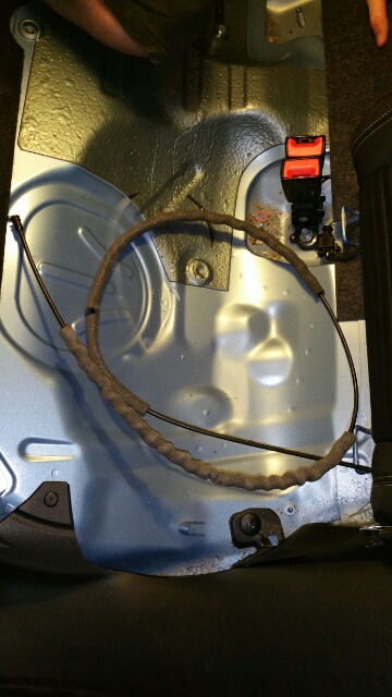

Ok so bought collected and fitted the seats today and what a difference they make, now someone here may be able to tell me what this cable is or what exactly it is supposed to do or go. As I can't for the life of me figure it out. For now it's lay in the boot may I add it stretches from the rear seat all the way to the bumper.
Also the new seat bench on one side when I push it down the clip at the front pops back up any ideas for keeping this down?
