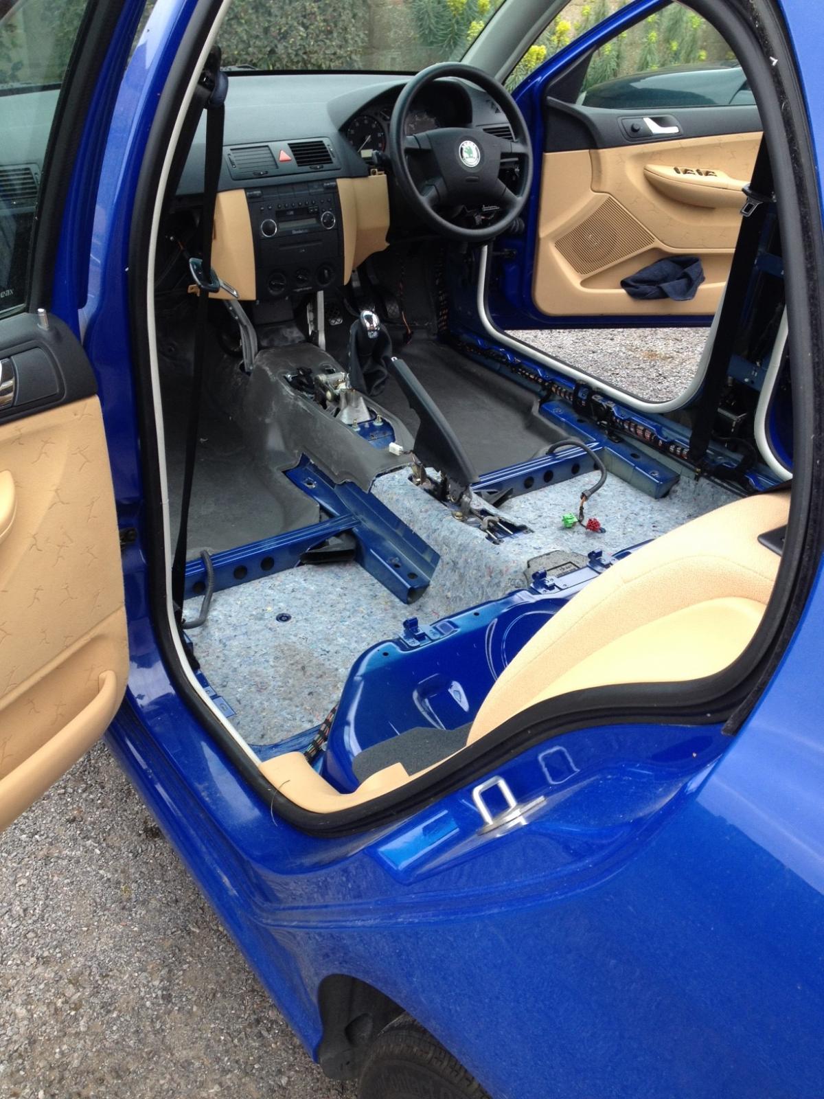

This meant I would need to add wiring, not an issue as the E46 seats just require a positive and an earth, but the memory function would obviously no longer work. But, this turned out to be a much bigger job than I'd hoped with removal of the carpet necessary, and the trim that is notorious for breaking due to the difficult to remove retaining clips.

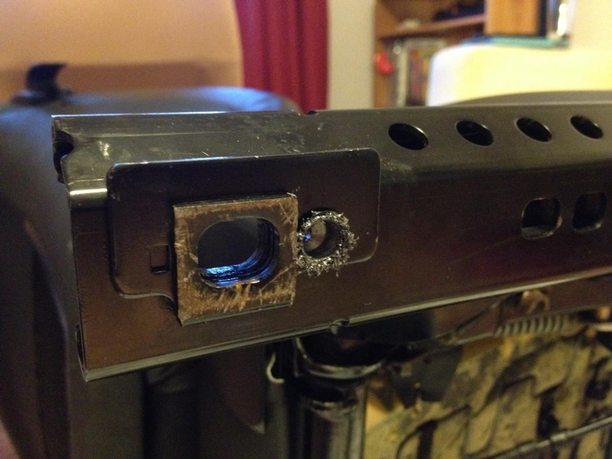

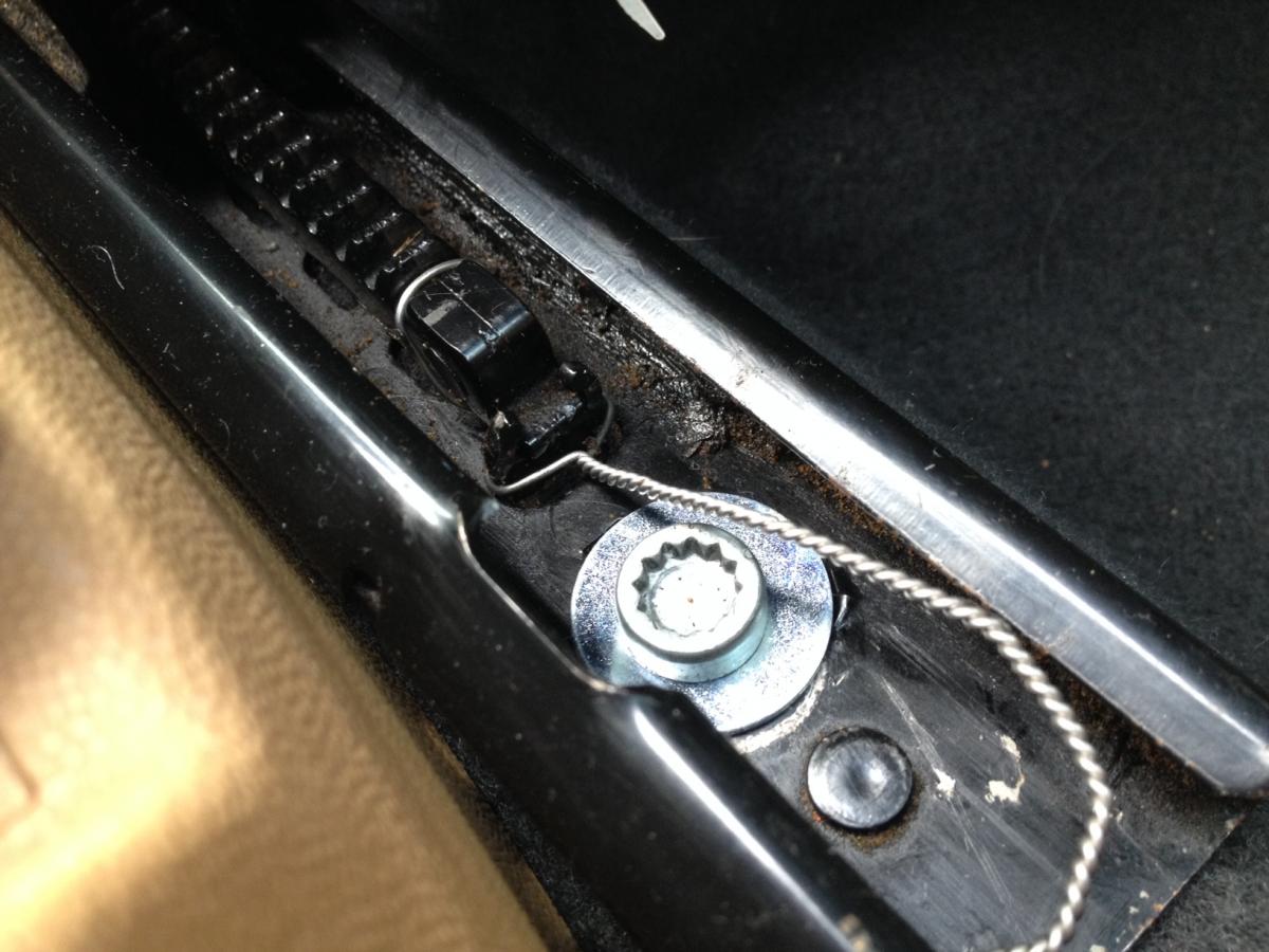

I used the original front holes on the E46 seats, and drilled new holes at the rear. It just so workout out that an 8mm rivet is located in the perfect location, so drilling this out gave a hole exactly where I required for bolting the seat down. This rivet holds the rack for the electric adjust in place, so removing the rivet means that you cannot adjust the seat forwards and backwards without the rack moving out of position. I.e. you bolt the seat down at the front, then use the motor to move the seat forwards to access the rear mounting positions, but the rack pops out of place, and you need access to the front to get it back in place. I resolved this by using locking wire to hold the rack in place at the front.

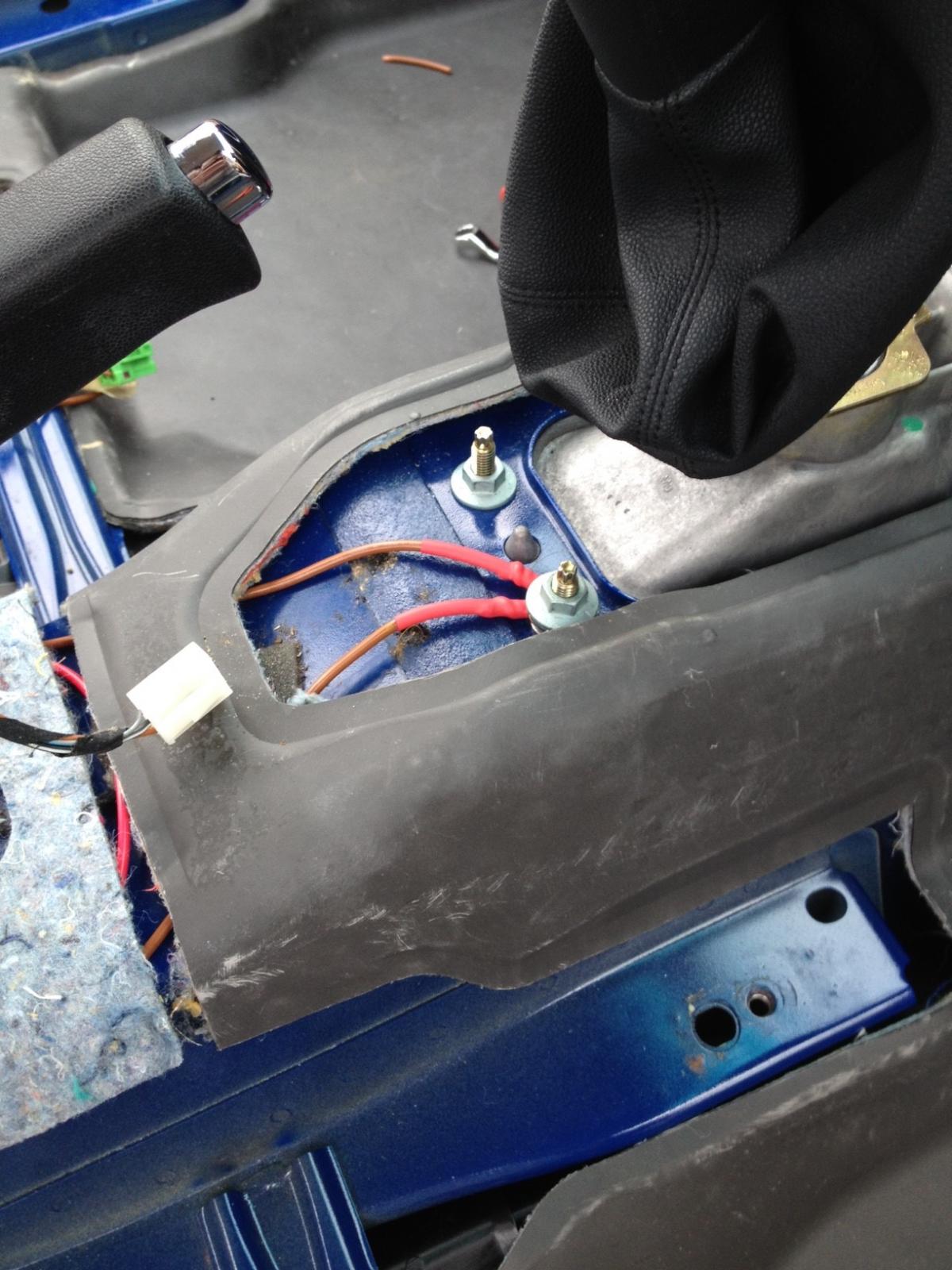

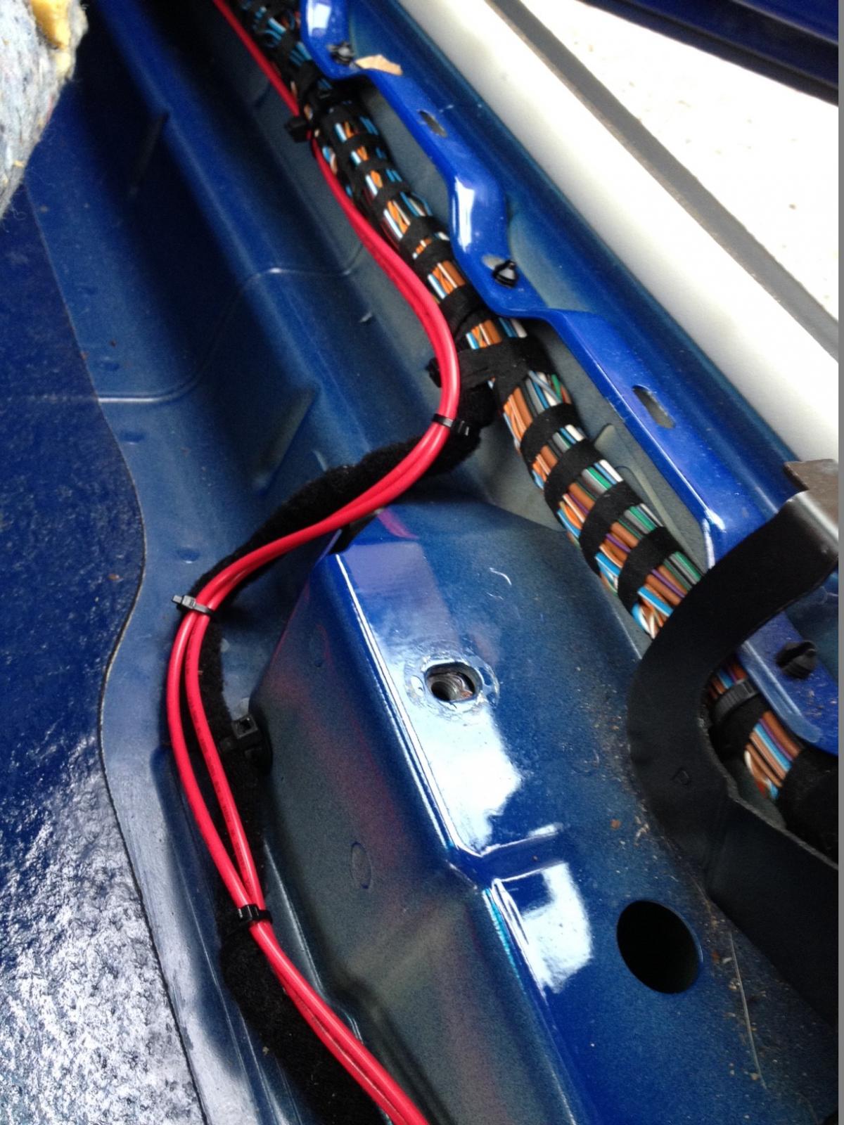

I have run a permanent live power supply to each seat with 25A inline fuses from the power rail above the relay board. I have used one of the bolts around the gear lever for the earth.

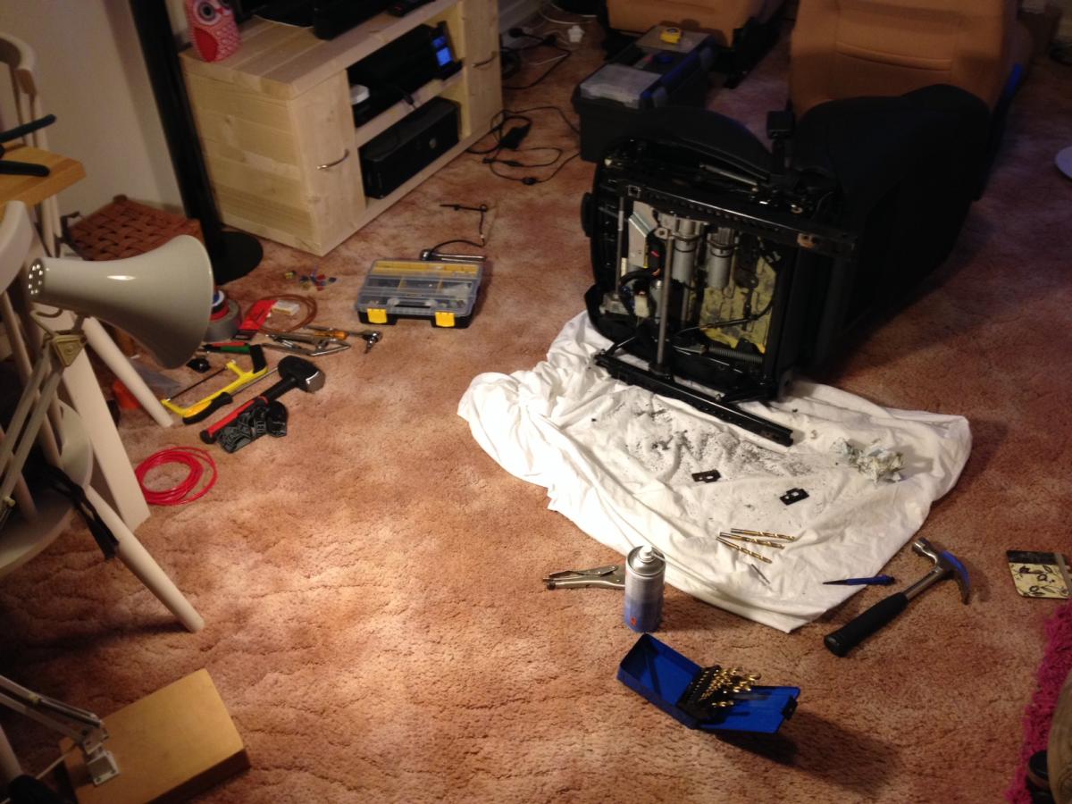

Overall it wasn't too difficult of a job, but it would have been a huge amount easier if I had garage space and didn't have to keep lugging the seats up and down the stairs to our flat. For anyone wondering how much heavier the electric seats are than the standard Fabia ones, unfortunately I didn't weigh them, but it is a considerable increase.

Pictures showing the rear hole created by drilling out the rivet, and my lounge/workshop.

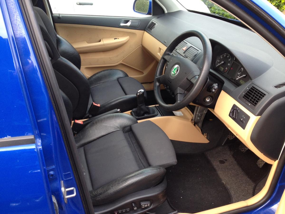

Seats fitted:
Detail of the locking wire, holding the rack in place from the front. This is only required whilst the seats are not bolted in, although I will leave the locking wire in place so that if I have to take them out for anything, I don't have to redo the locking wire:

I was going to add these images to my original post, but being just a standard user, I cannot edit it now. I'll put them here just to save the need to click on the images in the first post. If an admin would like to move them, that would be great.
