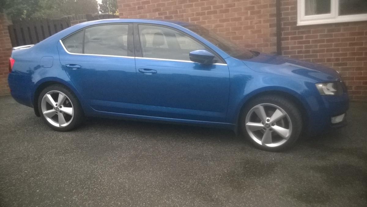

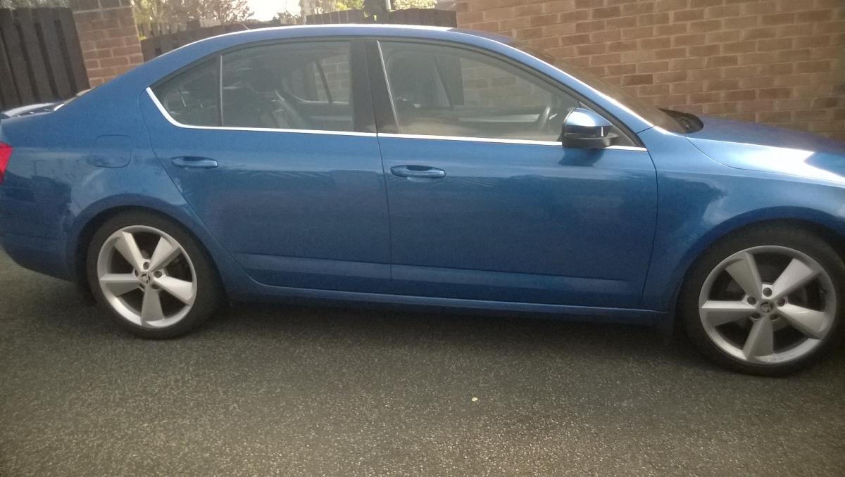

Handling around the bends and at roundabouts seems to be a little more positive and as for stance, the attached before and after pics speak for themselves....
Before...
After...

The second photo looks spot on  :thumbup: .
In the first photo the ride height is that of a 4x4, are you sure they didn't fit "Scout" suspension by mistake!
Its normal height. Its called a car!!

The car also just sits so much better, I can't stop admiring it's new stance, and it's got that new car feeling all over again! Parked next to a colleagues Golf Mk7 GTD, the ride heights are now identical.
