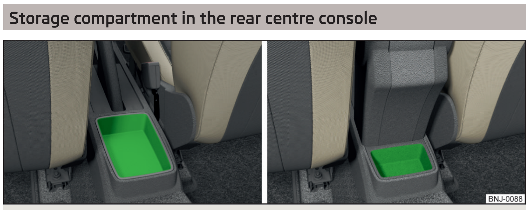

Probably a bit late, but do you still have the original hole cover from before you had the arm-rest?
(The green tray in the left pic)
Hmmmm I might actually! I didn't remove it when I traded the car in, so it's probably still around. I'll go have a look for you.
Thankyou! I'm looking to remove my arm-rest, and the only thing stopping me is the fact i'd have a massive hole in the console.
Someone somewhere said its possible to ring a dealer and get them to order the part, but having asked my dealer they don't seem to think its possible as it's a factory fit option and not aftermarket. (though they do provide a service to fit parts if you manage to get them yourself)
