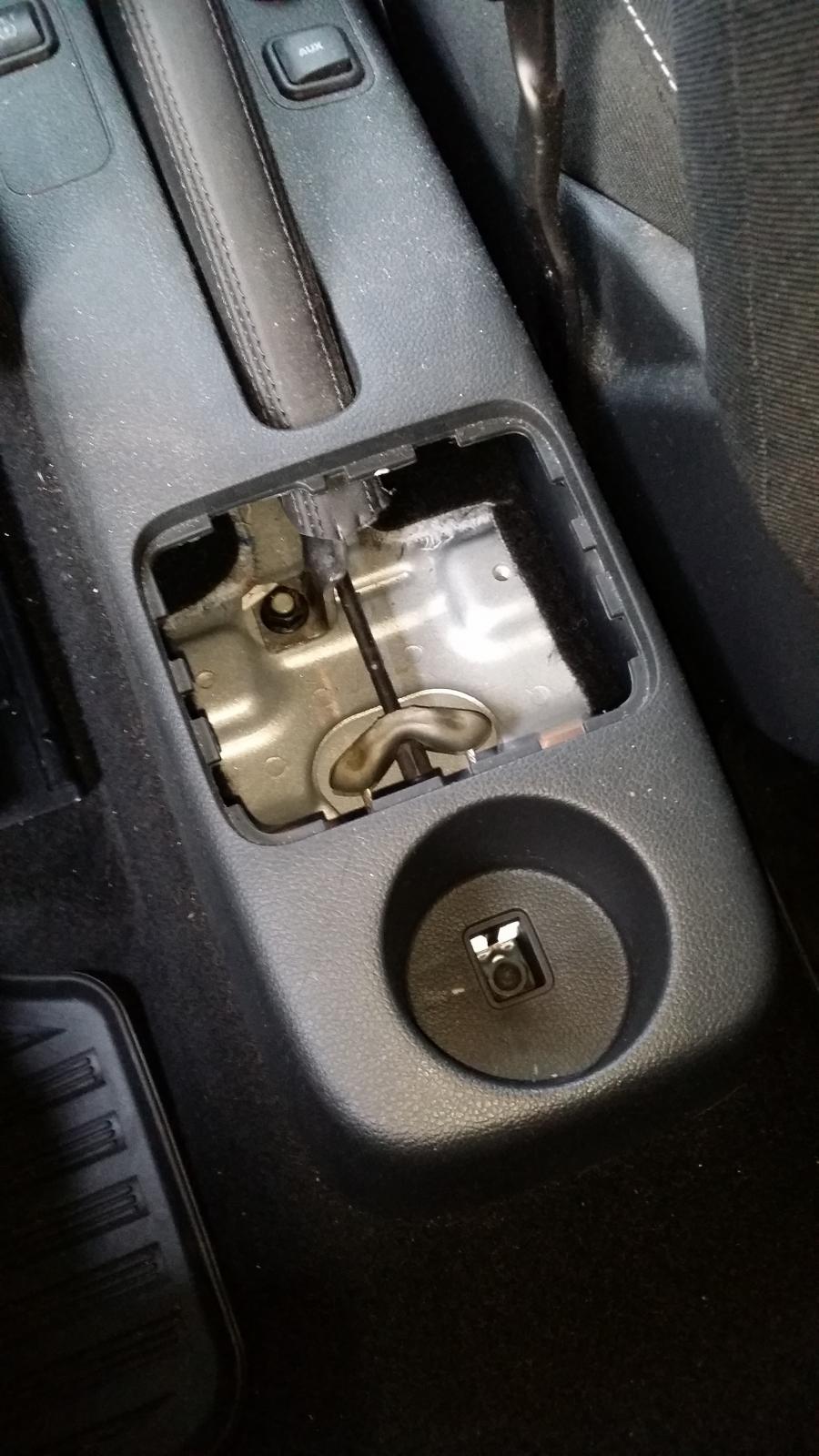

If you're worried about fitting it yourself it was a piece of cake, basically you undid a screw in the rear cup holder, removed the tray behind the handbrake and the thing goes under the plastic center console 4 screws into the floor then the rest is attached to that part, took me about 20 mins saving me fitting charge, was funny reading the instructions on how it states its a dealer fit option and not to sell seperately lol
If your buying a car from them they should be able to do a deal on one, i got mine for 100 quid just because they had one in the back for a while.
Edited by raymundo
Thanks chaps - will update when installed (might be a few weeks though).  Not worried about putting it in, I like a tinker... Thanks for the pic though, should make it easier to get inserts out etc.

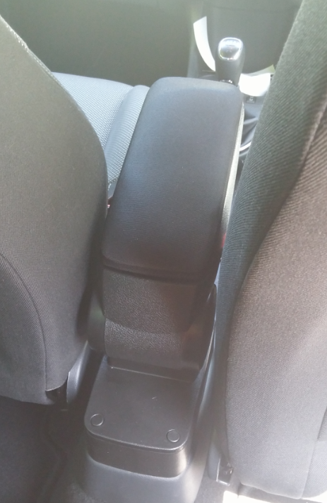

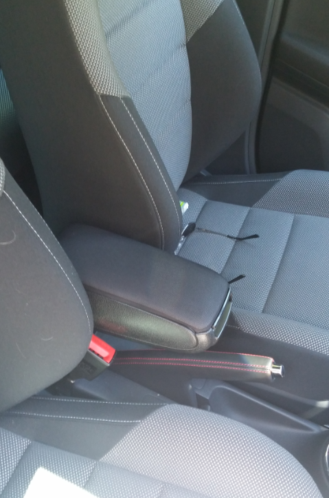

So, just to update for any future searchers...
It's in, all good.  Is quite wobbly compared to the Genuine part, this seems to be because it only attaches to the plastic of the console between the front seats, not to the chassis like the genuine part.
It also appears shorter, so great because you can use the handbrake easier, but if you're a shorter person and have the seat forward you may be perching on the edge a lot more... or may not make use of it at all if you've got the seat all the way forward.

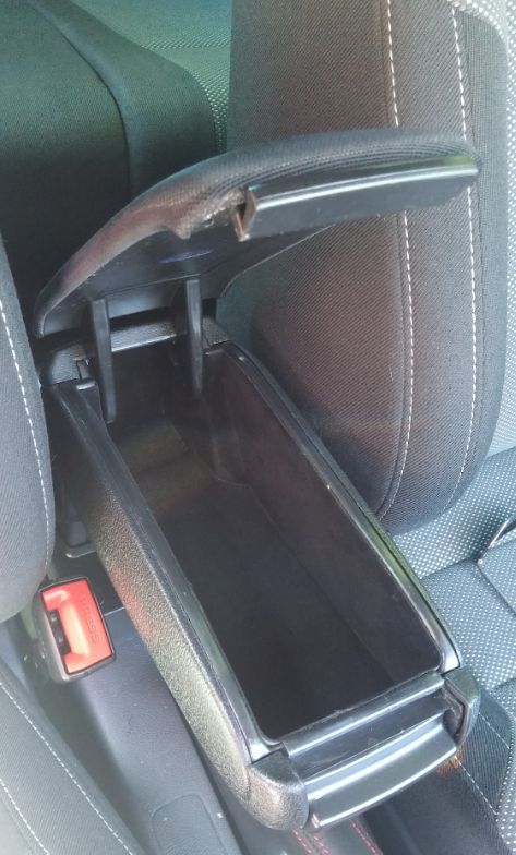

It's bigger on the inside too.  Than the genuine part that is, not like a TARDIS or anything...
Anyhow, thanks for the tips.  I'd be happy spending a few quid more for attachments that fixed this to the chassis, but am happy with it for the price, and is as comfortable as the genuine for me.
Also - if you fit one of these, I suggest you drill some pilot holes for the screws.  Makes life much easier!
Edited by jme808
Does this mean that if you remove it, you'd have visible screw holes?
In the middle cubby hole yes, there is a rubber cover for the cup holder so they could be easily hidden - or would not be visible at all if you went for the genuine part instead.
I'm sure you could get / cut some dimply rubber to cover them though.  Or just stuff it full of sweet wrappers...
It looks very decent. If it's a bit wobbly, I'm not too concerned and I have the seat nearly all the way back so, I'm going to try it out as well.
