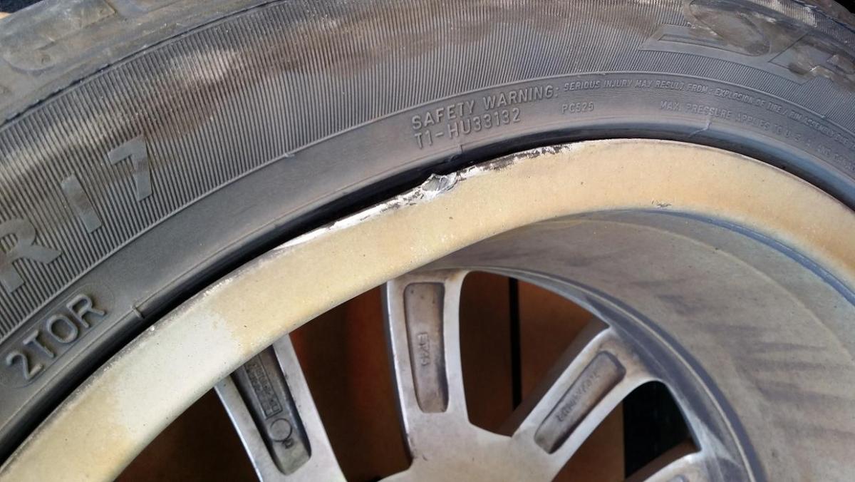

Hi,
Was unfortunate in hitting some debris on the motorway this morning resulting instant tyre blowout (ffront driver)

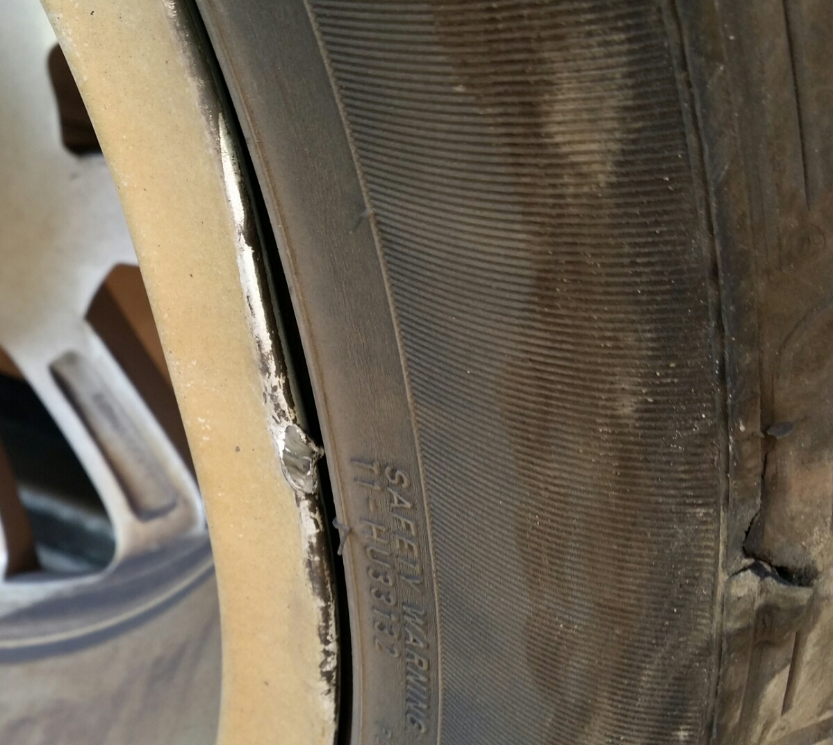

On inspection it looks ok on front facing side.
However one section of inside rim looks damaged or slightly bent?
The tyre damage was on the same point so suspect that was the point of impact.
Was doing around 50 - 60 ish. ....but saw it too late as there were 2 other cars that broke down due to same issue!
Anyways just wanted to see what the thoughts are on the alloy? Is this gonna cause issues or is the comestic damage going to be fine?
Also do you reckon I would need to be concerned with any alignment issues due to such impact?
Now on the look out for tyres....any good all season recommends?
Cheers
HY
I would say that is structural not just cosmetic, I would bin it
The rim looks bent in to me, not just abrasions.
I'd get the wheel off the car to check and probably get a new wheel.
It definitely need tracking/wheel alignment checking after a knock like that.
PS: Love the "Safety Warning" stamped on tyre where damage is. :devil:

How much is a 17" alloy retail at? And is it possible to repair than to replace?
Suggestions to bin the alloy are ridiculously wateful. Unless you're stinking rich, just take the wheel to your local alloy wheel refurb place and have them repair it.
It will come out like a brand new wheel. And cost you about £50-£80.
I have seen wheels in MUCH MUCH MUCH worse condition than that (some have been completely split) be repaired with no bother.
I was quoted ~£375 ($A750)!!! from a dealer.....no thanks.
I assume it's safe to use in its current state and will not cause issues or wear?
I assume the point of repairing is to prevent vibrations in the steering?
I had one of my very out of round Audi alloys repaired locally for £60, fantastic job done and you would never know now. Before you could look at it and see how far out it was visually, before it even went on a balancing machine.
The OPs wheel looks like an easy fix that any refurb place should be able to sort.

Just need if the alloy can be repaired first? then get the tyres followed by getting the alignment checks done.
Hope there's no suspension damage! :(
The alloy can be repaired. That's not even remotely questionable.
Would I drive on it in the meantime? Only if the vibrations are relatively minor and the tyre is holding pressure sufficiently to complete the journey safely. Bear in mind every revolution it is likely a tiny amount of air will escape as the affected part of the wheel takes the load and the tyre is squashed into the rim slightly.

Can I ask if that would be the only impact of the alloy in its current state I.e abit of vibration thru the steering and possibly loss of pressure. Or long term would this cause premature wear and damage to other elements of the car?
Hang on, you're not planning on putting a new tyre on a damaged wheel are you?  I suspect most tyre fitting places would decline to do that anyway.
It's a pain having to drive on the spare while the repair is done, but if I were you I'd definitely get the wheel fixed first.
Well i had dropped by a local kwitfit for prices and got another opinion on the alloy. Was told it didn't look too bad and advised they could balance it out but might still get some vibration but recommended it was fitted on the rear.
So which is why I ask the further questions.
However I do plan on dropping by a wheel repair shop and see what they say as well.
