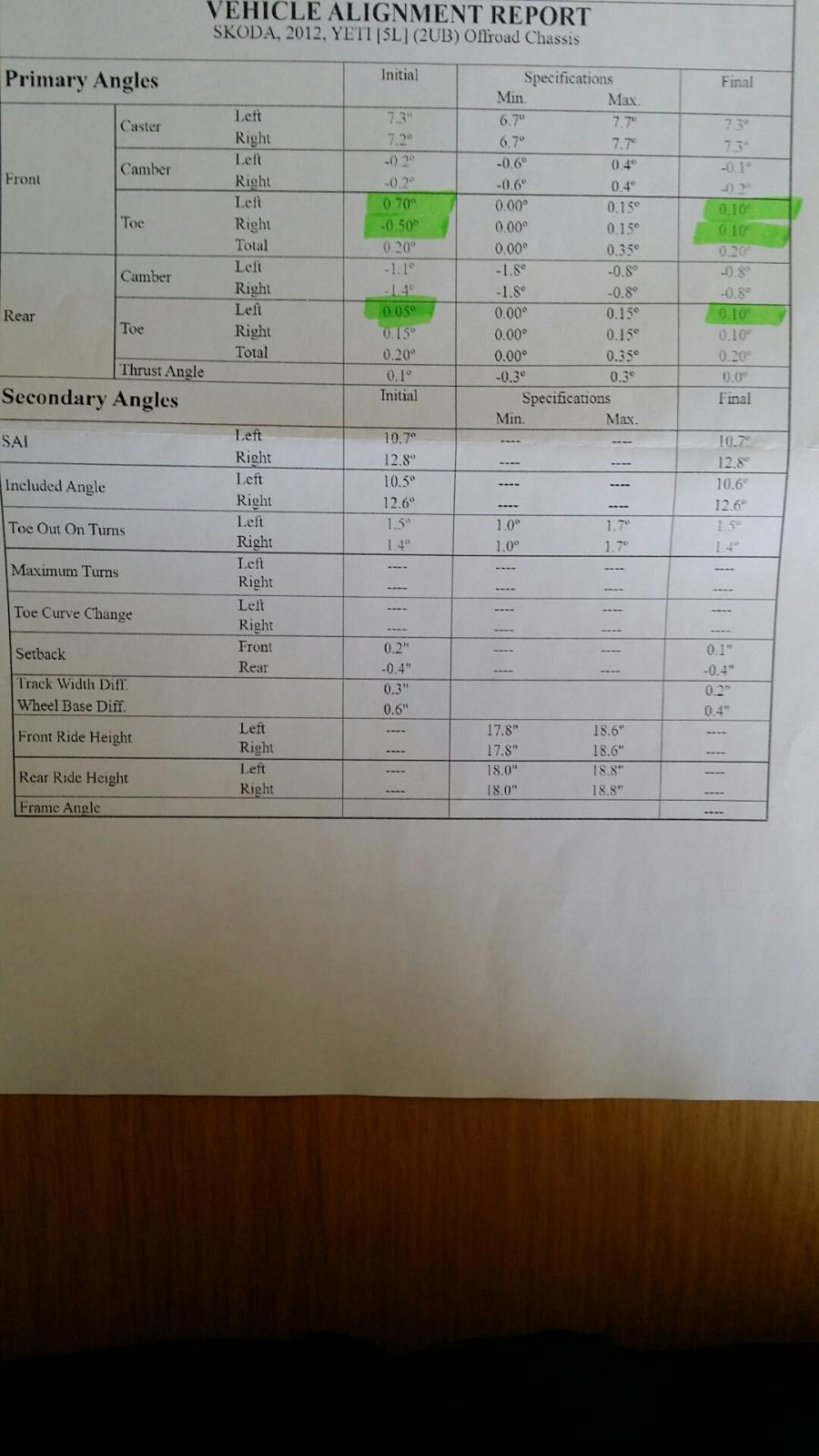

Just had a 4 wheel alignment carried out today with the new set of tyres.
Was given the following print out of before and after.
As mentioned I hit some debris on the front driver side causing a bent alloy. But previous to this I notice sone abnormal ware on the out side edge of the front passenger tyre.
Anyone make sense of these settings and new adjustments? Do they look good, just hope it will have fixed the wear issues on the outside edge of the front passenger. And no wear impact due to the recent accident.
