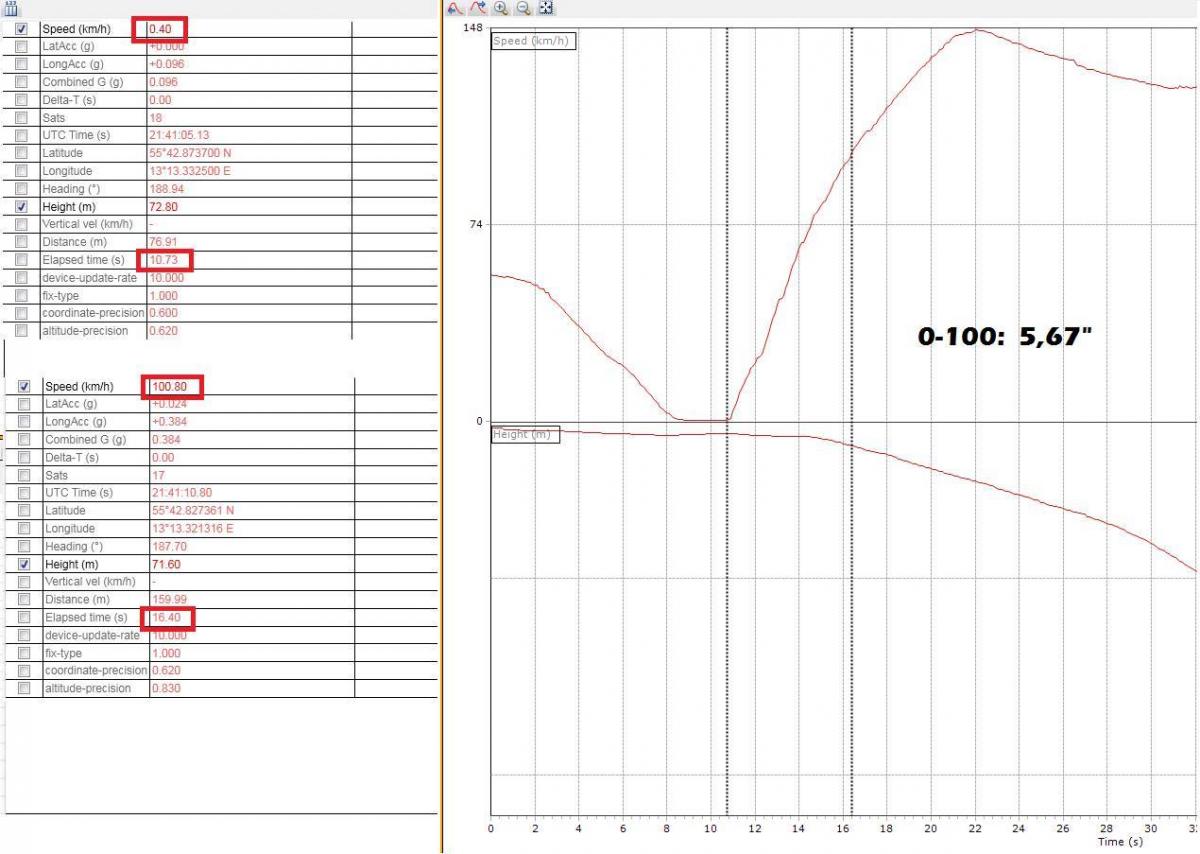

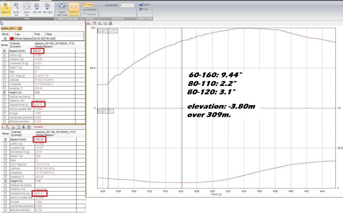

Better grab a 10Hz High-precision GPS receiver and do your own "dynoing" for free every time you feel like it.
By the way, those are a couple of measurements using XGPS160 receiver and RaceChrono. They give a much better idea of what the car can do on the road, especially the in-gear run:
