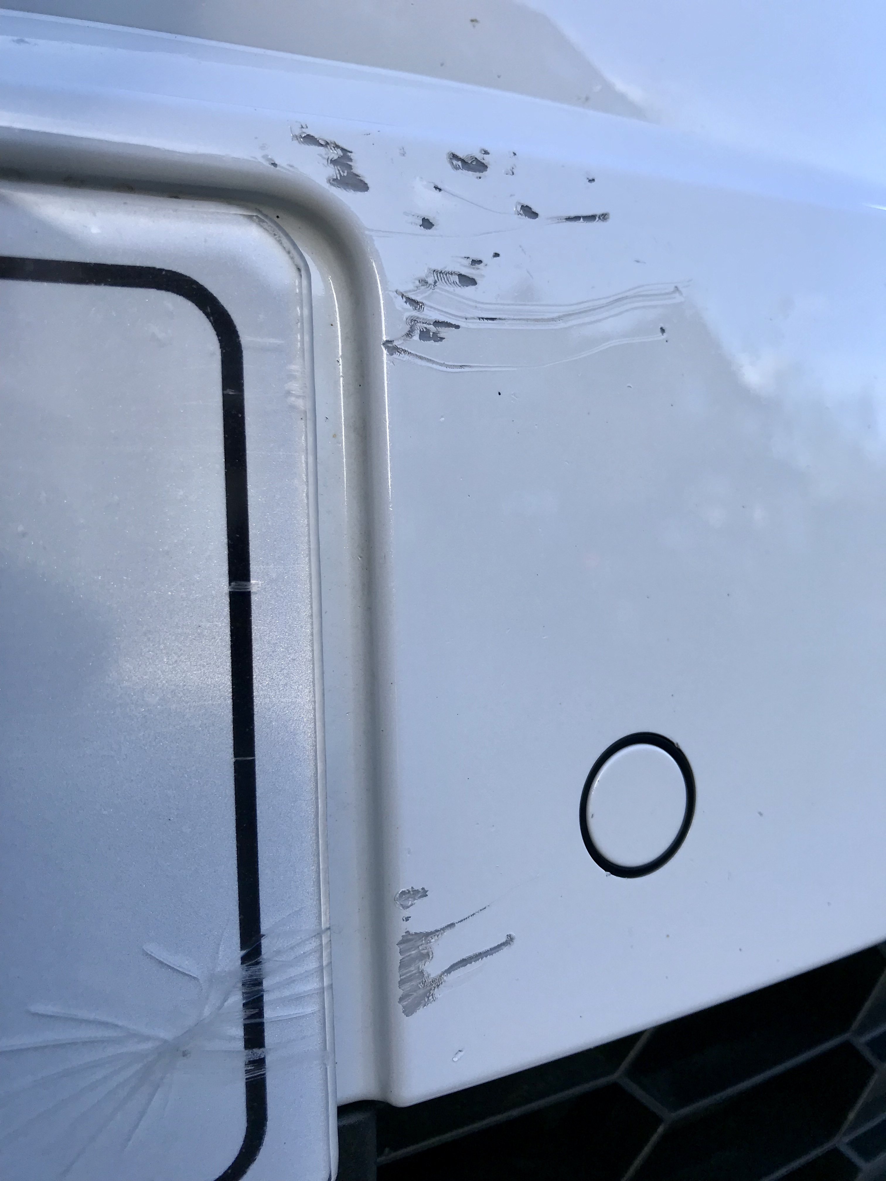

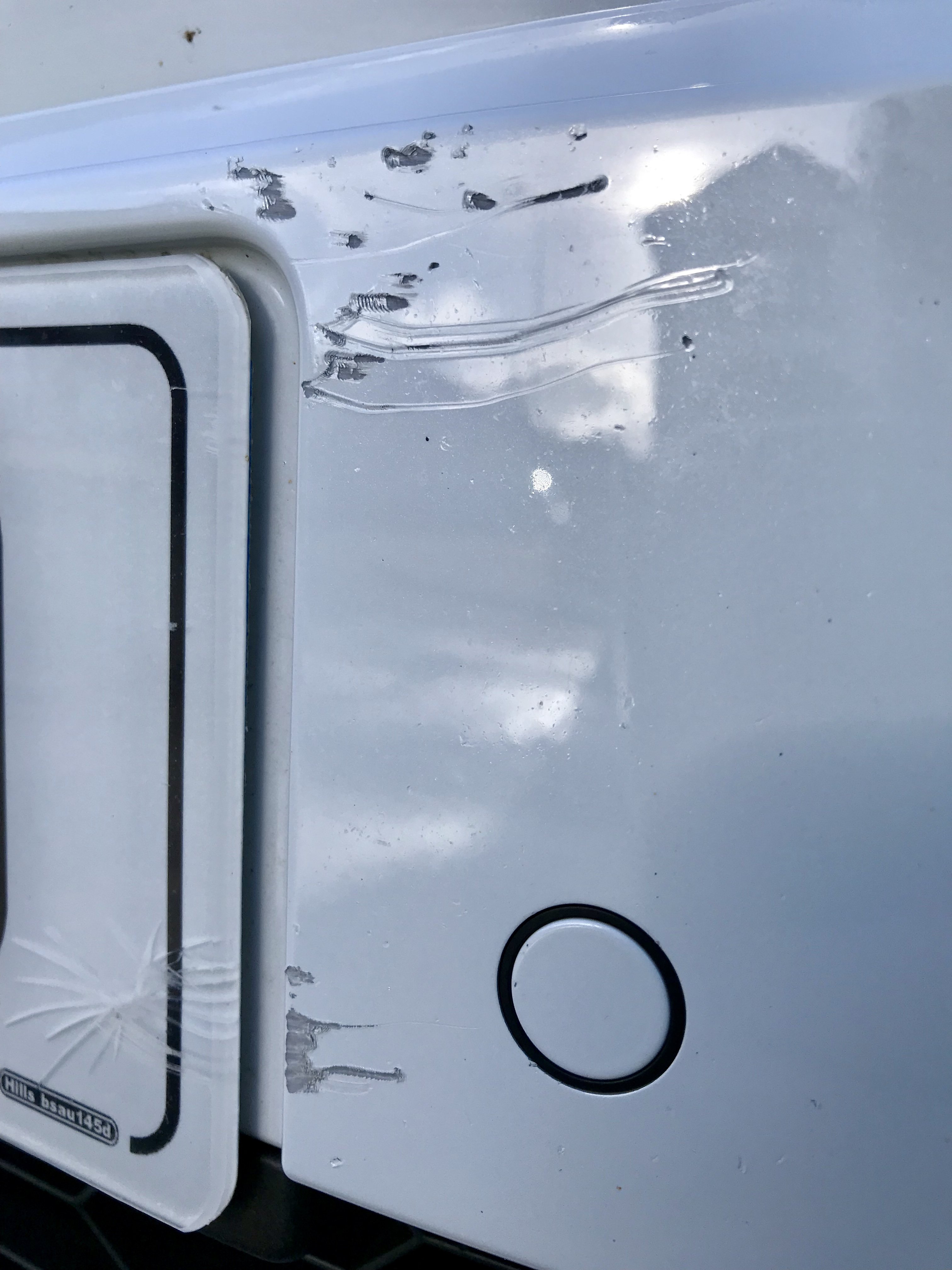

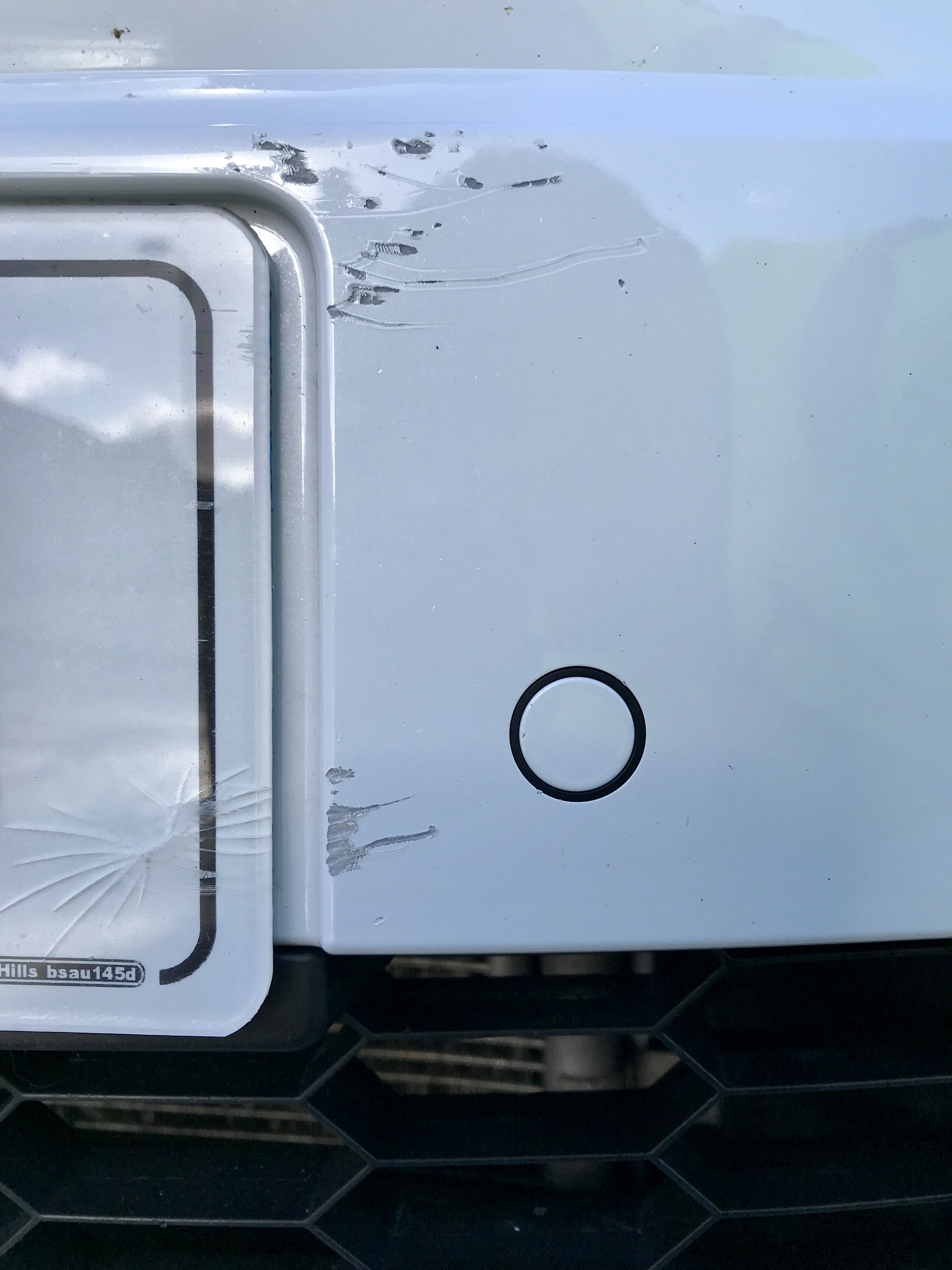

I recently bought a ChipEx kit to repair the damage to my front bumper caused the ONE TIME in three years when I decided to put my car in front facing the house on my driveway rather than reversing on. I misjudged the distance and crunched up against the riven block surrounding our garage.
The Octavia is Moon White metallic as is the replacement Kodiaq I'm getting in a few months so I though that it would be worth getting a kit. I've had a go at it and while it's certainly better (that wouldn't be difficult), I'm not satisfied with the result (yet). The ChipEx formulation seems to be like a combination of filler, quick drying paint and gloss lacquer. I strongly suspect that I'm going to have treat it like a filler and if I can't achieve a decent flat on it, I'll get a rattle can of Moon White and do it the traditional way.
It's a lease hire vehicle so some sort of repair was necessary to avoid a surcharge. I debated with just calling a local repairer then thought I'd take a punt on the ChipEx because I was curious about it.
The jury's out on it so far. I think it would benefit if the surface was horizontal but clearly that's not going to be possible for most in situ panel repairs. Hmm.
