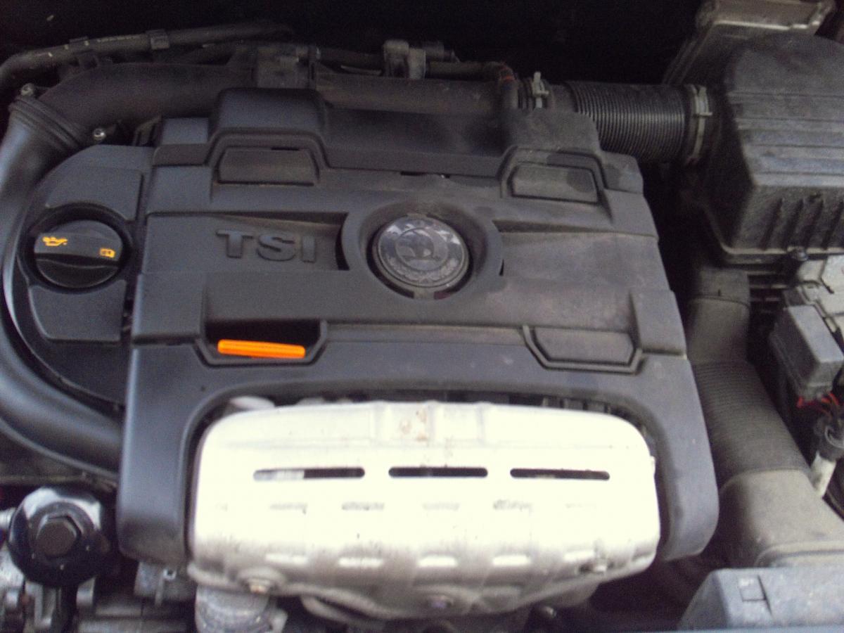

Oil Spray Jet (Squirters) Replacement 1.4 TSI / TFSI 132 - 136 kw Twincharger.
But you came on here to ask about doing oil changes and had not noticed that if you open the bonnet the Oil Filter is just sitting there at the top of the engine.
The Engine is just like all other 1.4 TSI ones, (the difference is a Supercharger at the rear and you are not touching that)
same way of Oil Changes and Spark Plug Changes, so no Mysteries for a Mechanic to work on for a service.
Same Tyres, Brakes, Steering, Door Hinges, Wiper Blades, Oil & Filter, Air Filter, Pollen Filter, even checking the Diagnostics for those that have the Equipment.
Plenty of Independents are VWG Trained, Licensed and even able to do Warranty Work.
