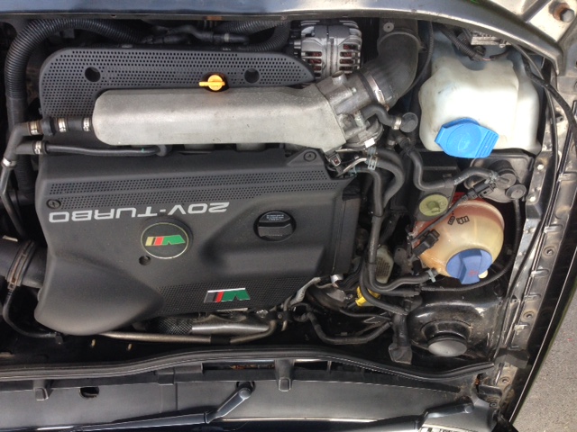

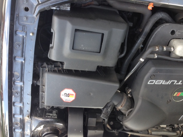

Hi guys,
I've never detailed an engine bay before, but mine is getting a bit mucky and with the nice weather I thought I'd give it a go.
I've read a couple of threads but never had any pics. I'm quite a car novice so wondering if anybody could give some ideas of what areas I would need to cover with tin foil?
The lady in question is a Octavia RS Mk.1
Would find it really useful if anybody can takes the pics I've attached and highlight it or put a red border around those areas in MS Paint or something?
thanks in advance!!
YSpost-120617-0-16850000-1436182927_thumb.jpgpost-120617-0-43766600-1436182927_thumb.jpg
I woldnt use tin foil, personally i'd use plastic carrier bags for the battery mainly.  If you can try avoid using hose/pressure washer.  Get a spray bottle and a 'detailing brush' then work it in with that leave it for a bit then wipe up.
I use plastic bags too. Just wrap any electrics, and don't use any high pressured jet washers.
Have a warm engine (not hot), wrap electrics, wet engine bay ( I use the shower function on my hose pipe head), spray with APC and agitate with a brush, rinse with same hose pipe head and that's the job done.
Remember, engine bays are dssigned to get wet, so don't worry too much, but at the same time don't go ballistic in there. Avoid electics, no pressure washers and light aggitation with a detailing brush.
This is just my opinion of course. Some people happily use pressure washers in there, but you risk compromising protective surface finishes, electrical and mechanical seals and forcing moisture into places where it can cause corrosion and ultimately component failure. As with all things, each to thier own.
HTH

I just use Megs APC buddy, diluted at 10:1. I don't spray onto moving engine parts, especially degreasers, which will strip the lubrication away in there and cause issues. An engine bay should be a greasy area of the car, so I just clean the plastics and paintwork really. Just keep sit looking nice yet preserves the life of the components in there. I dress with Aerospace 303 Protectant.

10mins will freshen up a cleanish engine bay but if a previous owner has never touched it then they can be royally manky and take some cleaning. Thankfully yours looks like it will clean up pretty easily

I just used to cover the MAF and Throttle body and use the hose on a weak setting, with AG degreaser and AG vinyl and rubber cleaner, never had problem that way.
But don't go mad with the hose.
