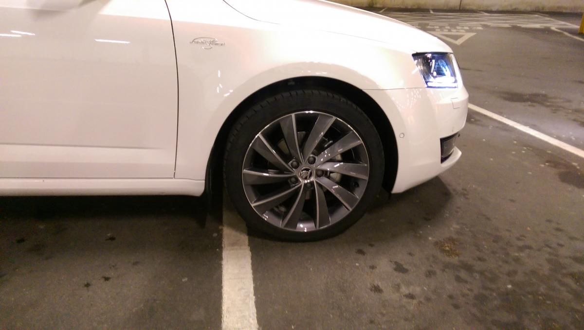

Hello folks, we've just traded( up??) from a much loved 09 Octavia 2 Estate, to a very low mileage 2015 L&K estate, all very nice, an ex Skoda UK Management car, it even has bells and whistles on the bells and whistles.  Dislikes-----compared the the SE Level Octy 2, this one has much less in the way of useful storage boxes and bins, that's inexcusable, but the real "not for us" is those wheels!
So, if anyone fancies a swap.
Our absolutely mint 8,000 mile 18" Wheels with 225-40 R18 Continetal Sport Contract 2 tyres, for your set of 16" Skoda wheels in similarly pristine condition, please let me know.Post or PM.
Robin.

can you post a photo of your wheels so we know what they look like.

I would advise checking the size of your front discs before exchanging for a smaller sized wheel. If your L&K has 312mm diameter front disc then you will need to stick with 18". Also Skoda will not deal with any wheel warranty issues with anything other than your originals. Not sure if you plan to sell privately in the future but you will have a harder time trying to move on a L&K with 16" Wheels.

The vRS needs a 17” wheel to clear the brakes, I think this is the only model that cannot use 16” wheels??
312mm front brakes usually fit inside most 16” wheels

Definitely a good idea to try a 16 on the front to make sure they fit BEFORE you commit to a swap/change.  As mentioned above 16s should fit 312mm Front Brakes but be sure you do have them and not the larger VRS size brakes, I do not know what they fit to the new L&K. Also do the same fit test if you go for 17s, genuine VAG or TUV tested 17s will normally fit the VRS size brakes but some cheaper Far East 17s have thicker bodies and will not fit.

My L&K CR150 DSG has the same brakes as the Elegance O3 I had before, and 16" steels fitted fine for winter use

Thanks for all those replies, the spare is a steel 16", so, for a start, I'll try that on the front to investigate disc clearance.  I'm intending to get a set of 16" steels with winter tyres, so this is all useful stuff, which will help make sure I don't buy the wrong ones.
I'll still change to 16"  "Summer tyres" if I can, for the sake of ride quality if nothing else. (And maybe store the 18" ones 'til I sell the car)

312mm discs will take a 16" wheel.  I present exhibit A:  16x7.5 ET50 on 312mm brakes
The Mk3 VRS rotors are 340mm and have a minimum 17" rim.

So, If I were to go looking for a decent second-hand set of 16"x 6.5J Alloys for this L&K, might I be looking at anything VAG? and does someone know what offset I should be asking for?
5x112_ bolt pcd (VAG from mk5 golf era onwards), some Mercedes.  Offset on Octy iii wheels is et 51, width 7.5j.  You can go inwards 5mm easy and out 15 or 20mm.  There are web sites that have lists/calculators to help you find wheels to fit from other cars
Most VAG wheels will fit, but some also use 5x100 PCD (you need 5x112) and some of the newer Audi’s use a 66.6mm centre bore whereas your car is 57.1mm
ET, stick between 45 - 50 mm and you will be fine.

I've run 66.6mm centrebore  A4 wheels  on my last 2 sets.  I simply run 66.6 - 57.1mm hub centric rings.  They are fairly cheap - about AUD20 a set (GBP10).
