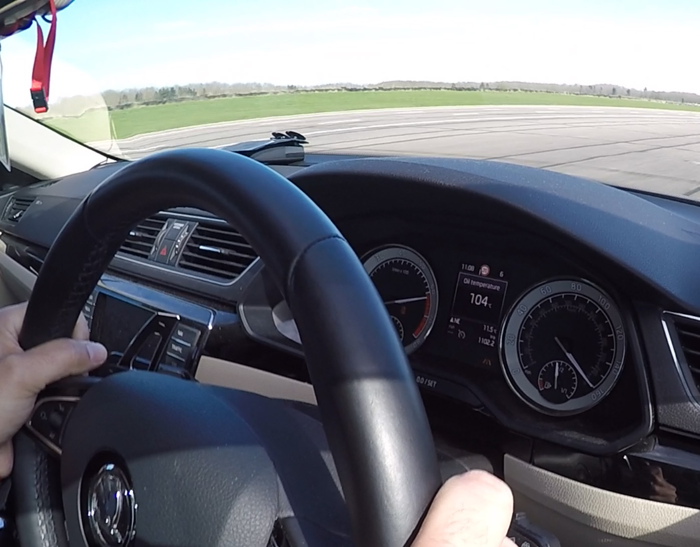

10 hours ago, superbtte said:
Bruntingthorpe
285km/h (GPS corrected, would have been showing 300 on the speedo if it could show that much!)
with more possible before the runway run out (approx 1.2 miles before I had to start braking) :)
I estimate the final speed to be just over 300km/h (GPS measured)
What tyres and pressures are you using for these runs?

Michelin super sports. Standard pressures.

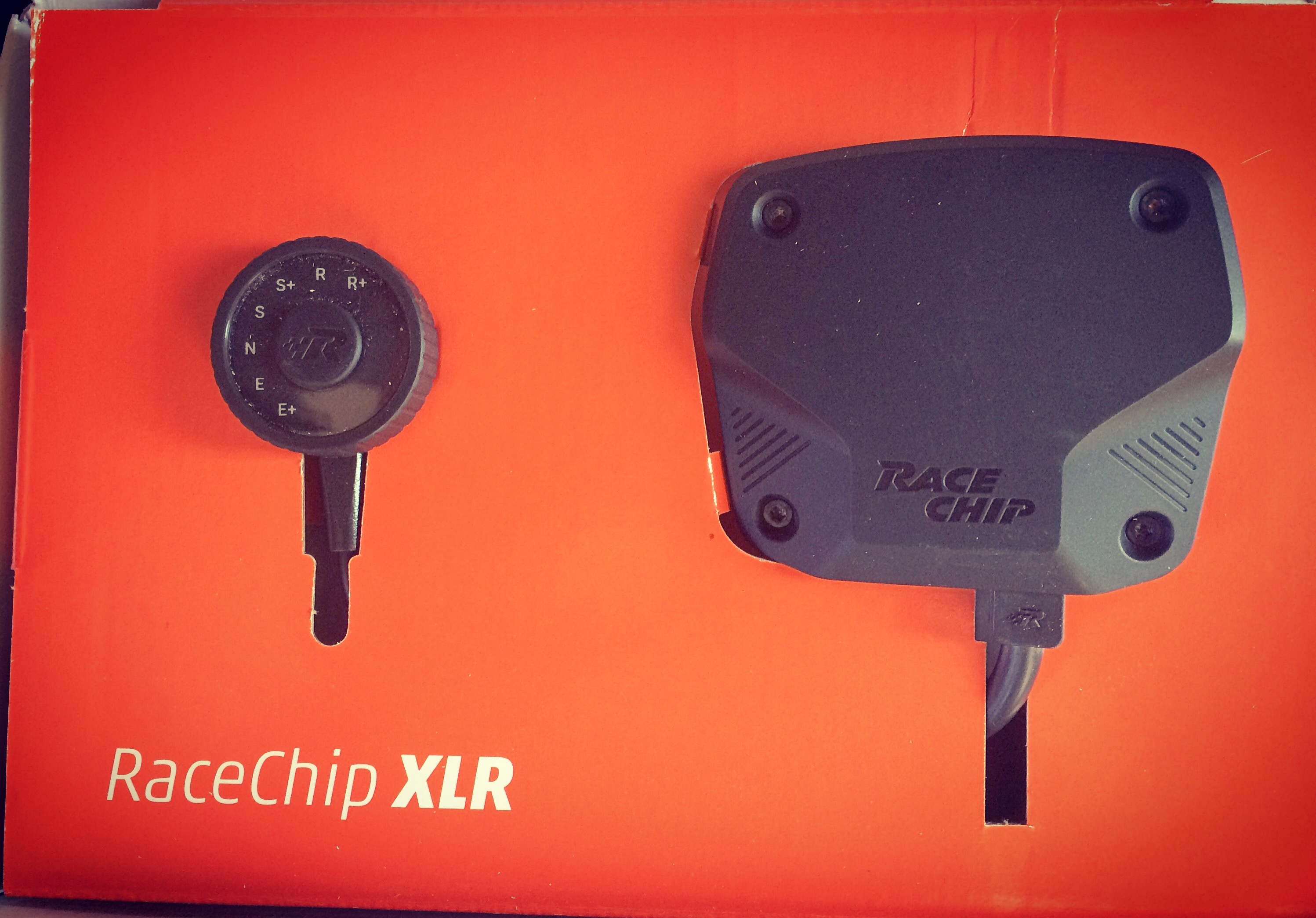

I was a bit of a doubter when it came to the RaceChip claims but blimey if there is only one mod you buy for your 280 this is it!
It transforms the car into something it should have been out of the factory.
It's not bad but if people are getting something now the new JB4 is so much better. I tried most.
You did the "Audi" mod for me which was a slight improvement but this changes the throttle response to another dimension.

@philpix how easy was the XLR to fit?
Easy to fit following the instruction sheets. Well worth the money IMO.

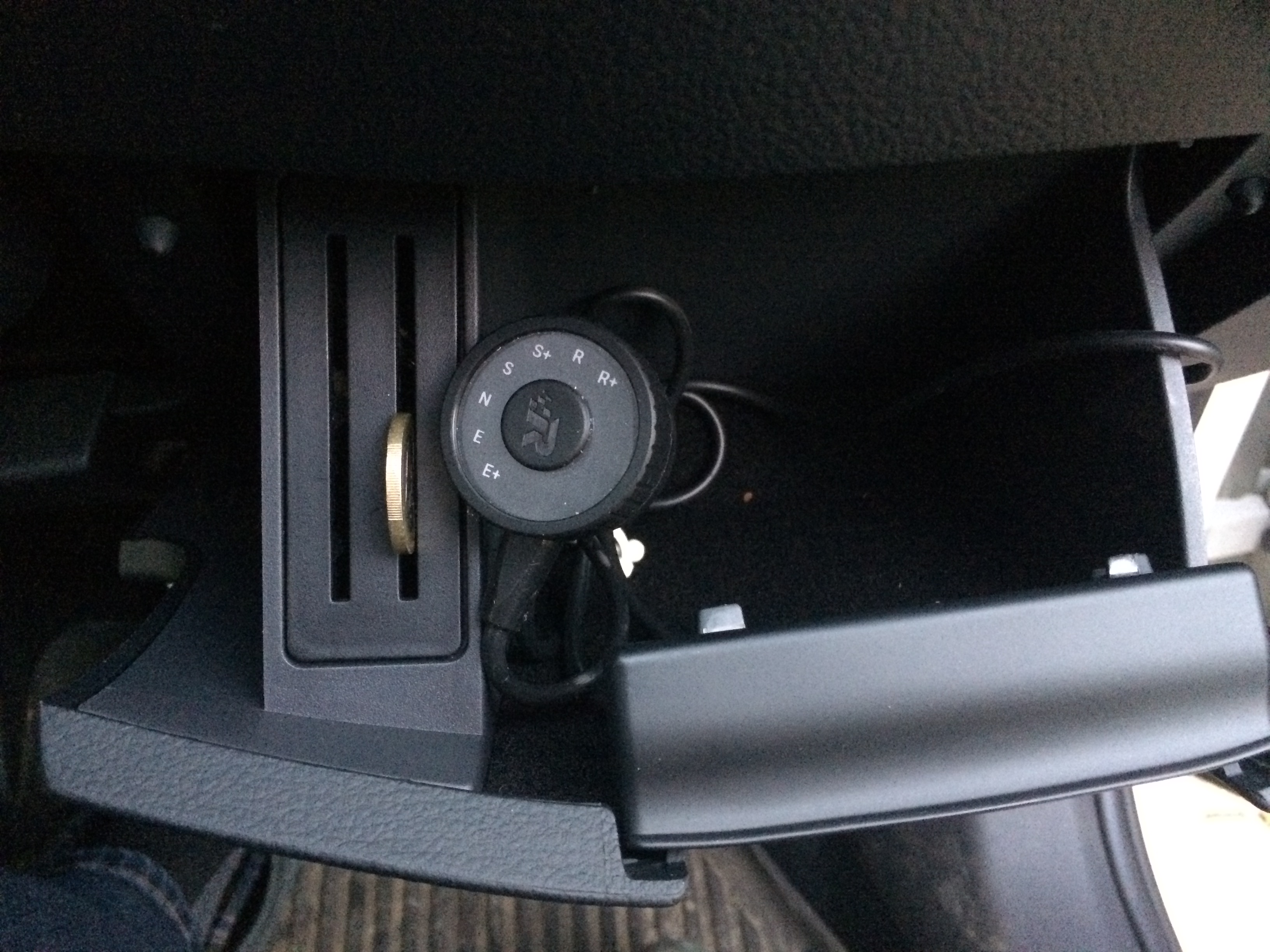

Just fitted my XLR, the same as @philpix A huge improvement. The car is now how it should have been when it left the factory. I mounted it the same as Phil but I am sure I will move it as I don't like it in that box. Just need to take a look and work out where to route the cable.
One question, the light stays on when the ignition is off. I have asked Phil if his does the same as only person I know with an XLR, but does the older Throttle Response also keep the light on, does it not power off when the car is off?
48 minutes ago, hpoom said:
...does the older Throttle Response also keep the light on, does it not power off when the car is off?
The older one is door rather than ignition dependent. The LED comes on when you unlock/open the door. If you don't do anything for about 10-15 seconds it turns off.  Turn on the ignition and it remains on. When you then turn ignition off it remains on until you close and lock the door.
There was a 'press and hold' type of option to alter it but 1. I can't recall what it was and 2. I didn't care what it was because I was happy with how it functions.

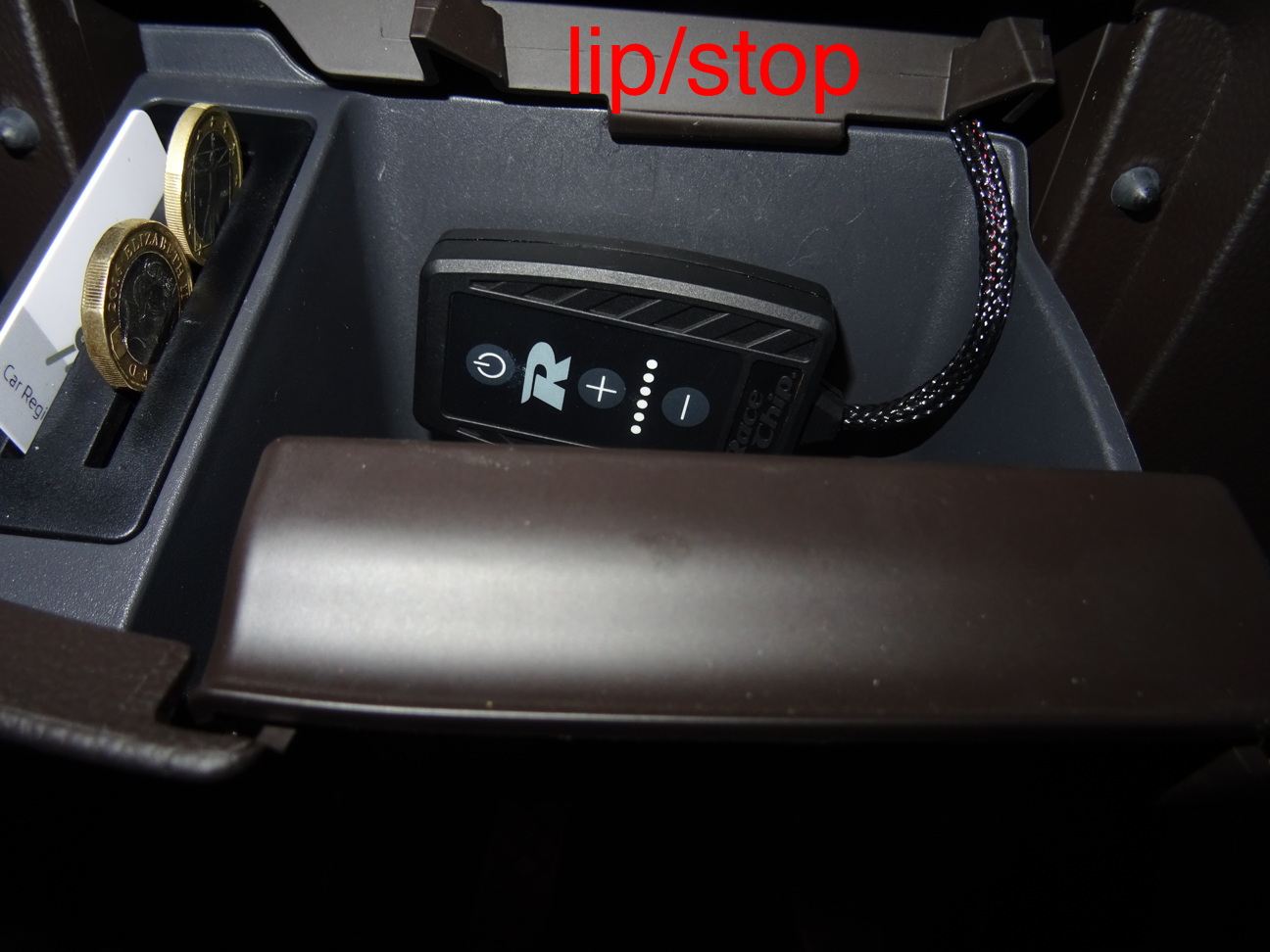

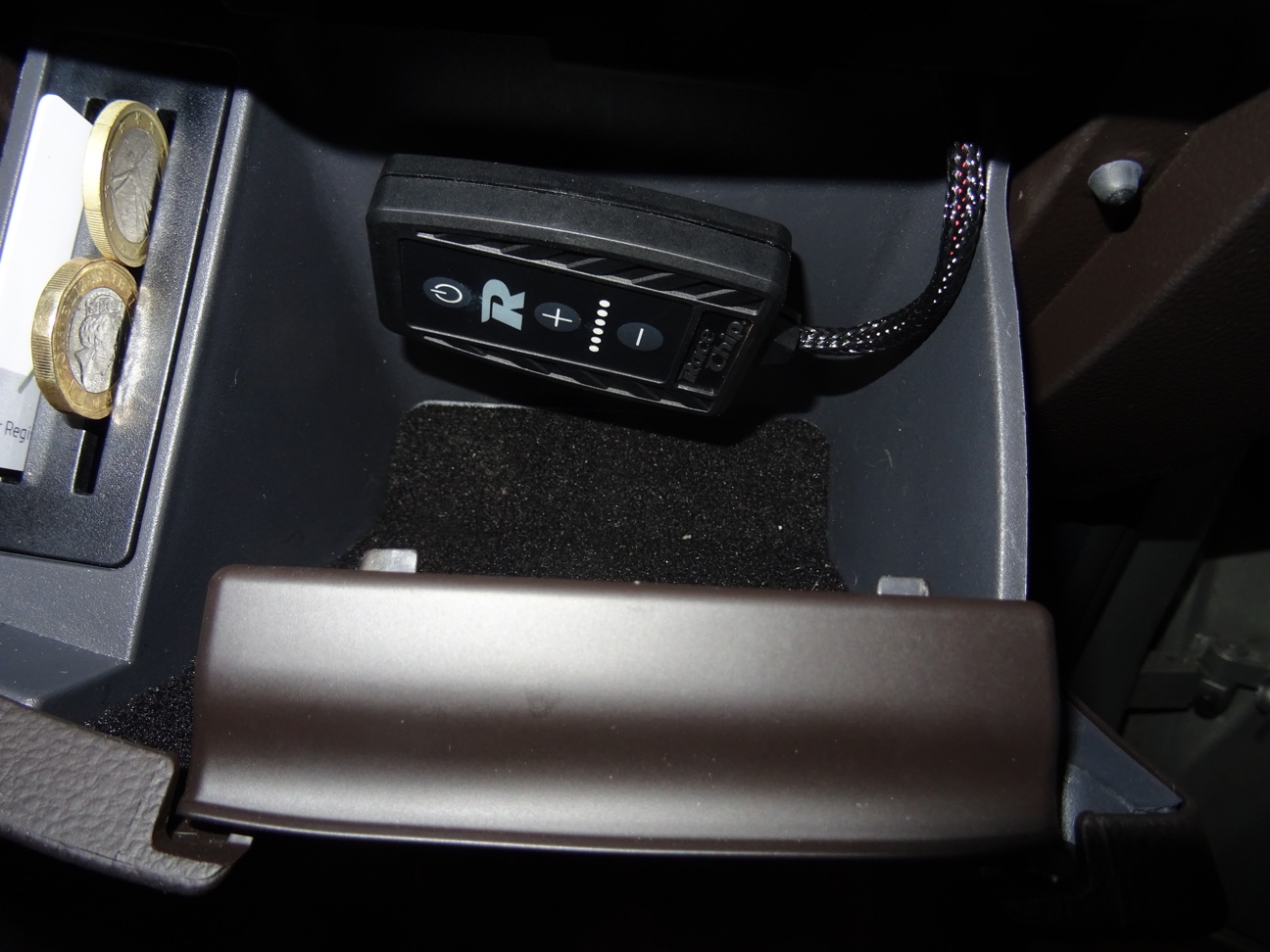

Just thinking out loud here...
If you've done it the way @philpix has shown it in his picture, feeding the cable in from the side, then IMHO that's an untidy method quite likely to interfere with the functionality of the tray.
There is a plastic lip at the top of the aperture that holds the tray and it acts as a stop that prevents the tray falling completely open. You can gently ease the box past the stop/lip and thus allow it to fully open.
With the tray fully open you can feed the controller with attached cable from behind rather than the side and, when you've just as gently pushed the tray back into position back beyond the stop/lip, it doesn't interfere with the opening and closing.
There's a big enough gap at the rear right corner for the cable to feed through without fouling.
As per BillyJim, my install is pretty much identical to this.

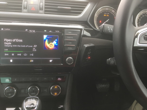

@U241170 I can't give you a definitive answer. As you state that you're 'very concerned' you should put that question to your dealer rather than a forum of owners. After all, if you needed to make a warranty claim it would be the dealer sorting it, not us.
Mine came about as a result of a conversation with my dealer about chipping and warranty which led to my fitting a tuning box (suggested by dealer) and the Throttle Response.
The car has been back to the dealer for servicing with both fitted and in plain view** and it didn't raise any questions, but then again I wasn't having any warranty work done.
** My Throttle Response controller was originally mounted next to the Columbus as shown below and I only recently moved it to the cubbyhole, not to hide it but rather because during the recent {and brief} warm weather the glue of the velcro pad had become soft and was no longer supporting the weight of the unit.
