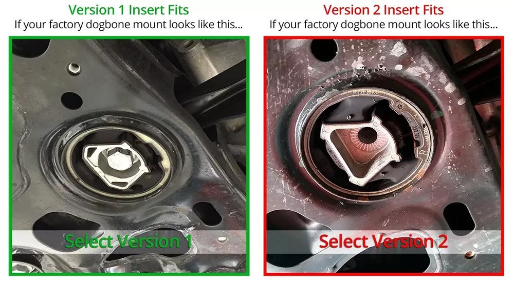

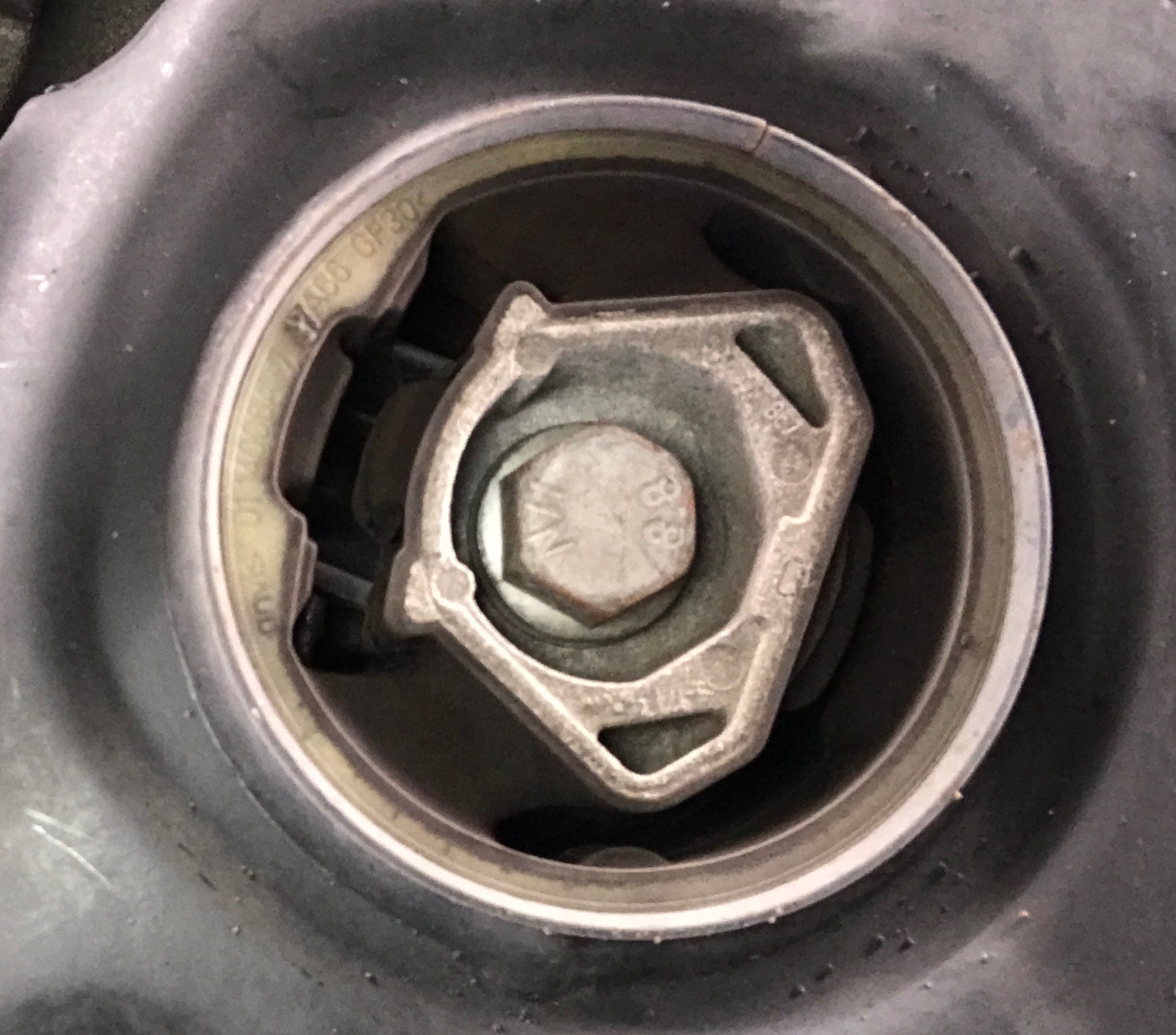

Just a heads-up on the DSG mount Dogbone insert that has been mentioned in other places like the 220 thread.
If you're contemplating it then you need the Version 1, not the Version 2 mentioned elsewhere. This is my mounting so I assume it'll be the same for all 280.
From the AwesomeGTI web site...
For those who are wondering WTF, it's an insert that stops the DSG mount causing 'clunking' on gear changes induced by tiny movement of the gearbox.
I've had no problem with the DSG mount on mine despite upping the power so I haven't fitted one myself yet but may do so as a 'just in case' precaution.
It is well worth checking which mount you have then, I know Alex has one of the 1st S3s and mine was built in November 2015, this is my mount (Version 2)
The difference may be because we have different engines (mine is a 190 TDi) or maybe they were changed just before November??

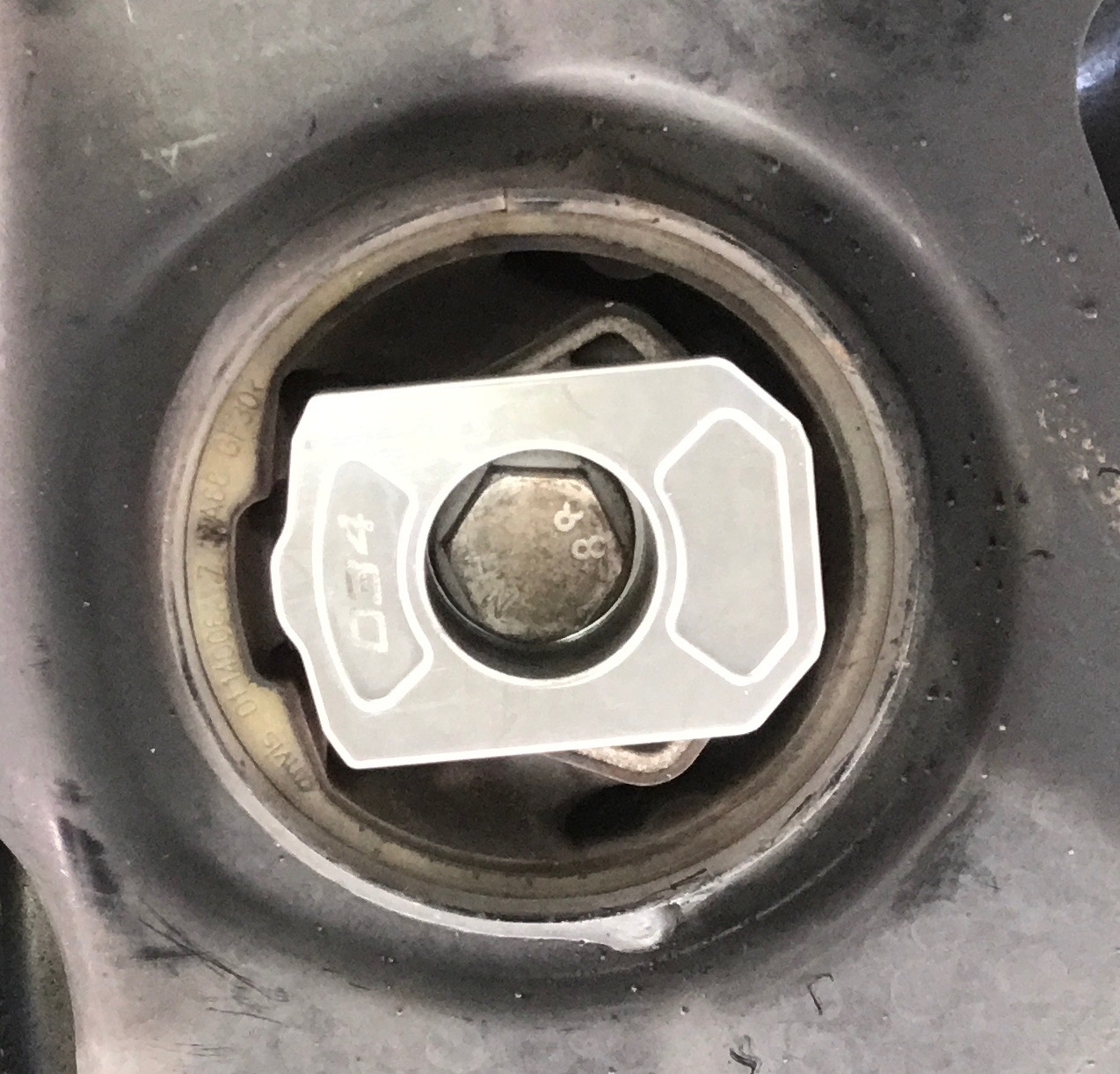

@Gizmo68 - time for me to eat humble pie. :sadsmile: You were right on the money about the DSG Dogbone Mount insert, if not the actual version.
I'd assumed the feeling of the DSG snatching gears after fitting the RaceChip Ultimate, and then only when under the harshest acceleration, wasn't related to the same thing you described after remapping your 190.
I finally got around to ordering the correct version of the DSG Dogbone Mount Insert and fitted it today and I was proved wrong (not the first time that's ever happened!).
£50 for a small bit of aluminium, then 5 minutes with a 21mm socket and it was job done. Would have been quicker but I had to find a socket that would fit inside the billet.
I headed for the derestricted roads of the countryside to try it out but first I had to negotiate the urban 20, 30 and 40 limits. From the start I thought it was a placebo effect that driving 'normally' seemed much smoother. It then dawned on me that I hadn't actually heard or felt a single gear change and I had to regularly check the maxi dot to see it indicate the gear changes.
On the thankfully almost empty country roads I put it to the real test. Kick Down (still amazed how it gets from 30 to 100 mph in just a couple of seconds), Launch Control, rapidly flicking between drive/sport/manual - quite simply I totally abused the DSG and never once did it kick, clunk, snatch or fart. It remained consistently smooth as silk.
From the outset I was sceptical and wasn't expecting much but it's proven to be the second best thing I've fitted to the car (the RaceChip Response Control still sits at the top of that list). I can highly recommend it.
Glad you have come to the same conclusion as I did Alex :thumbup:

So which version of the dogbone mount should we get for the 280? Also what is the torque spec for the bolt?
My own MY2016 (Sep 2015) was version 1. Check yours before ordering one. I slid a camera phone underneath from the front of the car.
100 Nm 130 Nm.
