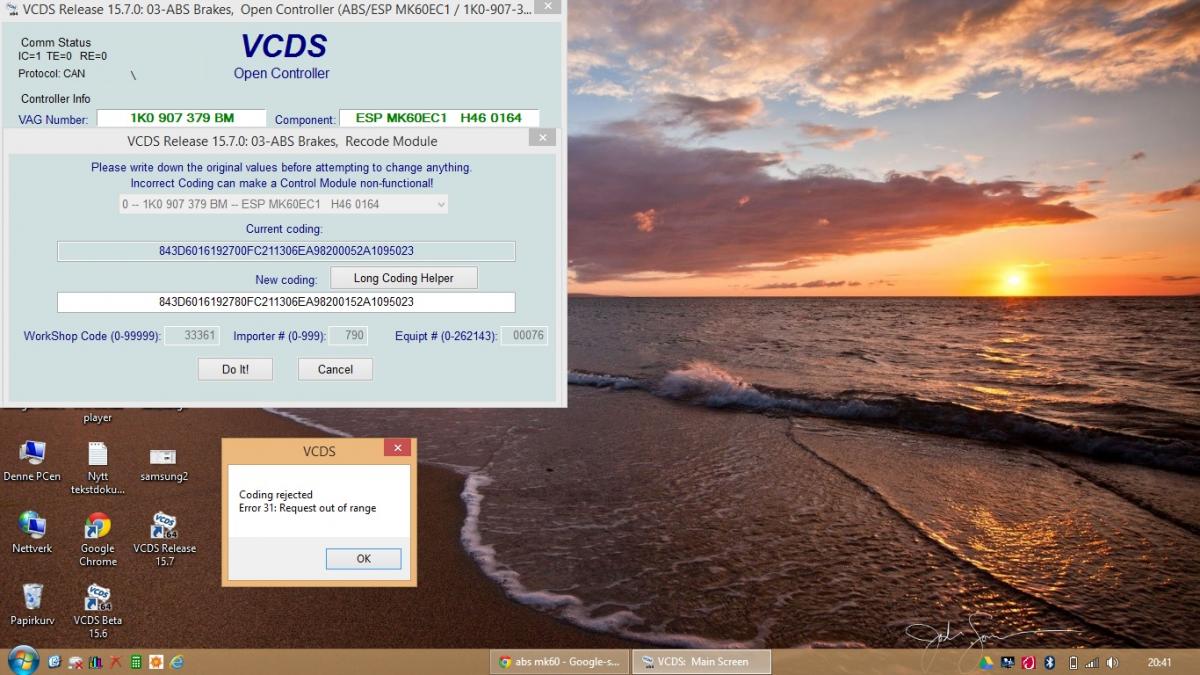

Have you tried: 843D6016192780FC211306EA98200152A1095023
Looks like your module has an extra byte, so I removed it, ran the script, added it back on.
I tried now....
Code out of request :( :( :(
