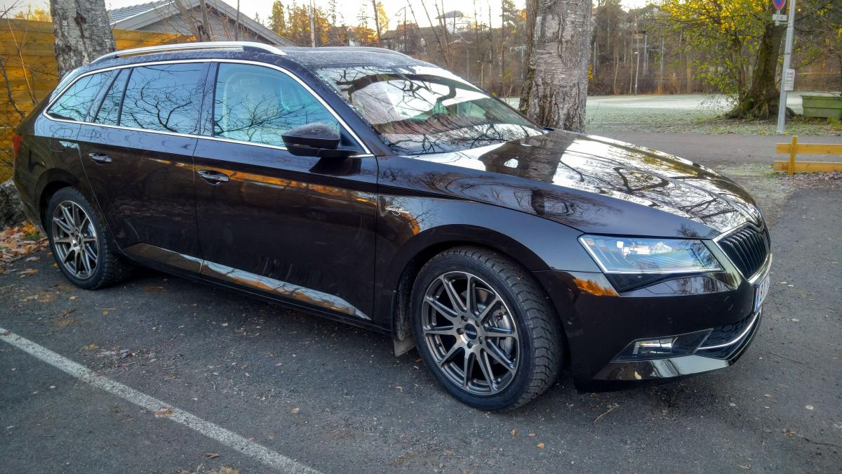

Nokian Hakkapeliitta R2 235/45R18 studless winter tyres
on
Monaco Pole Position Gun Metal Polished rims
Received the car yesterday, and changed to winter tyres since snow is forecast for Oslo tomorrow.
All I need now are Skoda badges for the center hole, since the original badges are too small in diameter.

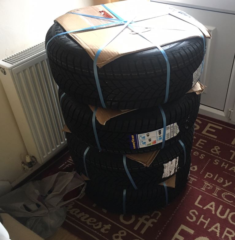

Set of winters just delivered from Mr Winter wheels, £556 for 16" steel wheels & 215/60 x 16 Goodyear UltraGrip tyres (also get £50 John Lewis voucher for these tyres) :happy:
Edited by Q102
