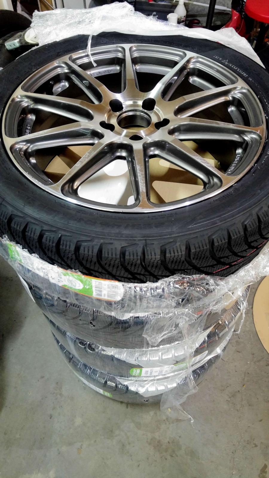

Nokian Hakkapeliitta R2 235/45R18 studless winter tyres
on
Monaco Pole Position Gun Metal Polished rims
And they have arrived! :-)
Now all I need is a car... Shouldn't take more than 3 weeks, it's supposed to come out of the factory later this week.
on
They look lovely, don't take this the wrong way, won't a polished finish get hammered by the winter salt and grit?
Maybe, but I have a habit of washing my cars several times each week with a pressure washer, especially during winter to rinse of salt and other dirt.
But I'll just have to see how it goes :-)
