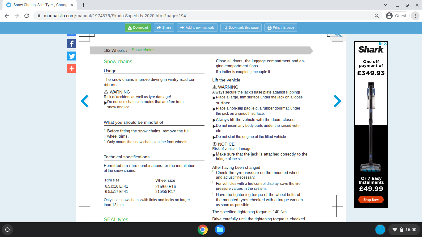

@CageyH   Does your owners manual not show the same as this?
Yes, but I have seen that 16” wheels cannot be fitted to an IV, so I guess that leaves me with one option…
17” wheels….

This is in the manual for the Superb iV 2020.
17" wheels are only needed if you have the massive 340mm diameter front discs, as 16" wheels won't clear the brake calipers on those.
Technical specifications
Permitted rim / tire combinations for the installation of the snow chains.
Rim size
Wheel size
6.5Jx16 ET41
215/60 R16
6.5Jx17 ET41
215/55 R17
Only use snow chains with links and locks no larger than 13 mm.

Just looked in the obvious place.
16" wheels may fit (although they dot appear as an option on the IV) but they do not appear homologated for use.20211014_184435.thumb.jpg.564d9f96fa3d3456c18b8635c1c3d45d.jpg
