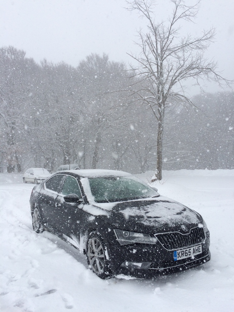

  • Scudo wheels and Pirelli Sottozero rubber worth their weight in gold down here in the Pyrenees. Sent from my iPhone using Tapatalk

Scudo wheels and Pirelli Sottozero rubber worth their weight in gold down here in the Pyrenees.post-137812-14555751423453_thumb.jpg
