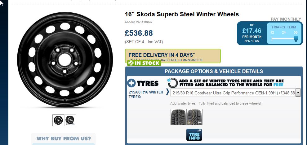

Looking at a few websites as we are driving to Austria, via Germany in February so need Winter tyres.
A good deal seems to be had at www.mrwinterwheels.co.uk. Quite happy with steel wheels.
They also do a set of 17" alloys but these use 17 x 8 alloys and 225/50 tyres, so I'm not sure if I could fit them
Edited by Q102
Mine are 225/55/17” (on a 9” rim) and there are no problems with them.
It looks like I'll be looking at steelies and some fat tyres then. Mr winterwheels wouldn't let me add tyres to the steelie (which is annoying) but know the Continental winter tyres come in at around £125 each. Might try Nokian this time as their write ups are always good.

I've been told by Skoda that my Superb Estate L&K, which has 18" wheels can either have 215/55 R17 94W on 6.5Jx17ET41 rims OR 215/60 R16 95V on 6.5Jx16ET41 rims.
I'm opting for the 17" wheels with Michelin Cross Climate tyres.
Any comments and advice would be appreciated.
Does anybody know what pressure should be used?
In Norway where it is a lot of ice and snow, my dealer did not recomend 16". Because the space between the wheel and breaks are too small. It get packed with snow.
When the snow hit the warm rim it melt and then freeses to ice. It get packed and the breaks will not work very good.
You will also get imbalance in the wheel.

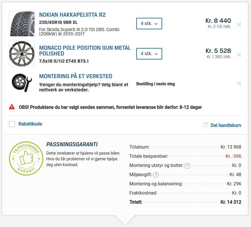

Could someone confirm that these wheels will fit my (coming) 2017 Superb Estate 2.0 TDI 4x4 190bhp?
Edited by grenness
