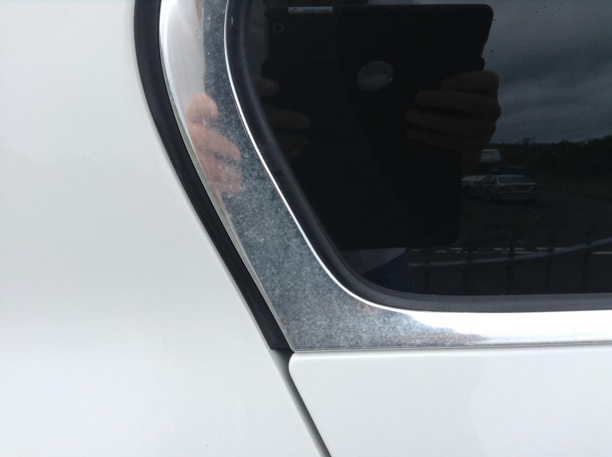

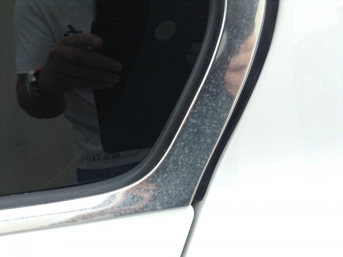

anyone got problems with the trim around the rear quarter window on mk11superb any way of cleaning
Looks like plastic coated chrome
The only solution is replacement
Mine had it at six months old. It is water penetrating the laquer.

Sadly that is the only way to go if you want the same (replacement) - the chrome finish is electro-somthing-or-other applied to the plastic trim.
Otherwise, you could get the trim 'dipped' or 'coated' or simply paint them a color of choice. One of the threads in the 'Superb Projects' features this. I'll see if I can dig it out.
Edited to add: Here you go - http://www.briskoda.net/forums/topic/314532-black-36-v6-estate/

Thanx for info. Really lets car down as it is
Autosol for plastic chrome will tidy it up a bit and get rid of the surface marks (it's basically a very fine cutting paste), but you'll still see all of the marks where it has penetrated.

Common issue and has come up on these threads a few times.  Is it still under warranty?
Given the numbers of people this does affect, we're really lucky that our 2011 Superb doesn't show any signs of this. Could just be a matter of time though I guess. Pretty poor quality control from their supplier it seems sl SUK really should replace under warranty, even if it is cosmetic; this isn't a "consumable" so should last the lifetime of the car....
I tried to get it swapped out under warranty at the same time that they replaced the front and rear badges.
They replaced the badges, but they said that the chrome window surround had become tarnished due to external influences (ie they said that I was using the wrong car shampoo).
I couldn't be bothered to argue with them, as I only ever noticed it when I was washing the car anyway.
