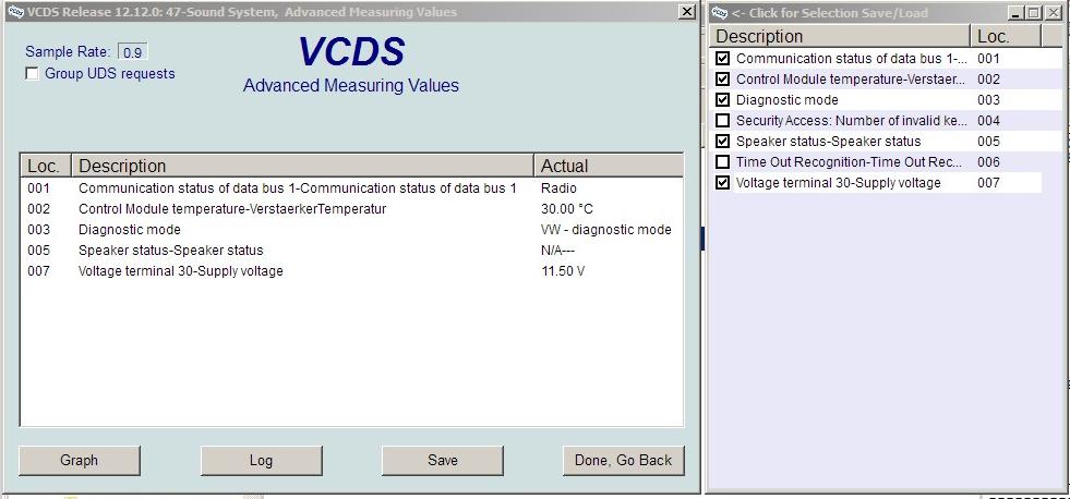

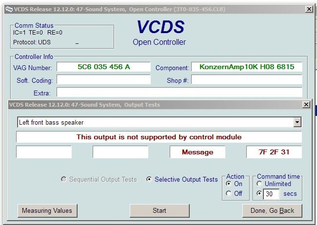

I was trying to get the sound back this afternoon and noticed that the sound system is unable to address the speakers.

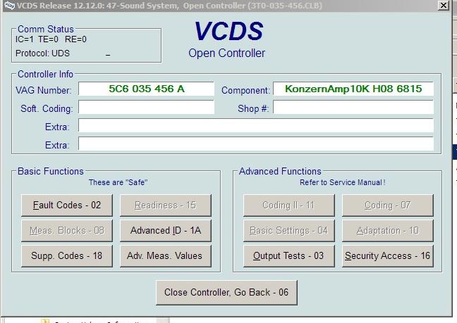

I also do not have any coding 07 and adaptation 10 options. Is this normal?

Your VCDS version is pretty old, I'd start by updating that.
If it's V 12.12 then I suspect it's a stolen / hacked software version running on a clone cable. Personally, I prefer to use the genuine version then if I need any assistance then I can be sure it'll be forthcoming.

Has anyone come across the problem of speakers not being addressable before?
