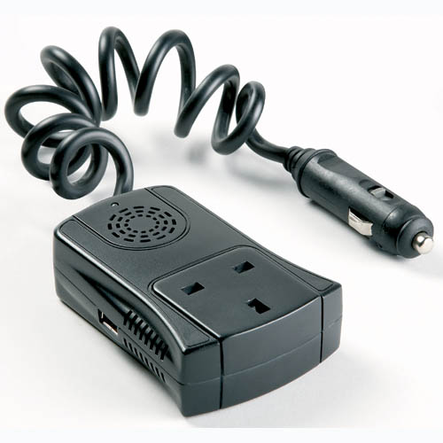

As someone whose flat battery consistently fails to act as a reminder to unplug devices from the permanent feed 12v sockets, the low power cut-off (10.5v) was a must-have.
On my Superb II it only just fits into the front 12v socket - that's due to its width, not the height (the rear 12v socket being no problem at all, though that may not be the case on the Superb III).
I did also buy a 2m socket extension lead at the same time, "just in case".
It arrived this morning and I've now tested it with my MacBook Air. As the laptop battery wasn't fully charged I expected it would draw more current for charging.
Well, it works a treat, with or without the engine running. Checked the laptop stats and it was drawing a consistent 35 watts.
The inverter has a cooling fan but it emitted just a gentle hum.
So on it's first trial I'm pleased with it.
With a 3-pin plug inserted the USB port remains unobstructed.

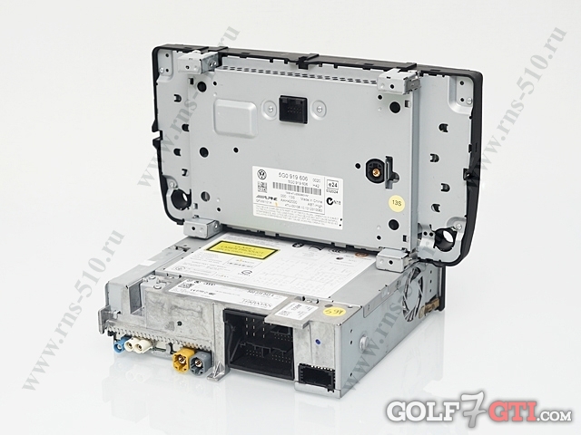

Fitting a second USB input to the Columbus (Discover Nav) should not be as daunting as I originally envisaged.
The "gubbins" are all fed to the unit in the glovebox with a single lead connecting it to the head unit, so no need to touch the display unit.
Fitting a 2nd USB socket in the glovebox for the hard drive, where the controller lives, should involve minimal trim-molesting.
I hope the unit that comes in my car will have the same sticker showing the pin connections as I've failed to find any info on the internet.
If anyone comes across the wiring info please let me know. (A simple USB socket was too much to hope for!)
It also appears that the control unit is made by Harman and the head unit Alpine.
Car manufacturers tend to source from various electronics manufacturers, so don't assume it will be the same in your Superb III.
Have you come across any more info on what is on the rear of the Columbus?
I am looking into a discreet hidden Dash cam kit which has the option of displaying the cameras view on the cars head unit (via AV out connections) I assume the Columbus will have some sort of AV in for the optional reversing camera??
No further update.
Info on the actual connections is scarcer than rocking horse manure.
Everything goes into the glove box control unit with a single 10-pin connection to the screen unit.
There appear to be no "standard" input connections, like AV, USB, etc, instead there's a whole bunch of multi-pin connectors.
Looks like I'll need to wait until I get my car and can have a look at the control unit in the raw.
