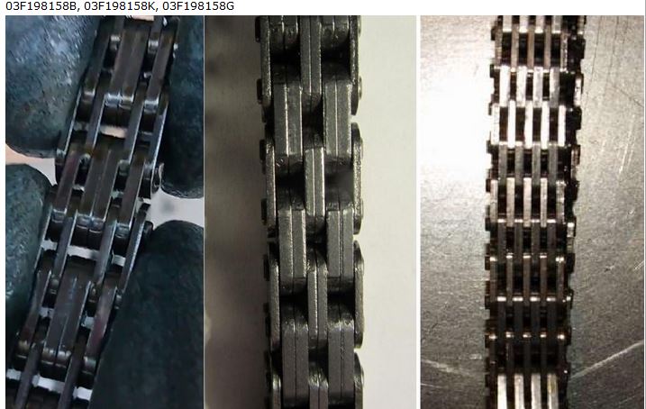

Here is my 2 pence worth on the cam chain issue.
The 1.4TSI chains certainly suffered from manufacturing issues caused by a VAG sub-contractor using a die stamping machine which was outside of acceptable engineering tolerances. But the cam chain issue on the 1.2TSI is not caused by this (according to VAG). It is probably a (not admitted) design fault and, like all TSI cam chain problems on engines of varying sizes, may be worsened by issues connected the oil grade/quality.
VAG have openly admitted (most) of this and I’m surprised that it has not been more widely reported in the UK. I refer you to the article from the German magazine Autobild.  The article is at (non German speakers will have to fire up Google Translate):
http://www.autobild.de/artikel/vw-tsi-motorschaeden-3393757.html#
Note from the article the extended “goodwill” scheme offered in Germany which appears better than that offered in the UK. In my case I got 70% labour at 5 years on my wife’s 1.2TSI which I was prepared to accept.
My understanding is that the modified 1.2TSI cam chain cover noted in the article (and referred to by others in this thread) is no longer retro fitted due to later chain redesigns making this unnecessary.
The cam chain/crankshaft and camshaft sprockets have undergone several significant design revisions since 2010. This was due to (according to an Italian Audi owners forum) some 1.2TSI chains stretching again even after they had been replaced.
Attached is a photo of the latest chain (on the extreme right of the picture). As can be seen, it is of significantly different design from previous, hence the need to replace the camshaft and crankshaft sprockets when installing the latest repair kit.
For the reference of other owners, the latest repair kit (as of July 2015) comprising chain, both sprockets, tensioner and guides is part number  03F198158B.
