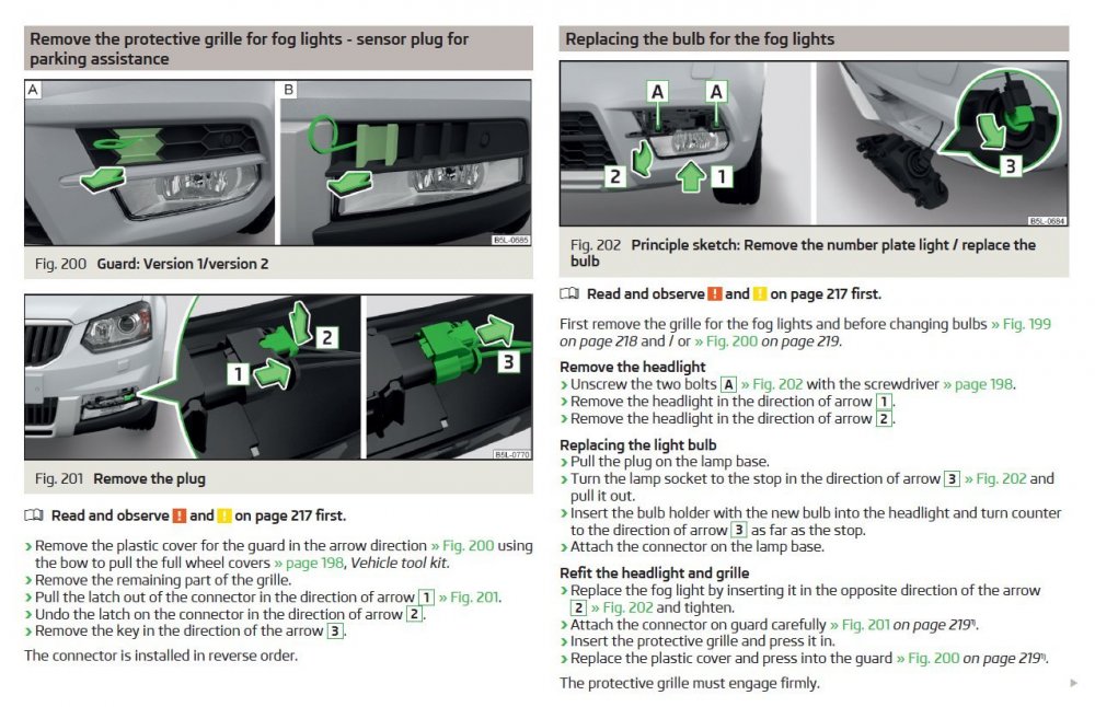

None of the advice actually tells me how to access the bulb on my 67 late Yeti.
Do i have to remove the lamp from the front first like the rear cluster ?
If so how ?

The panel above the light needs to be removed first, do not try that if very cold ad it is tight and could break. A couple of minutes heating with a hairdryer makes it easier.
Then the screw is visible to pull the light out.
