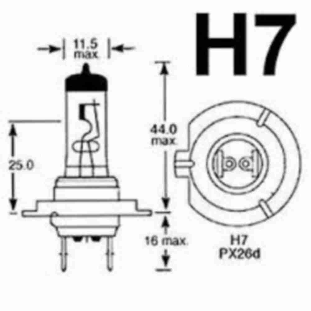

The only problem I have is the new bulb is seated correctly, but the clips aren't fully holding the bulb in place.
Any suggestions/ advice?
Are you sure the bulb is in the correct orientation?
If yes then the clips are broken/bent or the wrong bulb is fitted.
If the clips aren't holding it securely then the bulb is not properly fitted. The normal problem is that the "flat" area of the bulb hasn't been correctly orientated. If you look through the front of the lamp you can just see if it is correct.
3 springs holds the lamp in place. Only problem is to correctly rotate the lamp to fit the holder.
Coincidentally I fitted 1 of these for a customer about half an hour ago. As 175GDY says, the correct bulb orientation is crucial. You can see in his pic that there is a rebate at about 2oclock: the tab on the bulb needs to be located in this then with a wee bit of pressure the bulb will click into place.
As in the picture on the left in post 14 of this thread
If the bulb isn't correctly seated, the fog light may dazzle other drivers.
