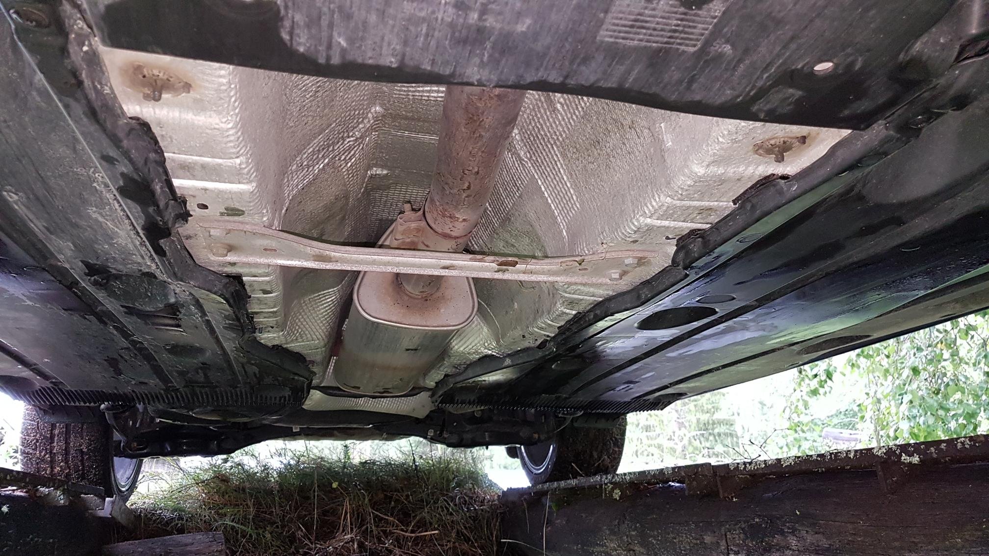

Found it! The damn heat shield under the car was vibrating and ringing like a cymbal. Simply bent it here and there plus put some dampening material between the plastic covers and metallic heat shield. Yay! No more ringing! Just drove 1200km with a big smile!

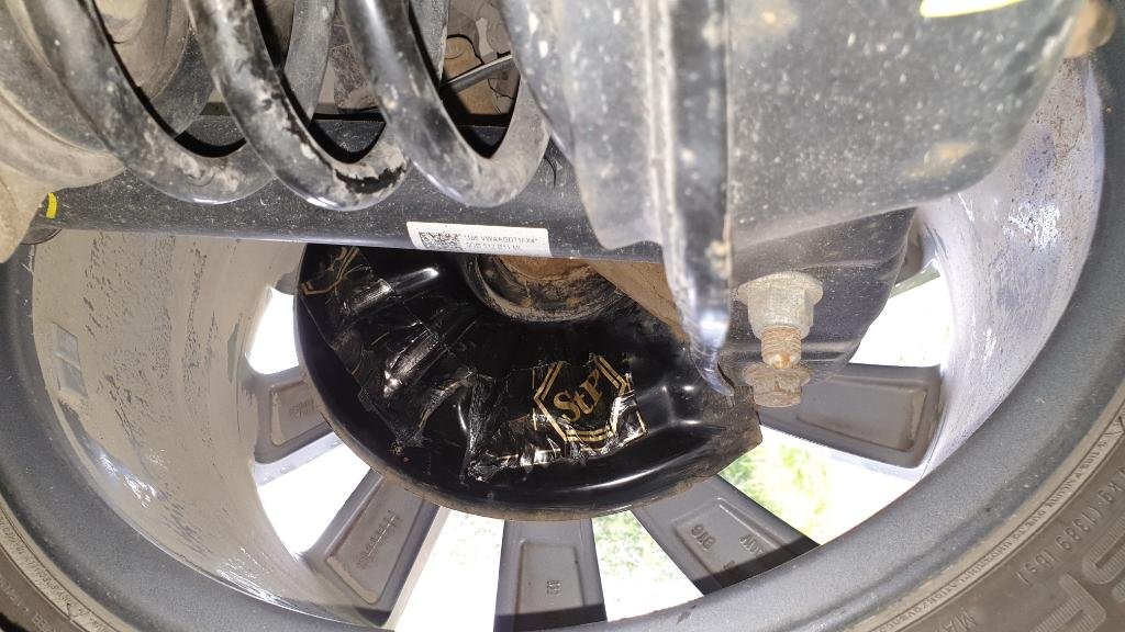

Another cause for ringing was them brake back plates, they seem to ring very easily too. Added some sound deadening on them and even less tendency for that high pitch noise!
