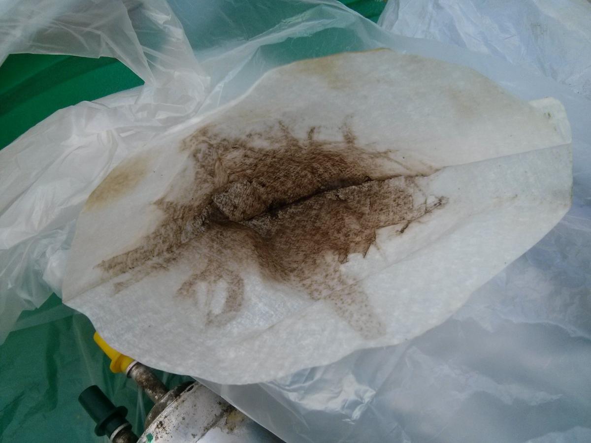

I've also just changed the fuel filter this morning and that is a nice easy 30 minute job. I'd recommend anyone with a TSI Octavia serviced by Skoda do the same now; they didn't see fit to put an interval on the petrols so you are probably still using the original filter!
The official VAG part is 1K0201051K. I'm not sure what the dealers charge but it is available on ebay for £19;
http://www.ebay.co.uk/itm/321192083475?_trksid=p2057872.m2749.l2649&ssPageName=STRK%3AMEBIDX%3AIT
Here's the gunk left on some filter paper after I drained my old fuel filter into the lawnmower. Can't waste good V-power!
