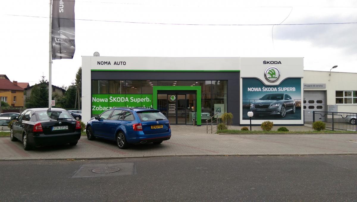

1186 miles to the dealer.. for a bearing noise check..
So had that weird wheel bearing noise looked at, at the other side of Europe as it turns out!
The dealer was very different in attitude to UK dealers I've used. They dropped everything to check the car over first thing and none of that ever so slightly snooty aire some have either!
Anyway.. on to the details.. as I know a few of us have this problem, and I'm not sure I'm 100% convinced yet.. but.. the said it was safe to drive, before showing me that the car had eaten the inside edge of the rear tyres (previously the fronts).
hey said it was this contact with the road that was generating the noise, even a roational bearing type noise, and that both this and the previous octavia we're prone to suffering badly if the suspension / wheels / tyres are not 100% perfect.
They checked the pressures and said they were bang on ( I check them regularly..) so I've drawn a bit of a blank, other than being concerned about the tracking.. although it's not eaten the two goodyears on the front yet.. What it has done though is made me slightly concerned about a chassis that can transmit so much from an IRS setup through to the bum dyno and steering wheel!
I'l update again after another 1.5k miles.. So that will be Monday then..
Should have added that itw as a combination of business and pleasure that led me to Poland, and a UK dealer is actually having the car in to repair the SD slot on the 12th! This dealership just presented itself. Cookie if you get the dealership right haha!
