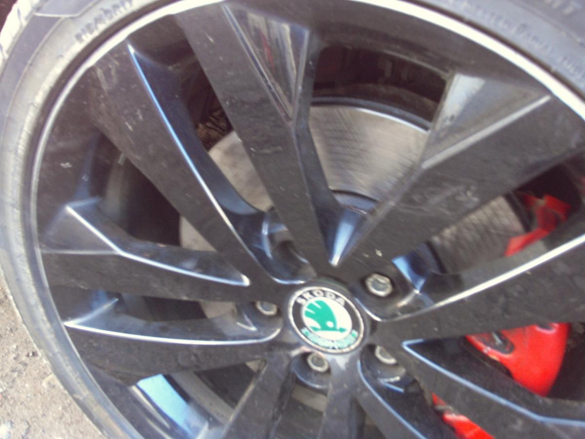

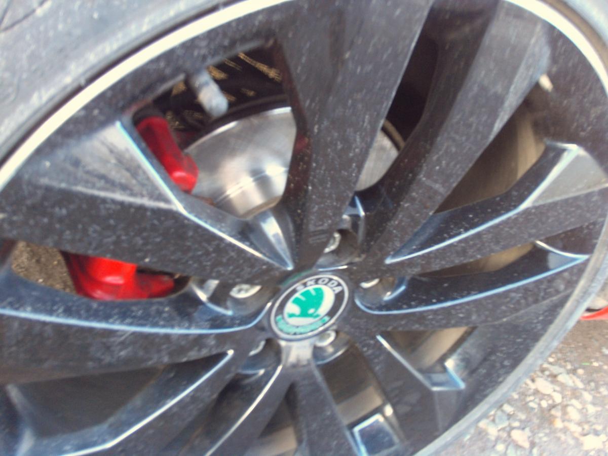

I noticed a little while ago that my n/s front brake disc has a score mark around 2/3 of the way up from the hub. I took the wheel off and the score doesn't feel deep, however I could see nothing obvious stuck on the pad, and to my knowledge there have been no unusual noises or scrapes on b raking, and performance isn't affected.
I know the next step is to swing the caliper up and remove the pads, but I'm reluctant to do this on my main car. I have done brakes on cars before, but only second cars where it's no big deal if I get stuck or it has to stay in bits for a while.
The car is due a service asap for which I use a decent MD, but I'm worried if they see it they'll jump on the issue and say it needs new discs and therefore pads both sides.
Only thing I can think of is I did almost get stuck in some mud in a car park whilst on holiday in Scotland and it was quite deep. Possibly grit or small stone got stuck in, maybe just temporarily?
Any solutions?
