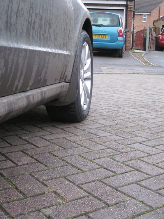

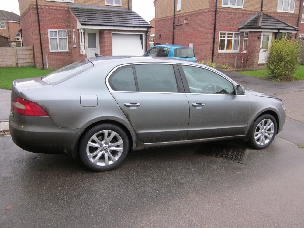

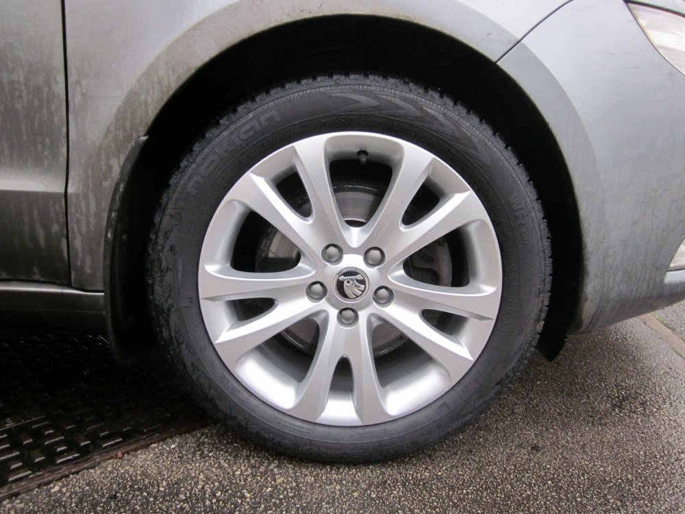

Just had the tyres fitted this morning, loving the chunky look from the higher profile.
Thanks everyone for your advice and help...

Pics with them on the car please! :D
This morning saw the first frost on the windscreen, they'll be on in a few weeks!
Im gonna order the same size for my same rims too :)
