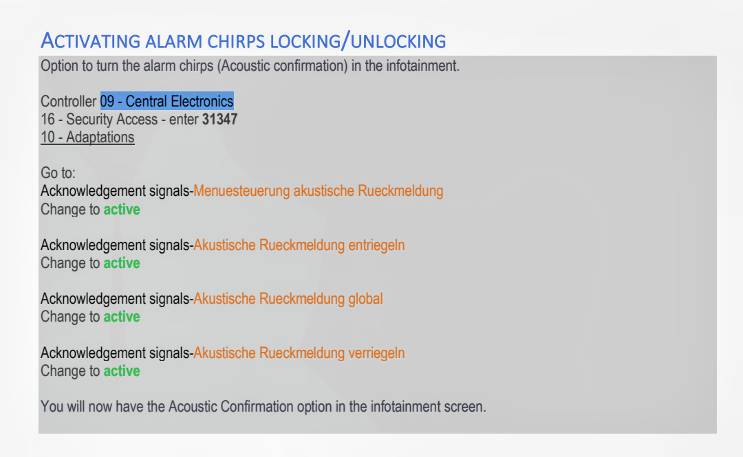

Can anyone tell me how I get the alarm chirp working on my Mk3. Despite enabling all the right options I can’t see anything in the menu and no noise when I lock/unlock the car.

I was able to enable the alarm chirps on mine with these instructions.
Some of the instructions I previously found was missing some steps.

Pretty sure I’ve lit all these options before to no avail.
Does it show immediately on the display to enable or do I need to recycle the ignition a few times?

U need to reboot the infotainment unit.....shows in the menu straightaway, and chirps.
Is reboot just a case of turning it off then back on?
hold the power button till the entire system reboots and you see the skoda logo again
Nice work, sorted now.
